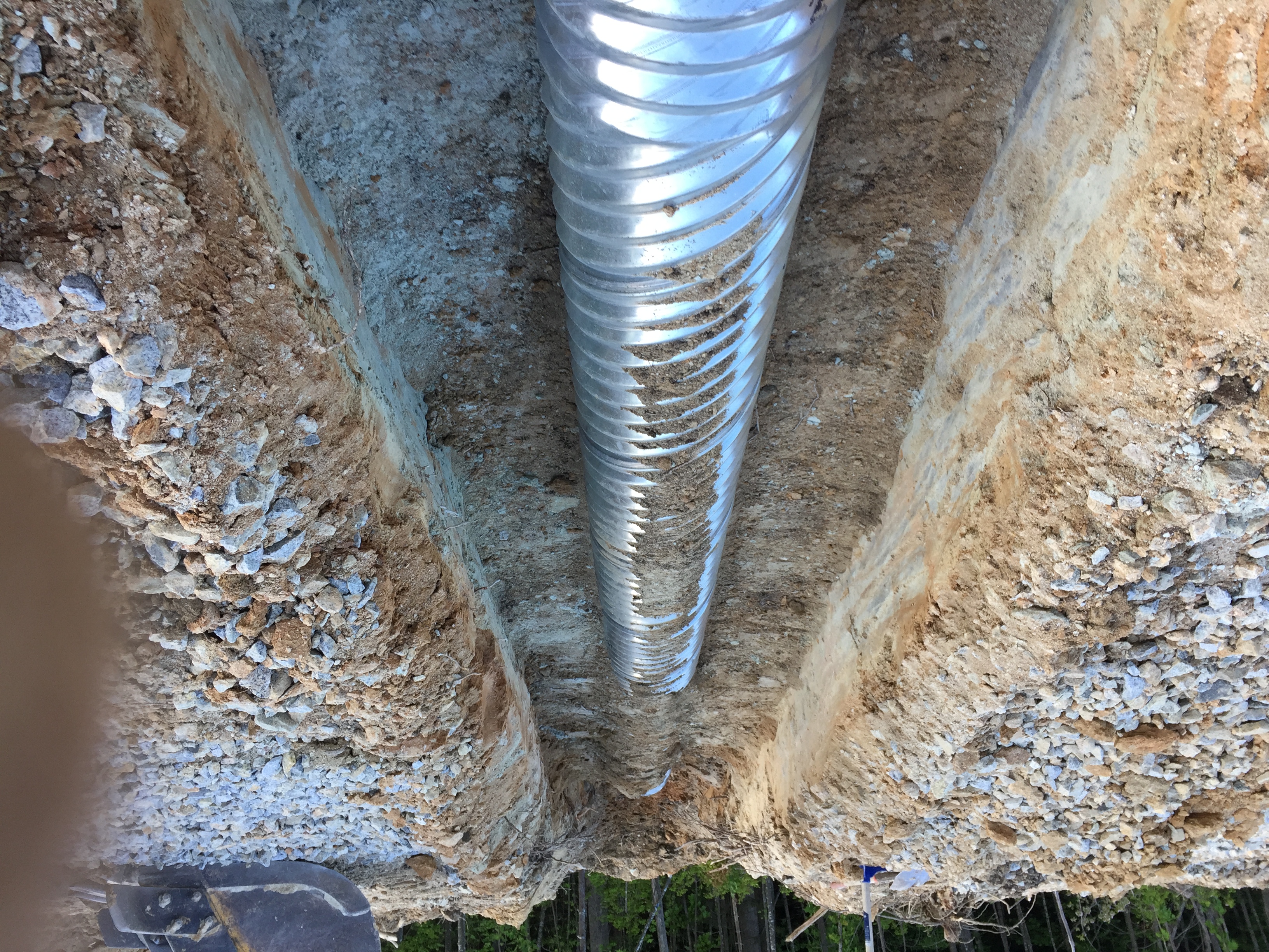

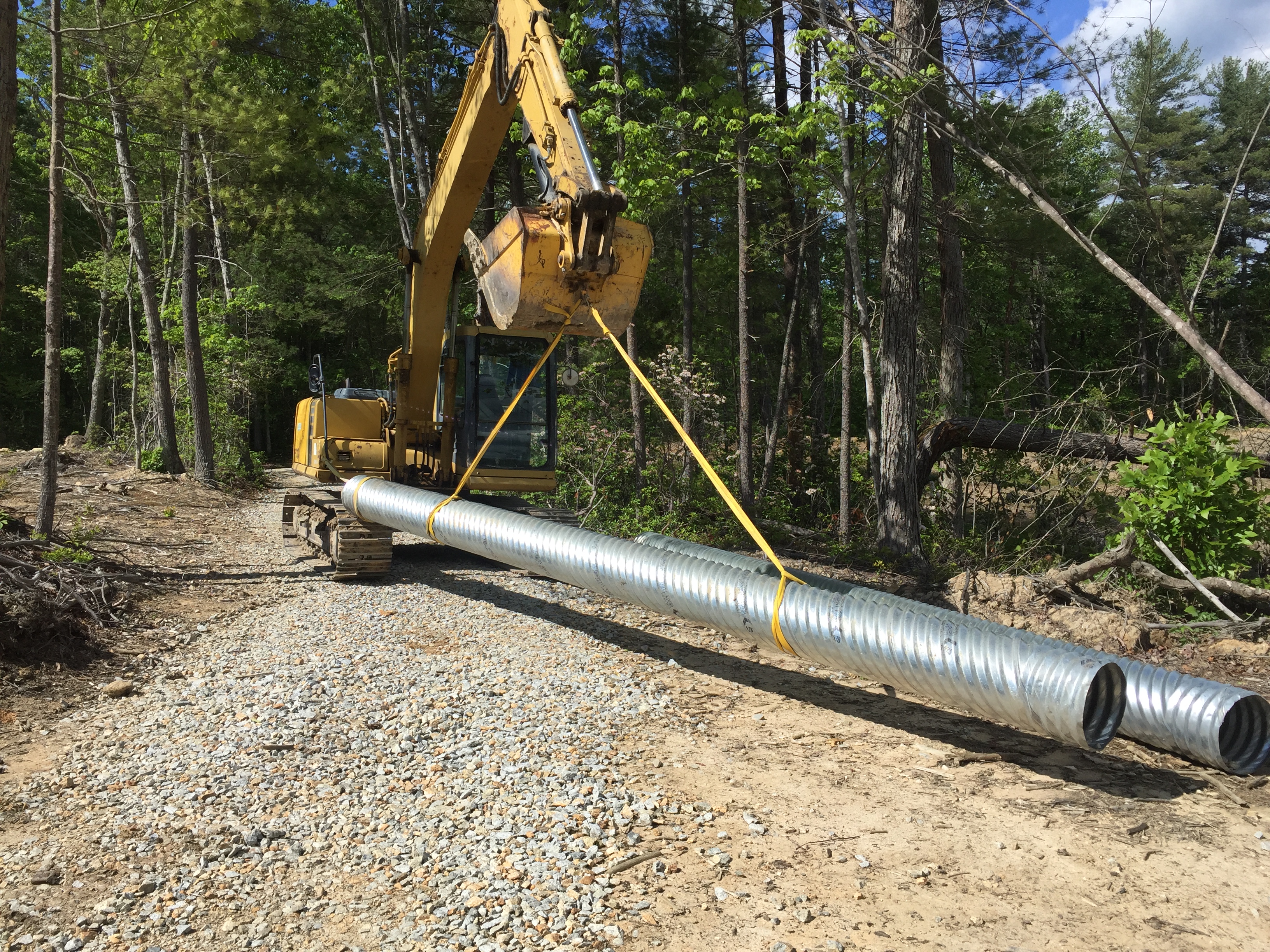

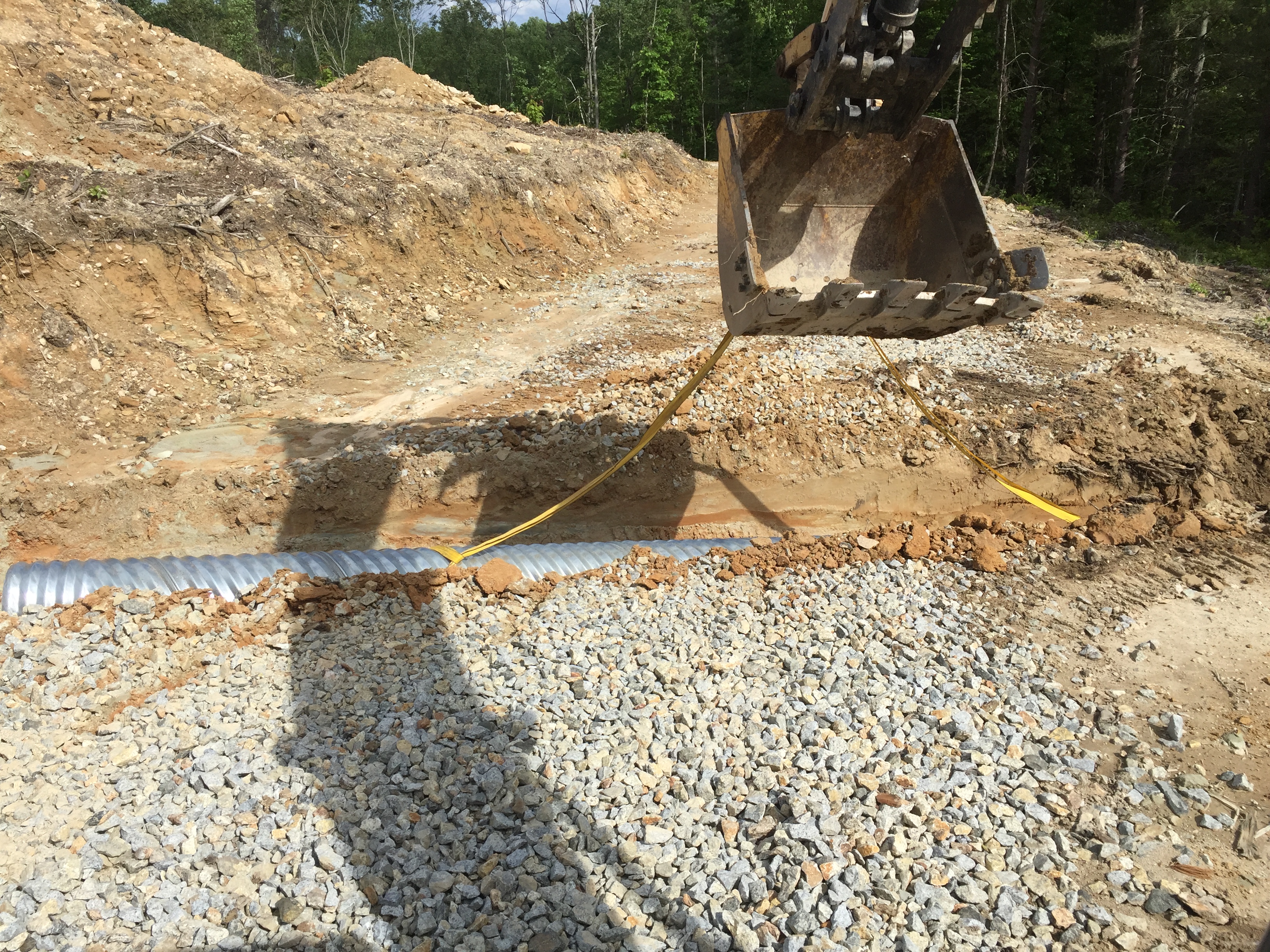

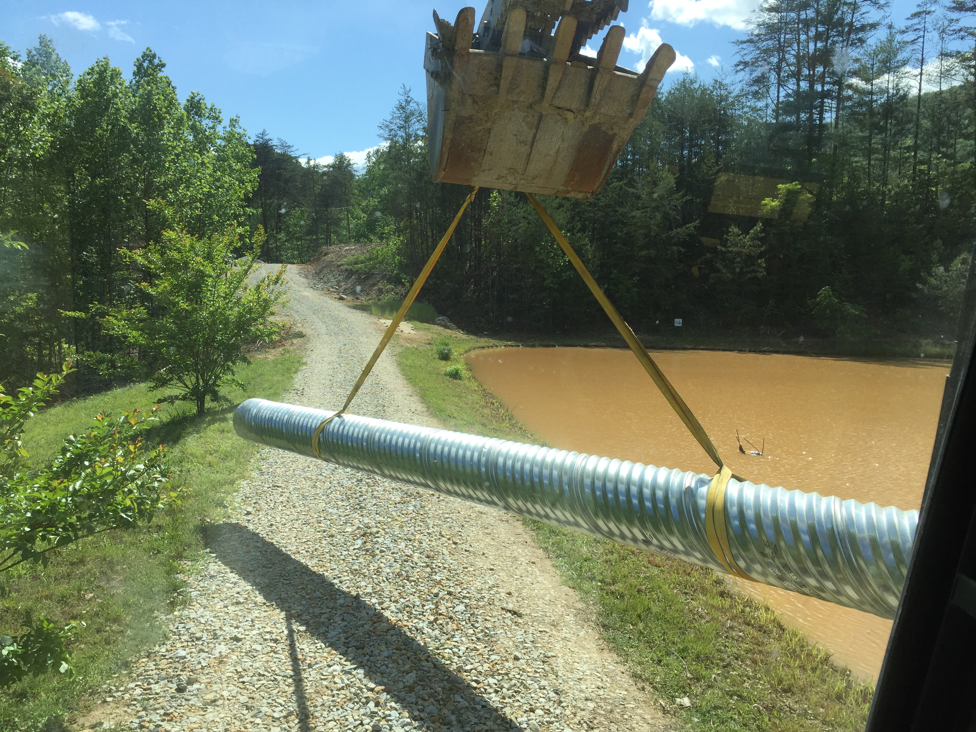

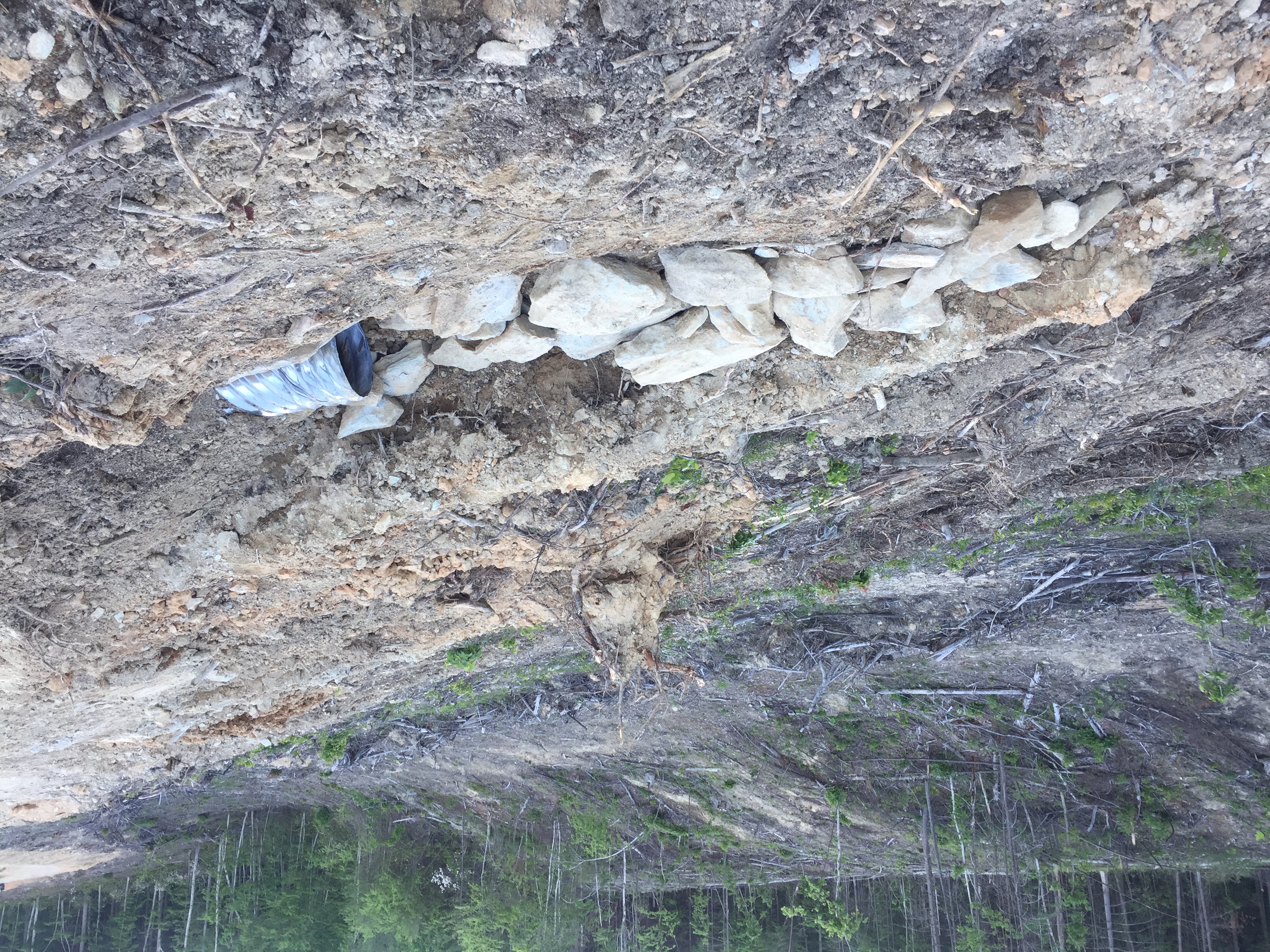

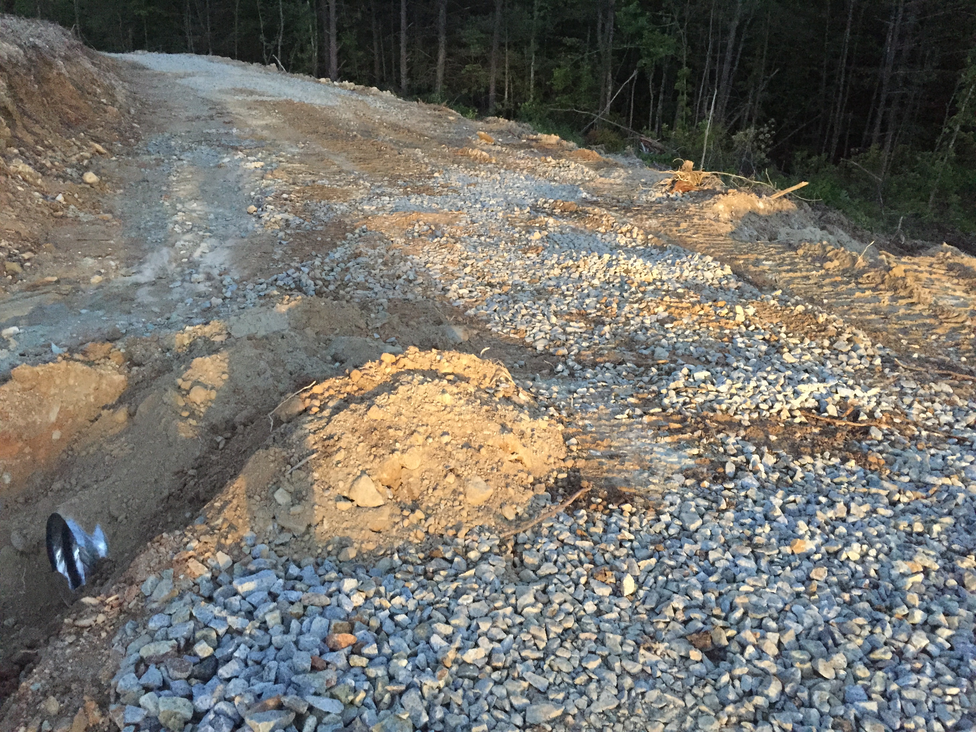

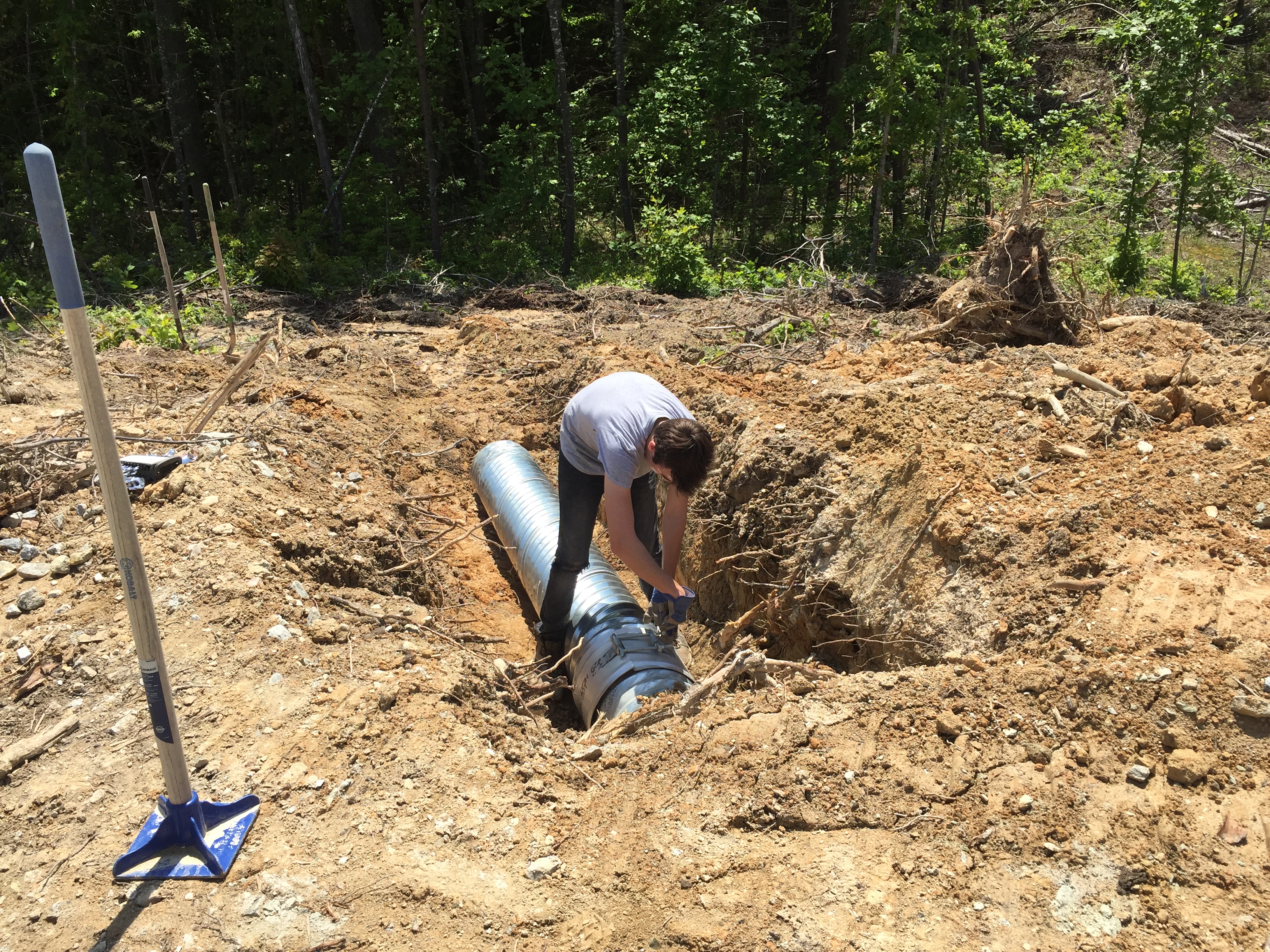

We have had some huge rain the last two weeks. Last week I got to see the good and bad aspects of my road. The ditching worked until it got to the bottom of the hill. Then it flowed across the road and washed some of the rock away....but more than that, the silt it washed out covered the rock and made it a hellish mess. So, today I put in ***. 24 foot culvert. I am going to get a union joint and another piece about 8-12 feel long and attach it. I don't want to try to get away with it the way it is, but for right now I think I'm good. IT was a ton of work and it wore me out.

Nice job make sure you compact it well sides and top. Suggest rip rap at ends to prevent washing in these monsoons we are having

Thanks Buppies. I used an 8 inch tamper and a shovel to compact and knife it in. Drove over it several times with the excavator and truck and jeep and there was no deformation . I think I 'm good there. I will probably use cement bags to shore up the entry way, and possibly some for the exit, after I get the union and extension. put on it.

I put in the 24 foot culvert and it wasn't quite long enough to satisfy me. because it had to go in at angle and decline it restricted the road to about 12 usable feet for driving. Sure, we could have made do with that. But I have two 18 year olds, a 14 year old, a wild willed wife, a 20 year old and a 27 year old....one grand child and only God knows how many more grandkids in the pipeline. So I had a union and 10 foot extension delivered. I probably could have added a 15 footer instead and it would have been fine. This time around, I had my boys there with me, so I got to hand them some shovels and tampers and shout out orders from the Excavator.
Now I need to get some grass seed down. But overall I'm happy with it.
