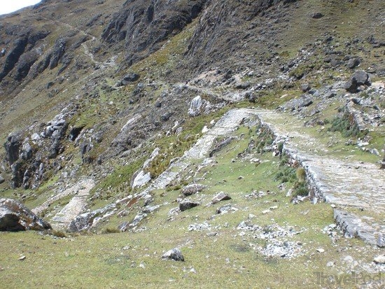

Several very old roads and a newer road with side slopes. No 4:1 side slope and wide flat ditch in these. They seem to be withstanding the ravages of time & elements.

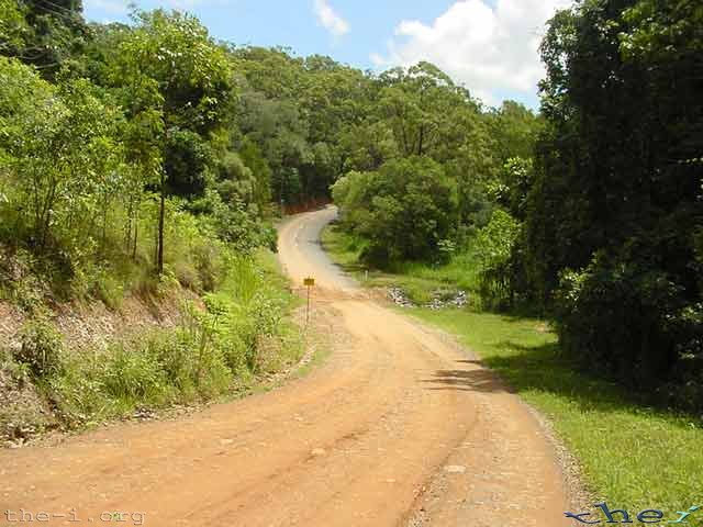

Pictures of roadways on basically flat surfaces have no relevance to what's posted in the picture by the OP.

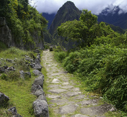

Do it properly? Let's have a description of equipment and methods used. Haven't seen that yet! All we have heard is many cubic meters of dirt to be moved but where to ?? and wide flat ditches with lots of talk about drainage but no detailed description of how to do it. Lots of water has been mentioned but the lack of drainage area seems to be missing. Ditches and drainage tend to be based on acre feet of water. Some of the oldest roads in the world have no ditch!
