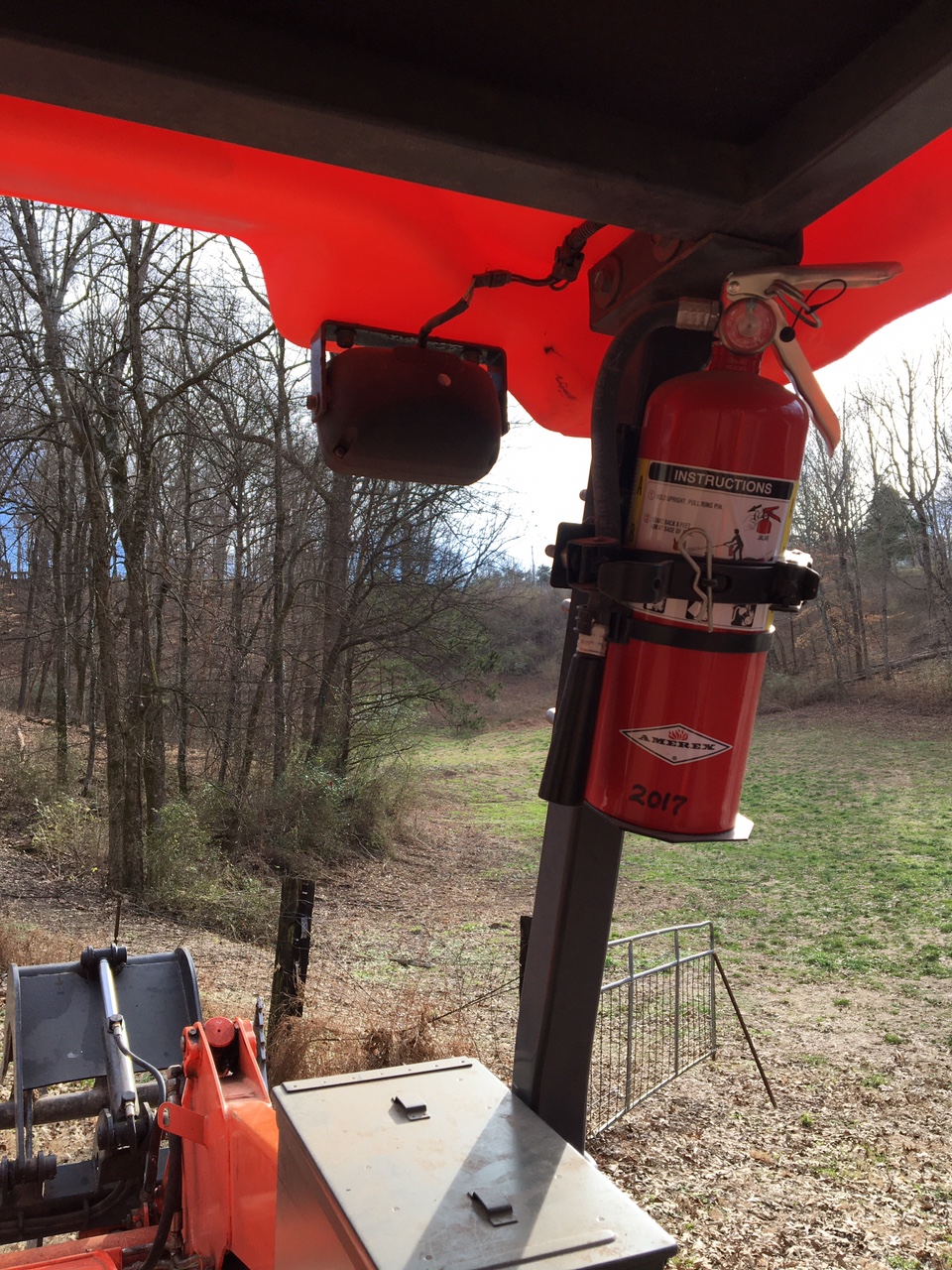

I'm looking to fasten a fire extinguisher to the tractor. What class / type should I be looking for?
thx, as always.

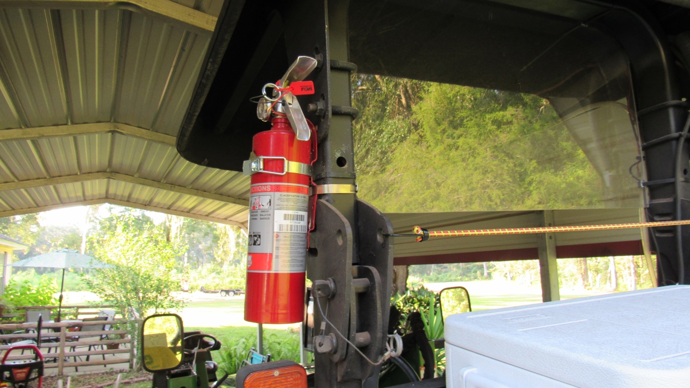

/ Fire Extinguisher #3
5# 3A40B:C
Bracket from Amazon ~$22. 2” square Ubolts required no drilling or cutting to attach to ROPS.
Glad you are thinking of safety. With all the potential hazards from fuel, heat, dust, debris, mice, burn piles, welding, remote locations better to be prepared. Military or commercially they would be required. Just make sense.
/ Fire Extinguisher #6
5lbs minimum & that doesnt go far against much of a fire. I have a 10lbs in the bed of my truck. Only a 5 on the tractor & barely have room for that. Really need to put a 2nd on or figure out somewhere to mount a 10.
A:B:C are the common ones that take all reasonable fire types. They use powder that is rather corrosive after use though. So if you do use one, you have to clean things really well & even then are likely to have rust issues on steel & corrosion on wiring. In most cases it's better than having a charred husk of a vehicle.

/ Fire Extinguisher #8
One recommendation when mounting the bracket... cut up an old or spare foam neoprene stubby-holder (koozie?) and use it as a vibration-dampening layer between the bracket and ROPS or other mounting surface.

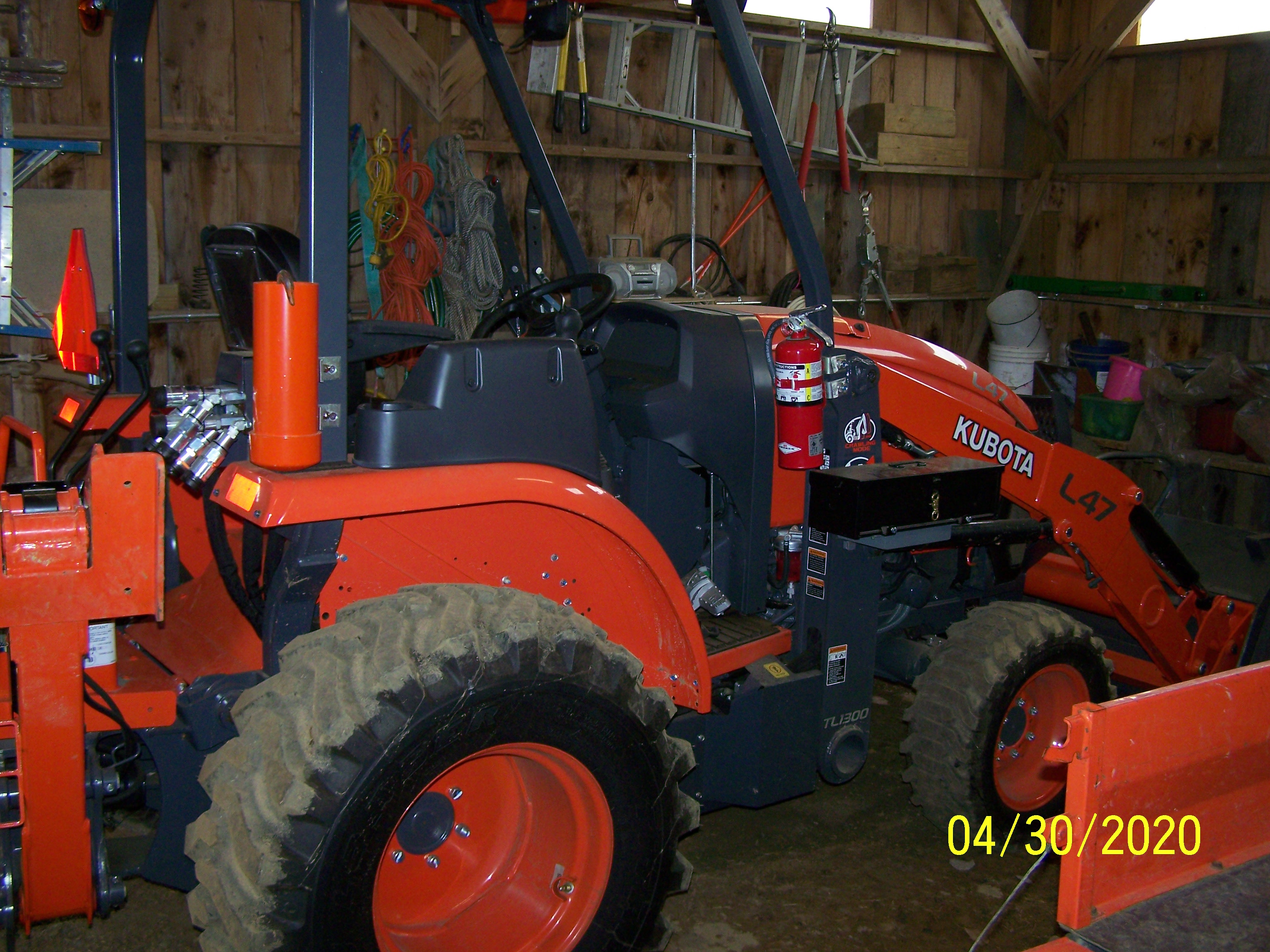

After posting a photo of my L47, a member (fried1765) asked where was my FE? I had forgotten all about it.
Here is my ABC FOPS mounted.

I have replacement value insurance coverage ($60K + for new L47 ?), but I still do have a mounted 5lb. (small) dry chemical extinguisher.
