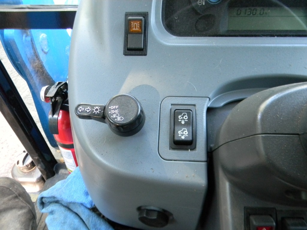

I was recently thinking what would happen if I am out on the field bushogging and my tractor (NH 3930) or bush hog were to catch on fire. The answer is it would burn up because I would have no way to put it out. It would probably be wise to get a fire extinguisher for the tractor. I could mount it on the ROPS bracket.
Does anyone have an extinguisher on their tractor? What size/type extinguisher did you get and where did you get it and how much did it cost? Where and how did you mount it to the tractor? Have you ever had to use it?

I also have an ABC in my cab. It came with a mounting bracket. Bought at local box store, don't remember the price. Never had to use it but better safe than sorry.
