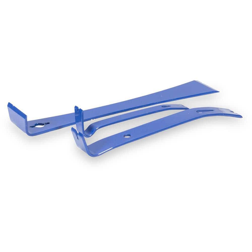

To remove the trim, I use a paint scraper/putty knife jabbed down to protect the wall as a backer and a set of thin 90degree trim bars to get started.
Yeah, I don't understand the other post about trim. A thin blade or prybar, even the type used for automotive trim gets behind the molding enough to pull it loose from the wall.

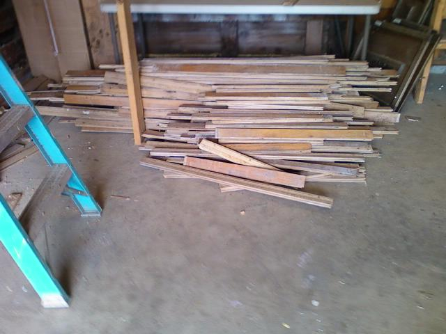

We had oak floors in our house. They were "sanded" to refinish them very poorly, before we bought the house. So I ripped them all up and installed a new bamboo floor.
Now to the point. There were several boards that were still in decent shape that I figured would be good for some projects. But there were several 100 nails still in the boards.

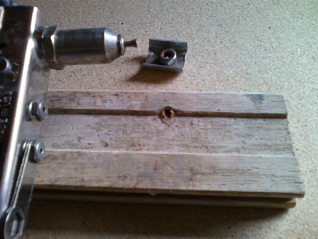

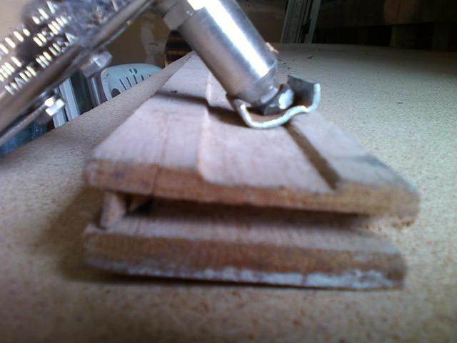

So I came up with this.
A cable tie clamp that you screw into a wall to hold phone lines, a small nut, and a rivet gun.

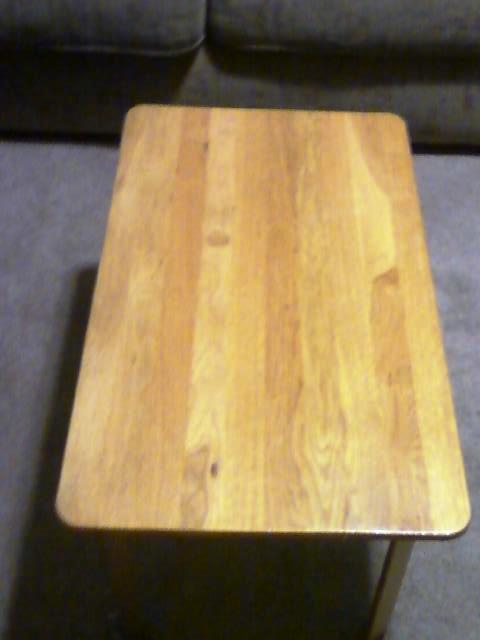

Worked like a charm! No tear out on either side.
Coffee table made from the flooring.
I also made a dining room butterfly table out of it.
