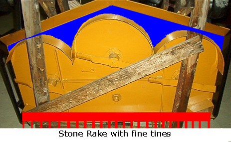

Why not plastic? Can't be made only because of stones? What if I add a small rock rake in front of finish mower that will block the rocks entering into the mower deck? It can be made like seen in attachment picture I played with. No? Only this rake (in red) is made of steel and mounted in front of completely plastic deck. With some supports in such a deck (added in plastic tooling), plastic deck too will be strong enough. Ps1: is this 17,000 fpm the speed at the tip of blade?

1) Different burn outs would be cheaper than trying to alter a stamping to fit different sizes. Additionally, once you split the stamping to narrow it, you're back to welding anyway. You'd also most likely have problems with hole locations and many other fit and finish problems.
2) There are a lot more issues with using plastic in addition to containing projectiles. There are the forces that each spindle and the gear box place on the deck. Decks where the metal is torn or cracked at a spindle seems quite frequent. Plastic would be at a big disadvantage here. Overall rigidity of the deck would be an issue unless you either had a very thick cross section or lots of molded ribs.(The more complex it is the $ it becomes) After all the deck is a major structural member of the mower. Impacts from stationary objects would most likely end the life of the deck quickly. We've already heard from at least one user who has hit stuff a few times. Then there are the affects of the environment on the plastic. What's going to prevent your rake from folding back under the deck or simply pushing itself up over the debris? Chances are you'd either let the debris in or fracture the front edge of the deck and now your rake is in the blades. There are many more that I could point out. There are plastics available that might be able to handle some of these issues, but very few if any that could handle all of them. There simply isn't a plastic yet that can replace steel, especially in bang for the buck, when it comes to equipment like this.

Idea of stamped deck with changeable size and plastic deck was only raw idea that should be thought about them more. So, lets pass these two idea for the moment.
The idea of this fine tine rake now sounds easily applicable after a little further study. Don't you think such a rake will not perform well? You fear its tines can be broken and go into blade area? Well, then, I make the rake tines made of plastic. Anyways, the rocks in a field where a finish mower will operate will be small size rocks. You know the road brush tines (small diameter plastic tines/pipes) - they can do the work. If these plastic tines are broken, and enters the blade area, then it won't be a problem for the blade - it will cut them too.
Ps: Once this problem of rock entering the blade area is solved, then we can go further to talk about the plastic deck (maybe, "semi-plastic".) but this plastic deck requires more study.

Actually, with a plastic deck I was more concerned with the entire front lip of the deck + the entire rake ending up in the blades.
</font><font color="blue" class="small">( Anyways, the rocks in a field where a finish mower will operate will be small size rocks )</font>
1) Not necessarily
2) Small rocks make wicked projectiles and could easily pierce a plastic deck
3) I've seen too many people cross gravel drives with the mower at cutting height while it's running.
</font><font color="blue" class="small">( You know the road brush tines (small diameter plastic tines/pipes) - they can do the work )</font>
Take a shop broom and just push it around. Notice all the debris that you leave behind, particularly small heavy objects. Now use the broom correctly and notice that it doesn't happen. That's why large brush or brooms counter rotate, if they didn't they would accomplish much. Not to mention the aforementioned users who cross gravel drives. They would drag stone into the yard, thus resulting in them remove said brush or rake.
Like we've stated in previous threads, with liability laws, even if you had such a device you couldn't 100% guarantee that debris wouldn't get into the deck and it would only take 1 incident to put you out of business.
