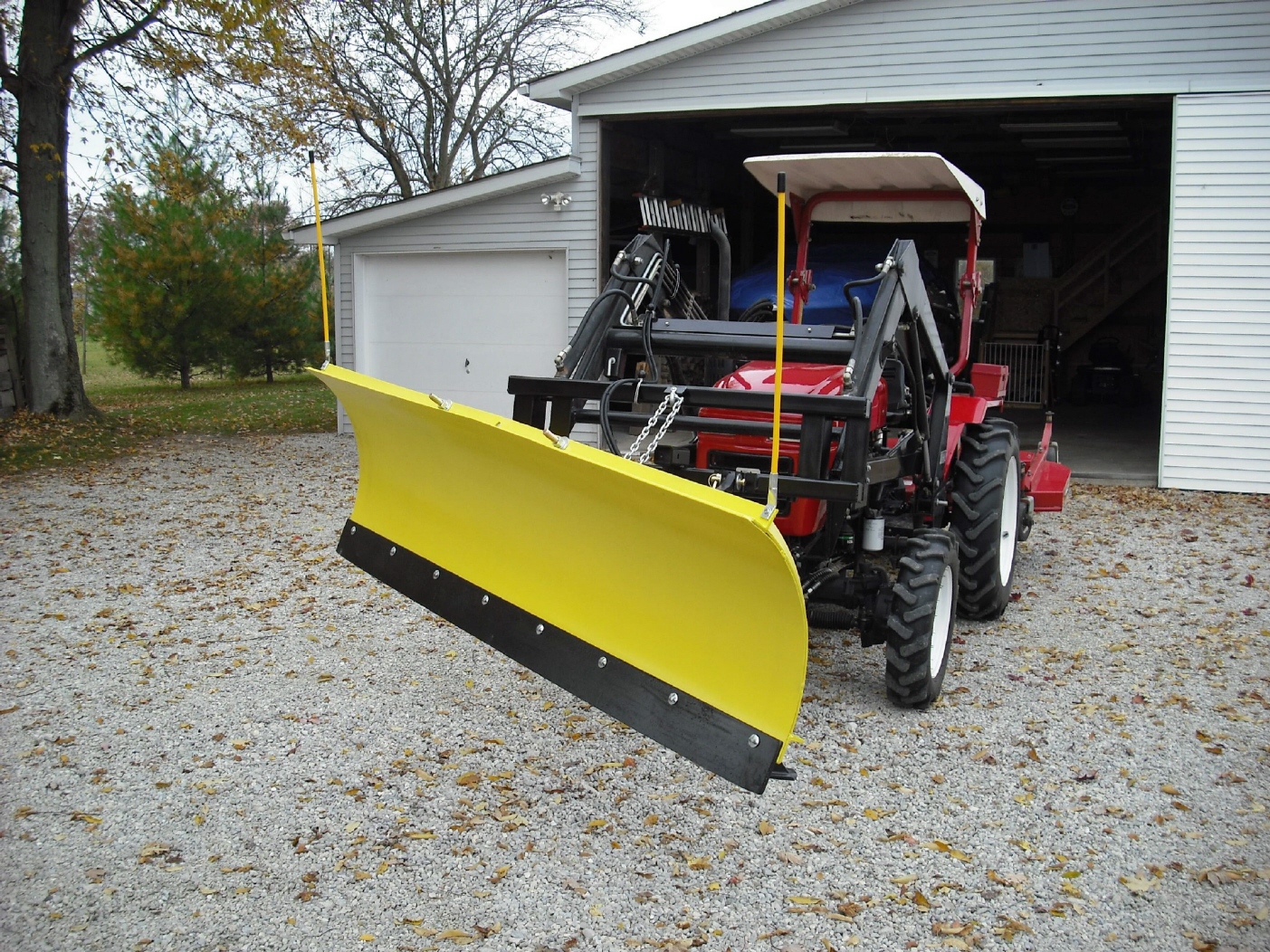

I run a 6' Caroni rear discharge and its top notch. I have no problems with it behind my Jinma 254. I had a piece of junk 5' King Kutter side discharge to start and and I should have traded it for a Yellow Dog then shot the dog.
Spend a few extra $$ in this area. Get rear discharge, solid tires, and one with as few moving parts as possible. My Caroni has 1/3 the part as the KK did so less to fail.
You can just see it in the pic below. With my wheels set at wide stance the 6' mower is just perfect.
Chris
