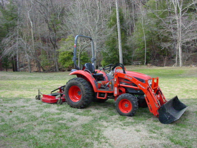

Came across a new (used) 6' finish mower today. 18 months with the tractor and still a lot to learn. How do I use this thing? I do know the basics but don't know how fast to pull it or how high rpm's. Can I turn with it on the ground or does it need to be off the ground? 84 hours on this tractor and have not tore it up yet.

Well, you've identified it correctly ...a finish mower. Presumably it's connected to your PTO, so to use it your RPMs should nominally be set at 540rpm. It should be adjusted for height of cut by moving spacers on wheel shanks above or below their respective "receivers" ...don't scalp the lawn ...and, presumably it has an "anti-scalp" roller on the front?
As for turning when mowing normally, sure, turn w. mower on ground ...but don't turn too sharply or you can easily unseat the tires from the rims and, incidentally, the tires should be checked and filled each time you mow ...probably 50-60 psi, whatever is max pressure on the tire.
The exception to the mower-on-the-ground rule is never, never back up with the mower on the ground ...because of the caster on the wheels, this puts strong, undesirable forces on the wheels and is probably the best way to roll the tire off the bead, which is highly undesireable (been there, done that ...learn how to put a cinch-strap around the tire to re-inflate/re-seat). Flat tires are a pain and if you have thorns, nails, etc. you might want to put flat proofing goop in the tires ...after the first few flats.
Presumably the top link (and, for that matter, the side links) on the mower swing, so that the mower can be compliant with uneven terrain (within limits). Mowers can eject deadly things at high speed so know who/what is in the discharge path.
When turning, note that the mower in the rear describes a broader arc than the rear wheels (just like your loader does in the front).
One other thing: if you mow down steep slopes 4wd is a must ...when you lower the mower to cut, it takes that counterbalancing rear weight off the rear tires, and can unload them enough so they have no traction ...and you have no braking, engine-wise or otherwise unless you are in 4wd (been there, done that ...a "Nantucket sleigh ride" ...it is counter-intuitive, but if you find yourself in this position, RAISE the mower)
Yet one other caution: when the mower is raised and engaged (i.e., turning, say, when you are backing up or turning sharply) you don't want it too high so that the PTO shaft angle is too severe because universal joints don't like this much.

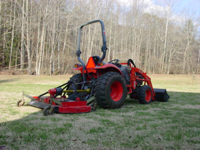

Thanks for all of the replies. When the grass does grow and it won't be long this thing will be put to the test. I am amazed at how much work (fun) you can do with a tractor. George

Right now is a great time to sharpen those blades. Remember this is a finish mower and the idea is to cut the grass not beat it to death. Too many folks think of these machines as brush hogs and ignore sharpening the blades. I try to sharpen mine at least twice during the summer. The leading edges of the blades do a ton of work. Overcoming dull blades with horsepower is the same as sewing with a dull needle and using pliers!
/ Finish Mower #8
While your sharpening blades, there are several other things you can also do. Grease the blade spindles, caster spindles that the wheels ride on, and the wheel bearings themselves. Also check belt tension and gearbox oil for correct level and no water. I like my RFM, saves a lot of time. And if you don't have a front roller, and your yard is not flat or level, they are money well spent.

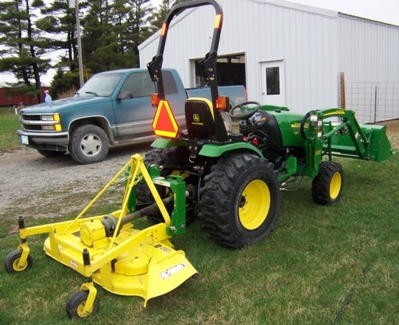

The JD 272 is all there. Here is a pic of a guy's 262 from this site.
In some ways, I'd like to have a RFM like that because it puts more weight on the rear of the tractor (half the weight of the mower, at least) which would be helpful for traction purposes. On the other hand, you are relying totally on that one little anti-scalp roller in the middle instead of on all four corners like you would have on a regular RFM.

No, according to that John Deere link, the iMatch/AutoHitch is required to compensate for the otherwise missing front gauge wheels. Your photo link shows the 262 (261 maybe?) is attached to an iMatch, and - presumably - the AutoHitch.
Prosperity's profile says he has a JD2520. The website link I provided suggests the 272 mower is not compatible with the 2520. So does this one: Attachments for John Deere equipment
