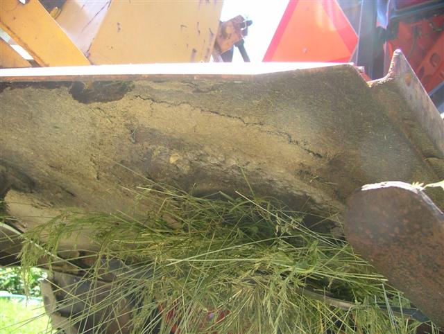

After a very rainy spring and then spending a few weeks out of town, I found my fields were some what over grown. Not to worry, I just upgraded from my B-6000 to my L-3710. The woods RM-59-1 ( I think) would handle the job just as it did in the past. I just needed to replace the blades due to the difference in PTO rotation direction. With the added PTO HP of the 3710, this should be a piece of cake! Or so I thought.
The first pass I noticed the new belt I just installed was smoking. So I stopped. Found the grass was wrapping around the spindles. So I got out my knife and cut it lose. Figured it was just a fluke, when my B-6000 got in grass to high, it just bogged down. So I went at it again, throttle up to PTO speed and here we go....... Same thing, but now it threw the belt. See attachment.
Houston, we have a problem.....
It seems with the added HP the engine does not bog, but the deck just slips, stops cutting and then just wraps itself to death. This is not good.

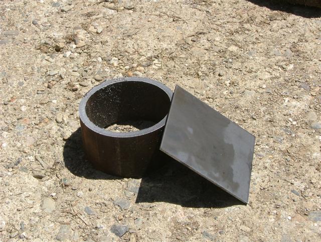

So I call my local Wood's dealer and ask if there are some type cups or guards for the spindles, they tell me NO.
So I run out to my local steel supplier and get 3 pieces of schedule 80 pipe and 3 pieces of 1/8 steel plate and go at it.

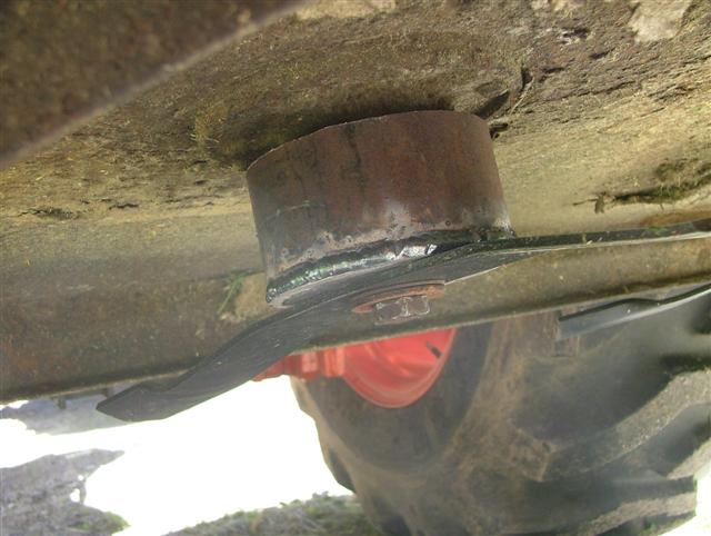

   / Finish Mower Mods
A little welding, cutting, welding, grinding.... problem solved. Worked like a charm!!!!!

Nice job! /forums/images/graemlins/cool.gif
   / Finish Mower Mods #5
Gary , Great job! good fix for a repeating headache..You must not have a bushog /forums/images/graemlins/grin.gif
Did you sharpen blades while you had them off?... /forums/images/graemlins/wink.gif
   / Finish Mower Mods #6
Good idea.... /forums/images/graemlins/grin.gif
Does spinning that cup cause any excess vibration while mowing?
   / Finish Mower Mods
<font color="blue"> You must not have a bushog </font>
No, but after throwing the belt I was ready to go get one! This was a lot cheaper!
   / Finish Mower Mods
<font color="blue">Does spinning that cup cause any excess vibration while mowing? </font>
I was worried about that when I started. I was very careful to make sure the cup was centered and as ballanced as I could make it. To my surprise, no vibrations. I think the spinning mass is so close to the center of rotation a little bit of unballance is not t big deal. Got lucky /forums/images/graemlins/cool.gif
