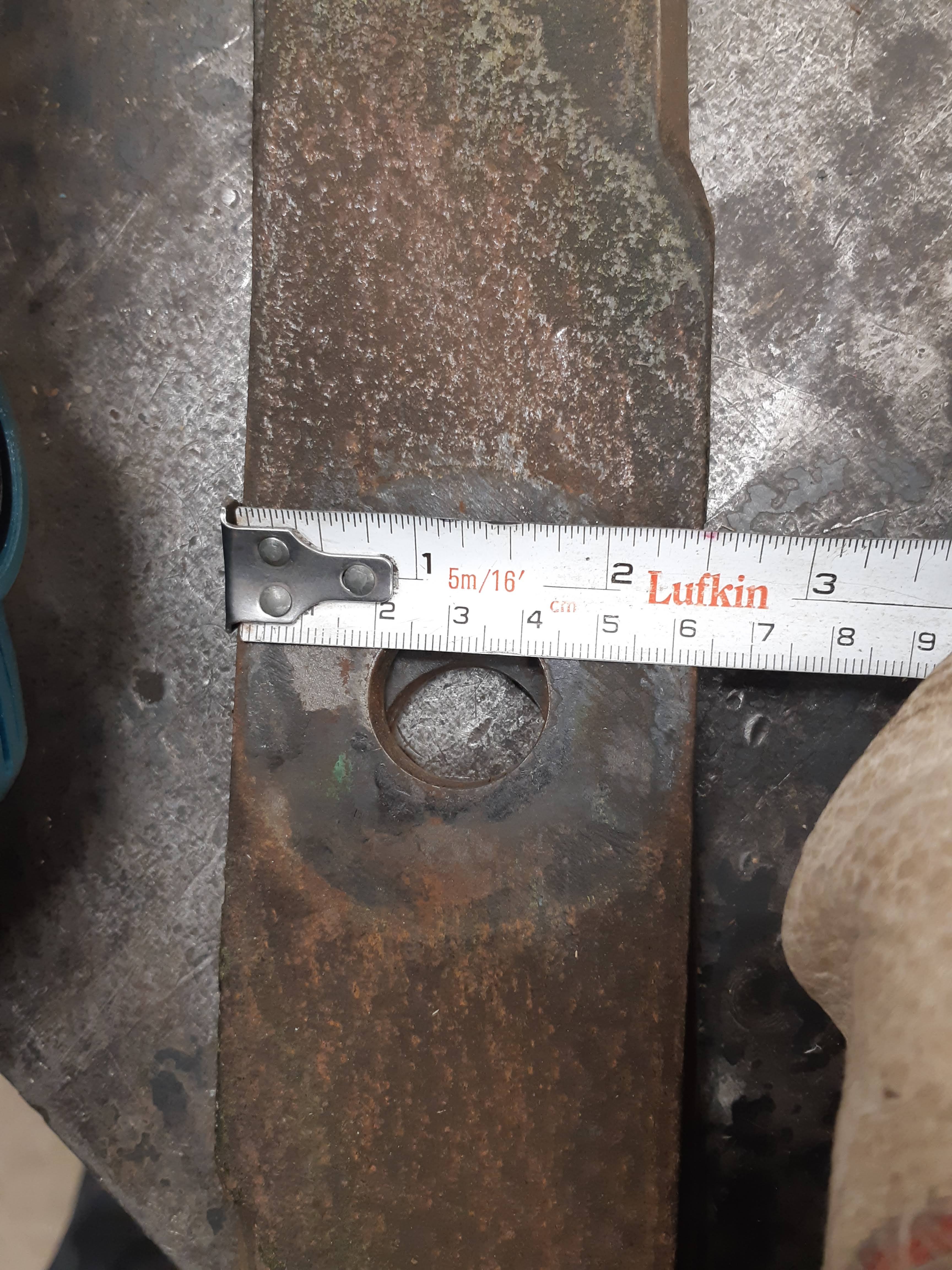

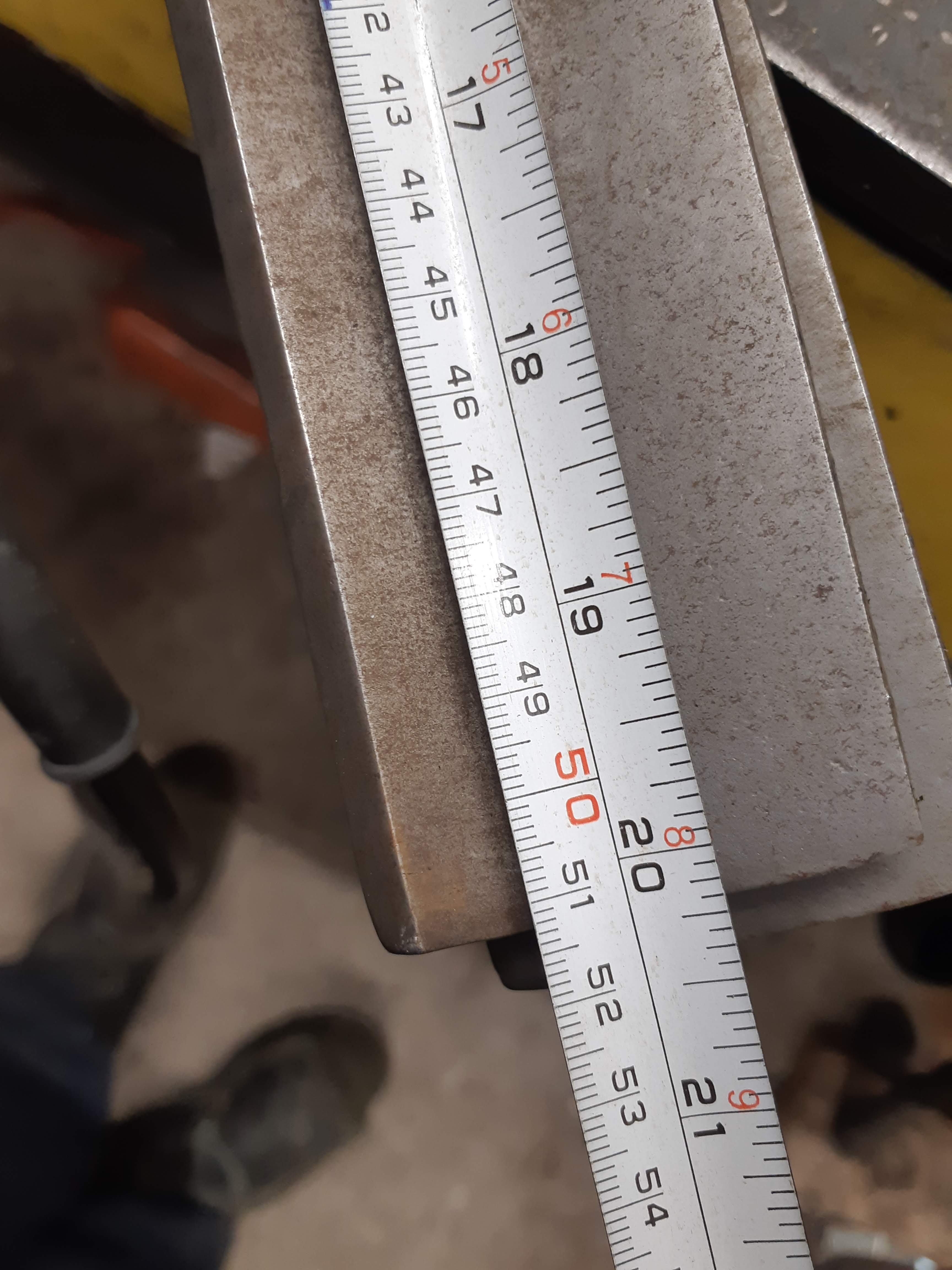

Hi
I need to change my mower blades and the dealer seem to only sell gold plated blades.
Anyone know some jobbers blade to replace PN AUB164210 or AUB162122.
Both are listed to fit on my Case MWX60R mower (same as NH 914A ).
I cant find any interchange for them.
Who build the mower for CNH?
Dimensions:
Length: 20.5''
Bore: 0.907''
Blade is flat all the way
