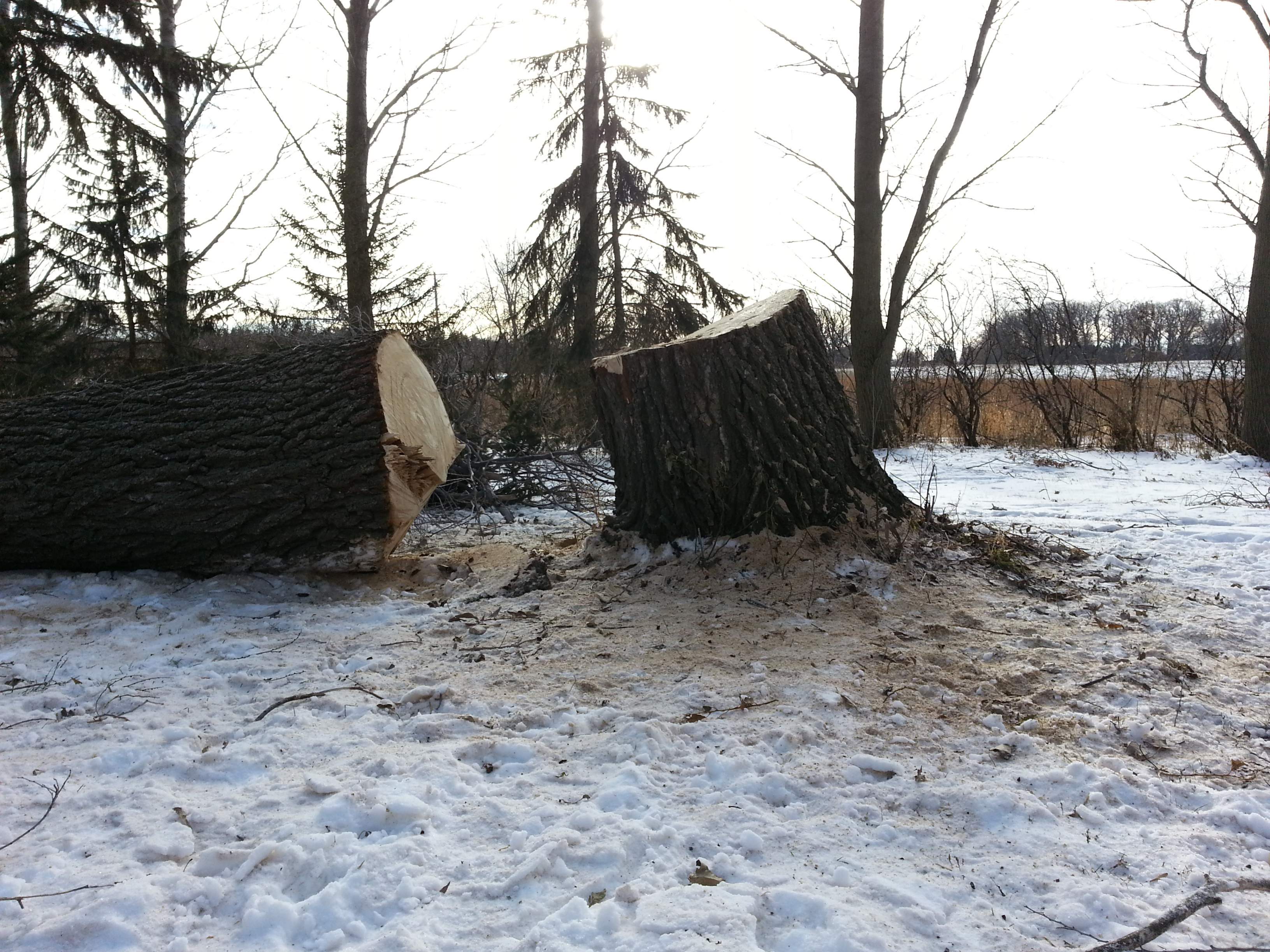

Just curious, but why is the hinge only 1/2 way across? Were you trying to spin the tree on the stump when it fell or was this from making 2 wedge cuts because tree was so wide and the backcut cut went through the wedge of one of them? Still plenty of holding wood either way.

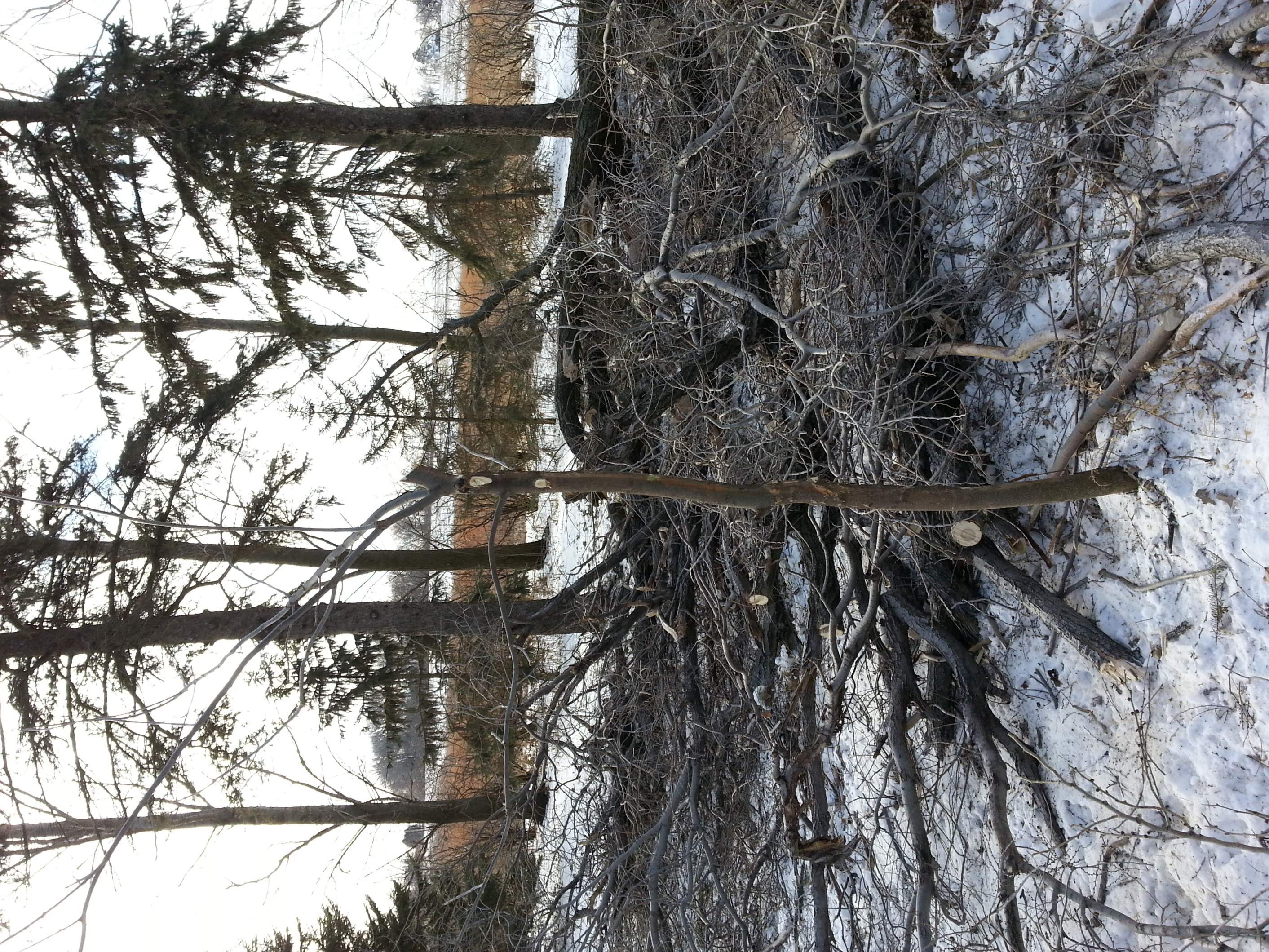

Little of both. It was so thick I had to double cut the wedge but also wanted it to spin so I missed a young tree. Which I half failed the tree smoked the baby tree but didn't hit it with the big limbs so the tree will heal. As you can see from the pics. Also attached one showing how much lean it had so the spin only did so much. Also felling big trees I'm not as good at as I like because its rare for me to drop stuff of this size. I'm sure I cut the wedge wrong but it kind of worked. Haha

Lol, i see what you mean about that poor little tree. That stump looked like your tree had a lot of lean to it!
