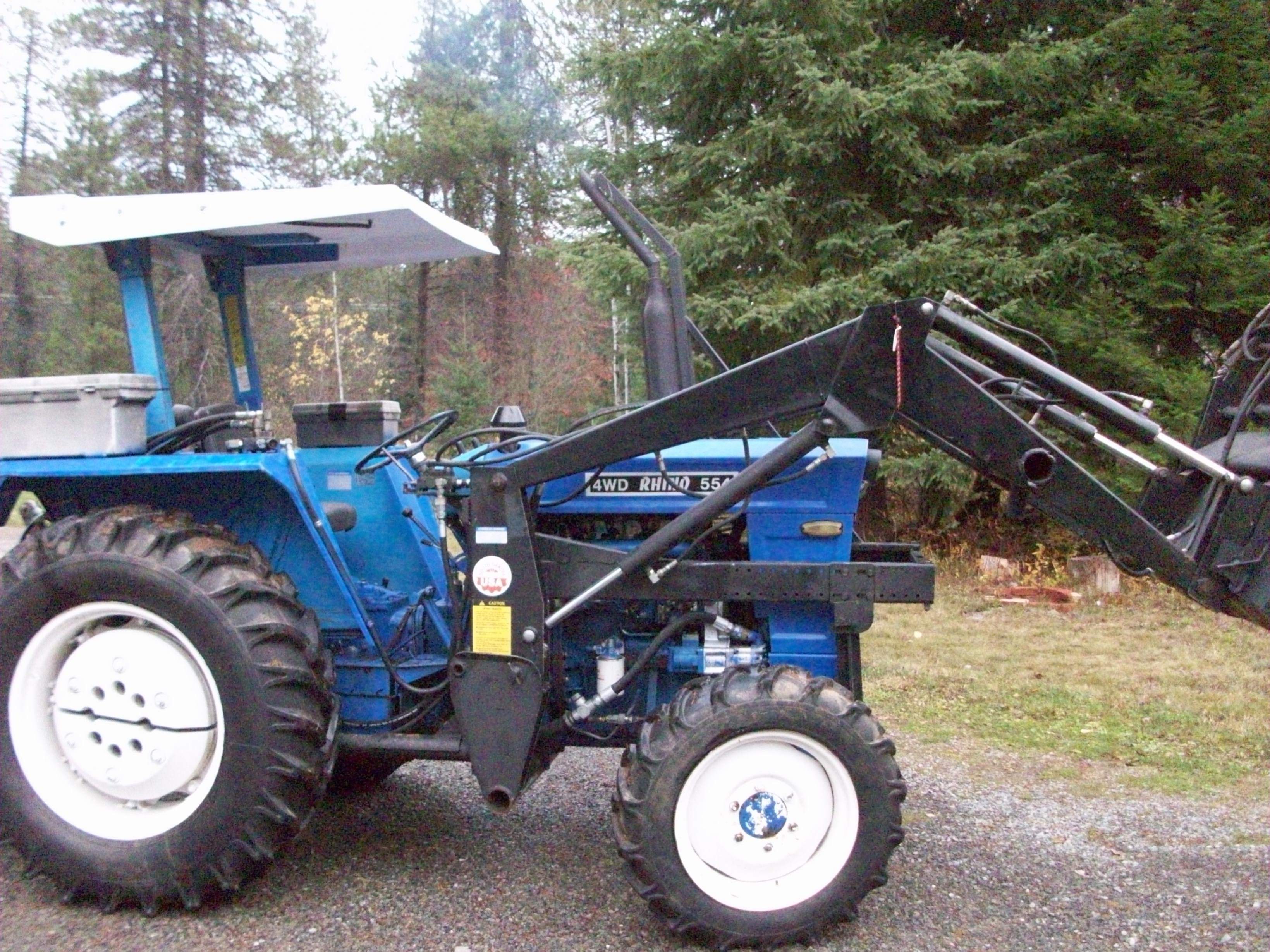

Anyway the tractor has always smoked (unburned diesel) till she warms up, and then there is still a little smoke ... So here we go time to find the cause and hopefully fix it without spending a bunch of money...

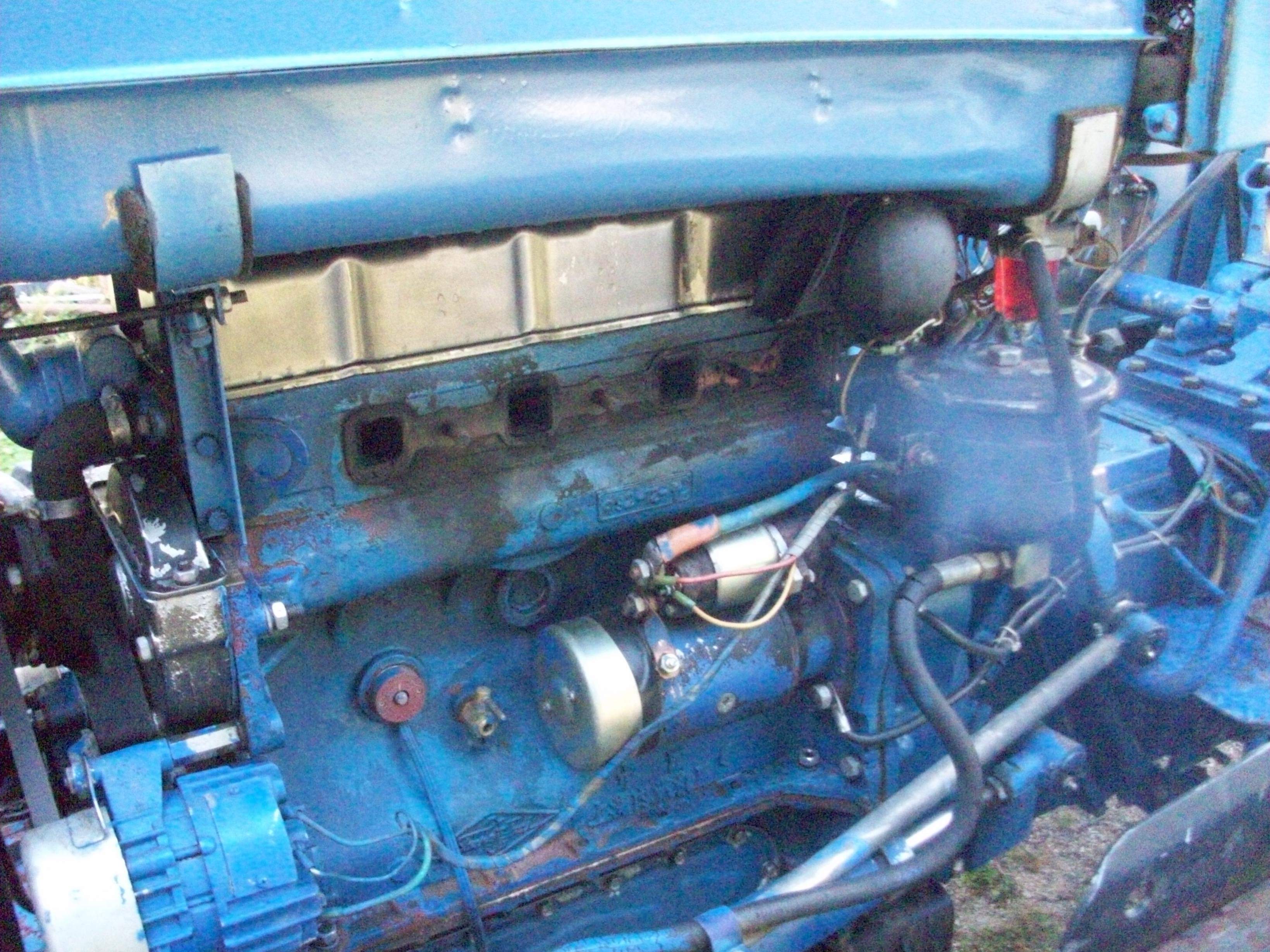

Here's a picture of it running after 10 minutes from a cold startup clean tractors 002.jpg
and after removing the exhaust manifold and starting the engine the smoke is only coming from cylinder 4. as seen here 100_7561.jpg

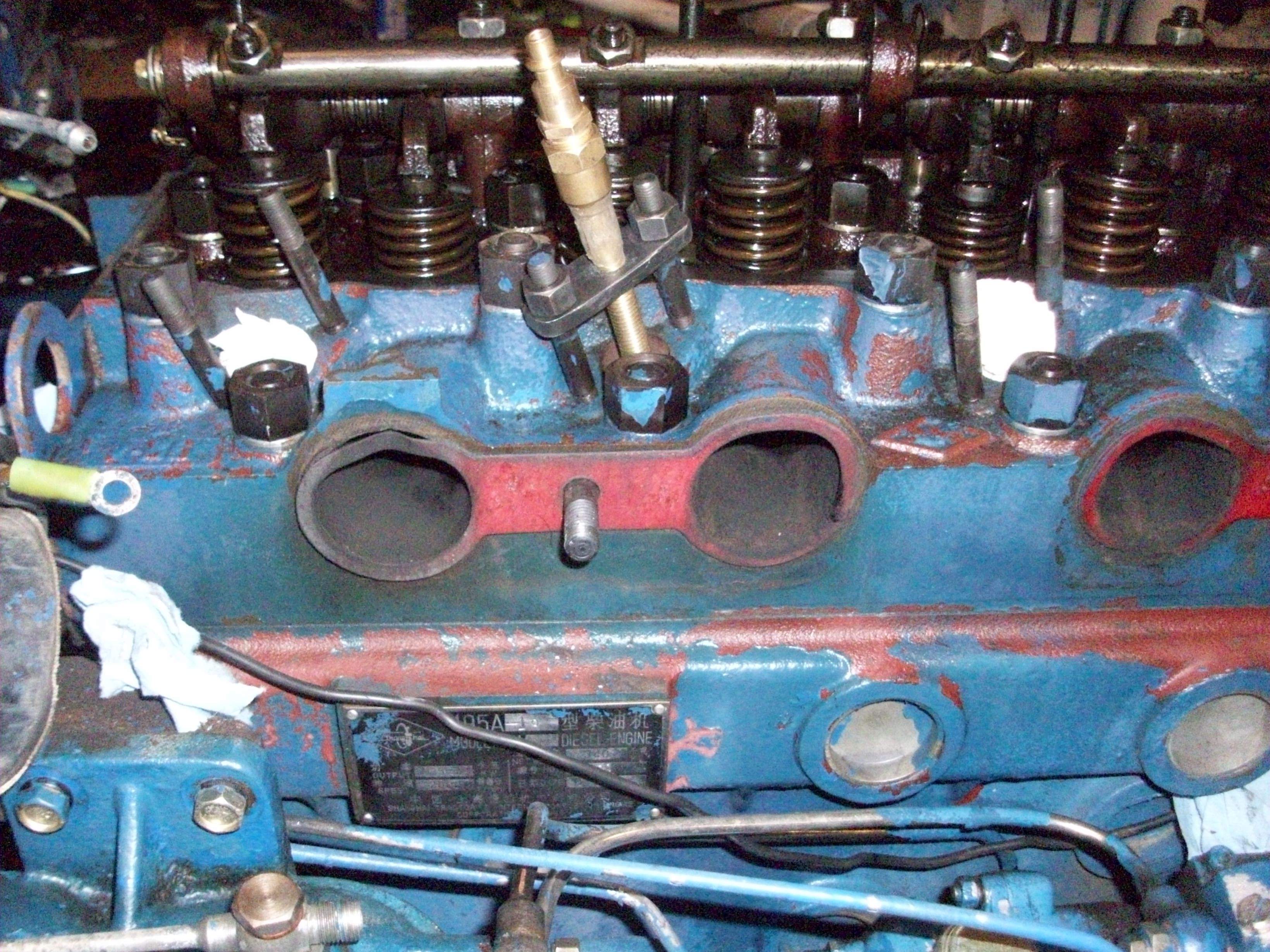

So got out the diesel compression tester and - after modifying one of the injector adapters to fit got these #s
1) 33o# psi
2) 330# psi
3) 360# psi
4) 280# psi
dug out my next HF tool (leak down tester) and found that # 4 did have a considerable increase in leakage into the crankcase compared with the other cylinders... @ 25psi 1,2,3 were all under 3% #4 was over 40%
all leakage seemed to be getting by the rings no discernible sound in the intake or exhaust ports.
Here is what may have caused part of the problem... 100_7582.jpg GRRRRR gasket...

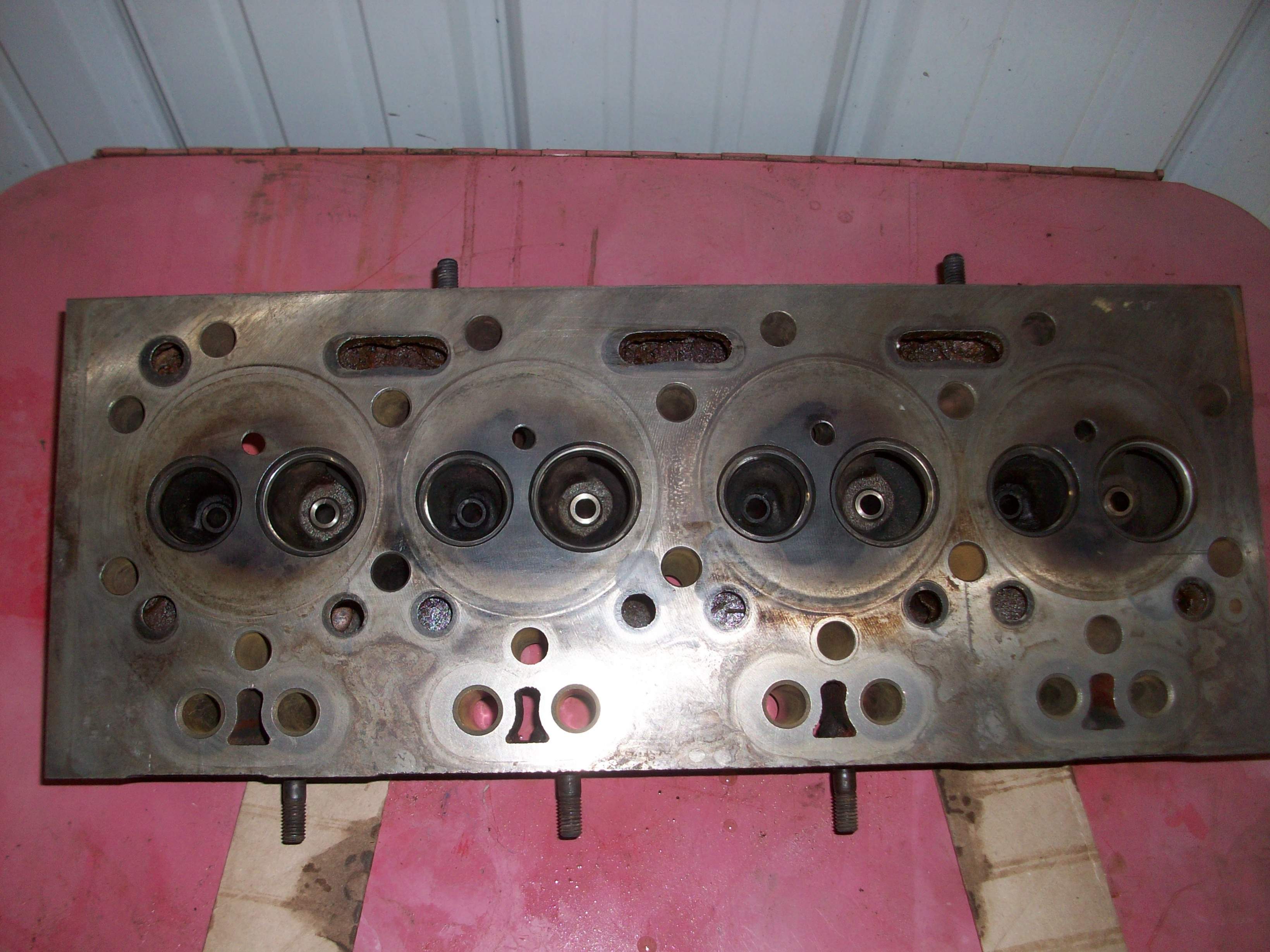

after thinking about the amount of compression loss , i pulled the head apart and after a good cleaning it seems the greatest wear is the intake valves, as seen here 100_7597.jpg:eek: so already have 4 new intake valves on the way, and at a price of $11 each i am not complaining:).
Here's the head -the seats will get a retouch- 100_7607.jpg and also have the exhaust valves touched up to. Now to find a new out fit or friend with the equipment to do the job- the guy that used to do it quit the shop (used to build some very fast race engines) and I trusted his work, ( also very reasonable prices) so i am searching now to find a new machine shop :confused:
a couple other things- checked the head and block for true, and everything is flat to less than .0015, so happy with that.
