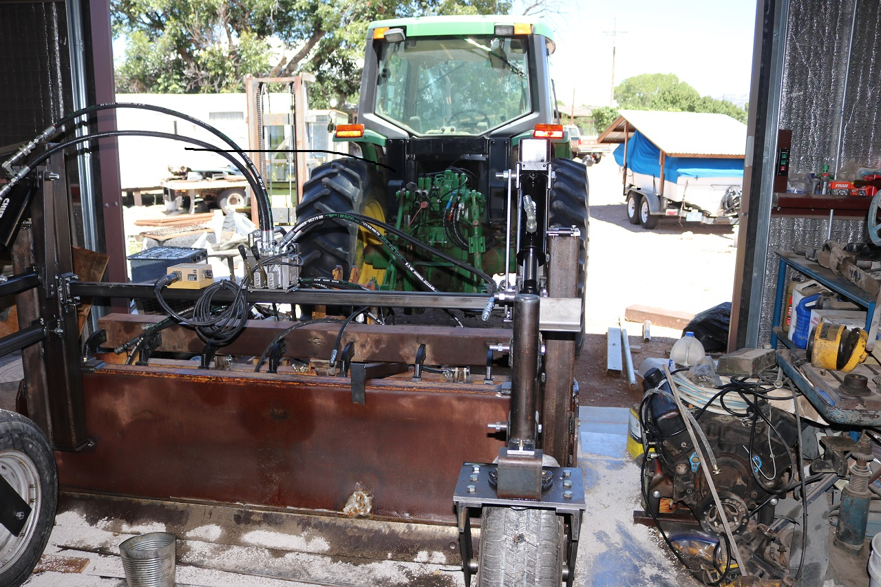

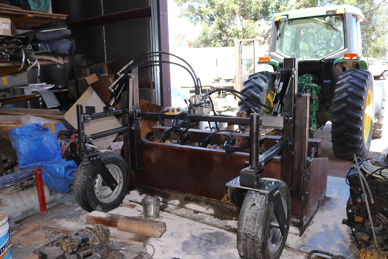

Finally built a laser grading rig using my box blade.
   / Finally built a laser grading rig using my box blade. #81
Started on this build last September and had to work on it in my spare time. Still have a few things left to do but was able to try it out today. I basically added caster wheels to the box blade. Usin g Topcon equipment and a Danfoss PVG 32 proportional valve. All joints were made with close tolerance bushing stock and have grease fittings.
I tried it out for about 6 hours today and it seemed to work pretty well.
Here are some pictures.

Sorry I have been gone for quite a while. I had troubles picking cables but finally just ordered them from a Topcon dealer. Ozark lasers iirc.

i have built a dual laser box scraper but the hydraulic controls don't seem to work
you inspired me to build my own i am retired machinist and like projects like this
receiver masts are 12 feet tall and hinge down to work on but too tall for in the building
i have a motor grader 9164 control box
what kind of control box did you use I think maybe i need a dual ag control box
can you send pictures of the box
