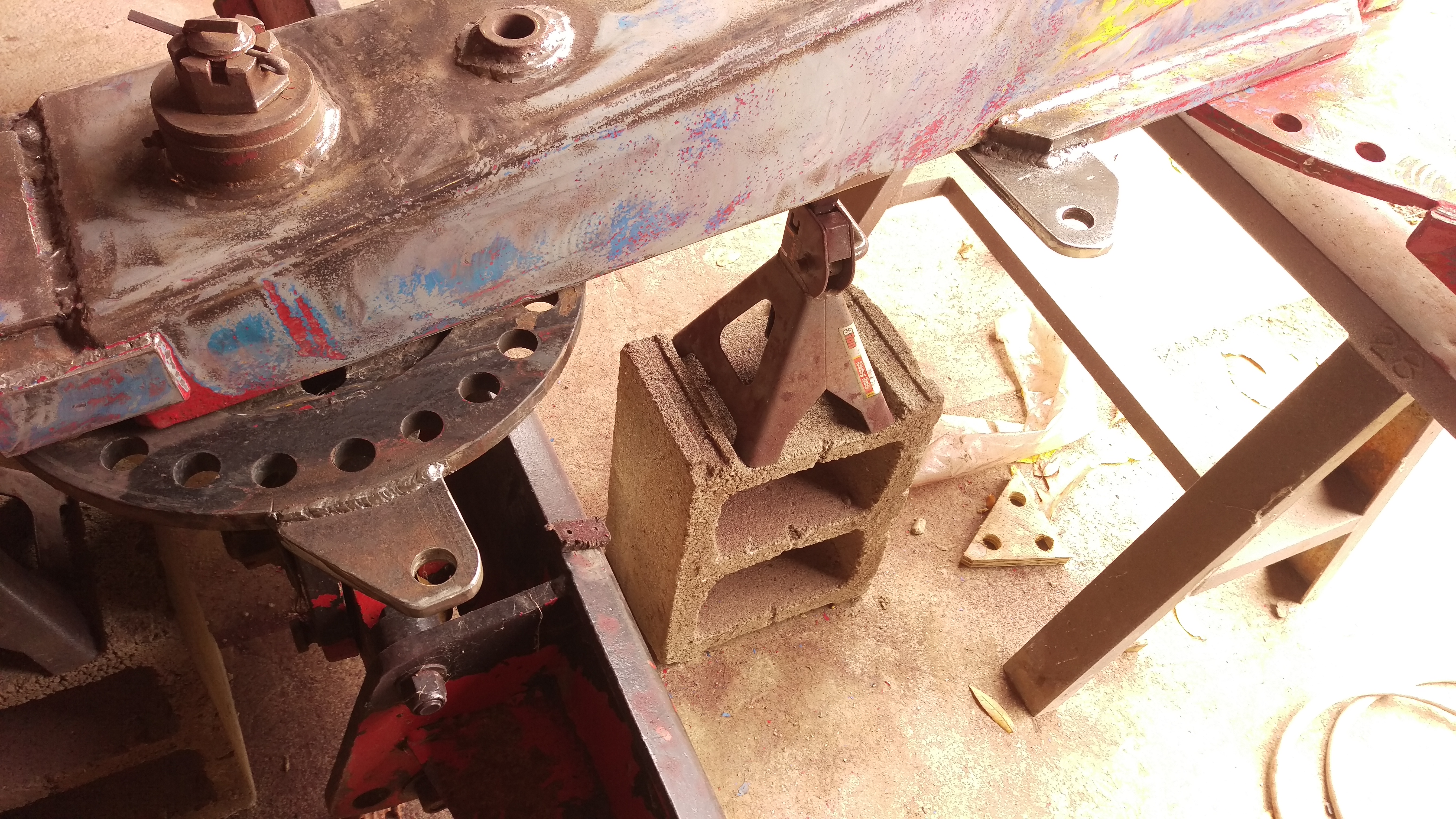

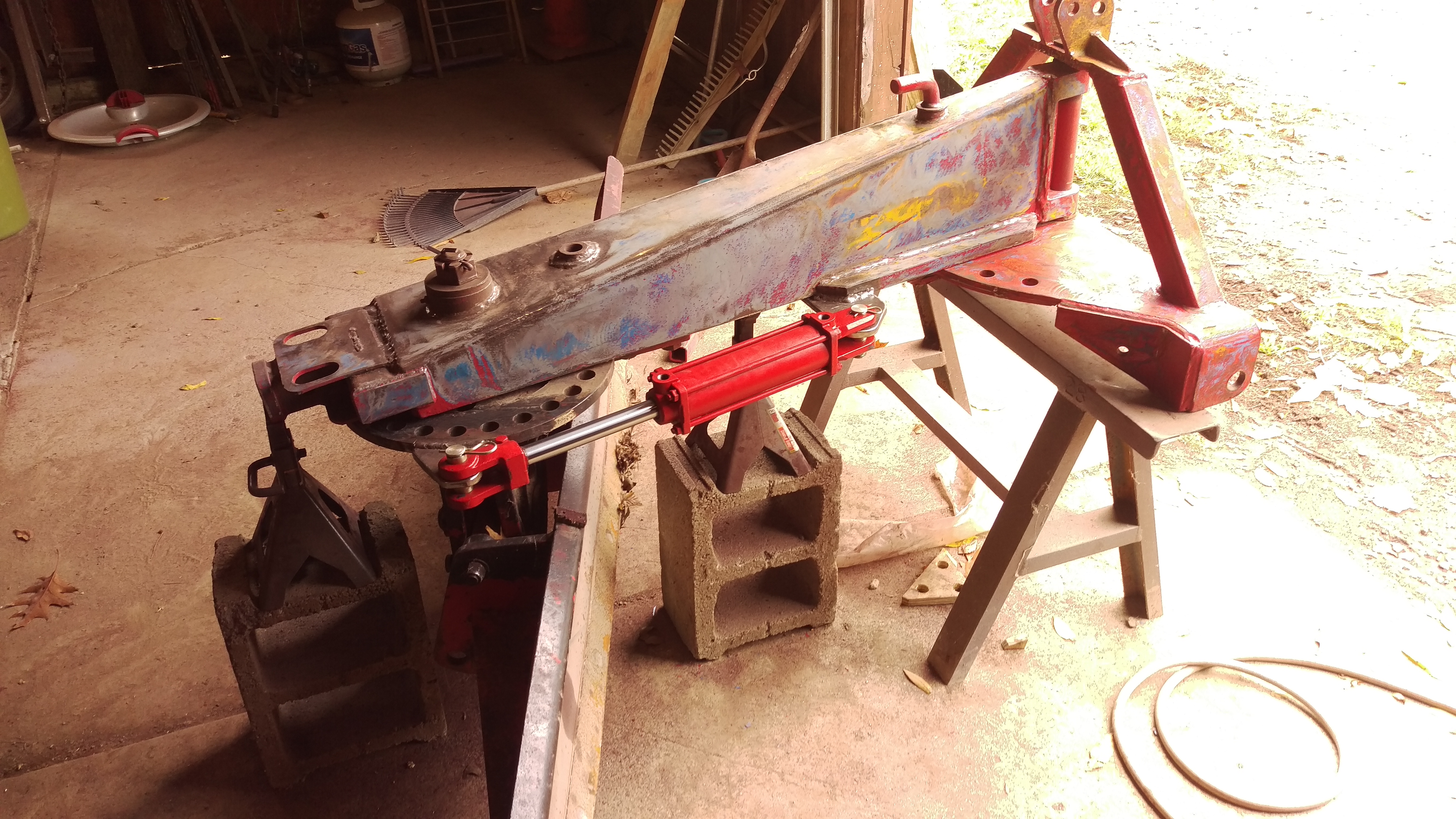

Been about 3 years or so since I got this blade, finally had the chance to add the hydraulic ram.
This was a spare ram I had sitting around from a previous project, and in truth the stroke is a little short, so I can't spin the blade all the way to 45-deg but it's still very workable. (Of course, if I need a sharper angle I can always pull the hydraulic and just use it manually)
Anyhow... I had to build a couple jigs to find a proper mounting location to maximise the cylinder stroke.

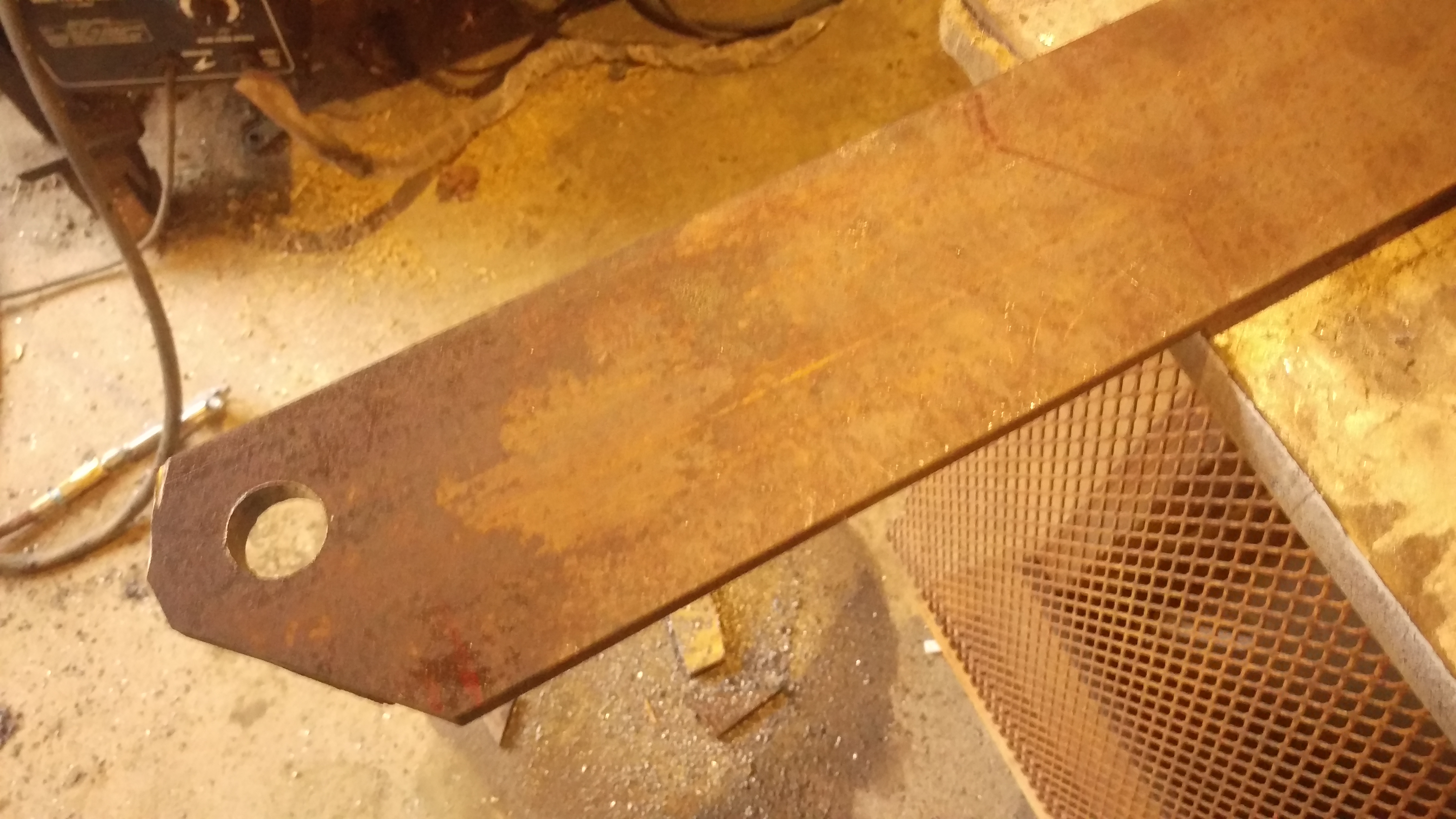

Cut and shaped the ram brackets out of 1/2" plate and drilled the 1" pin holes.

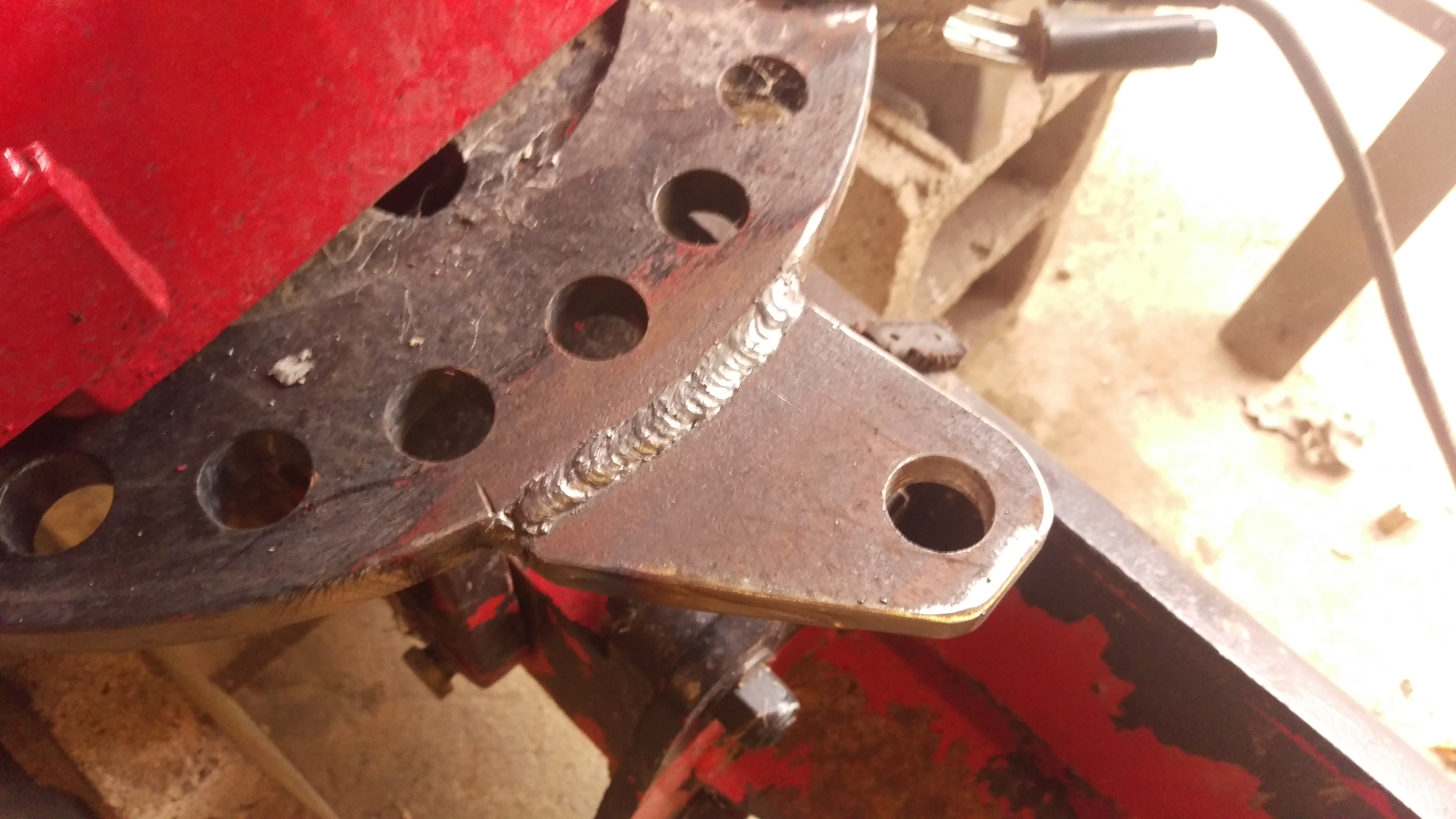

Welded the brackets up...
Then did a fit test...
Hydraulic fit test - YouTube

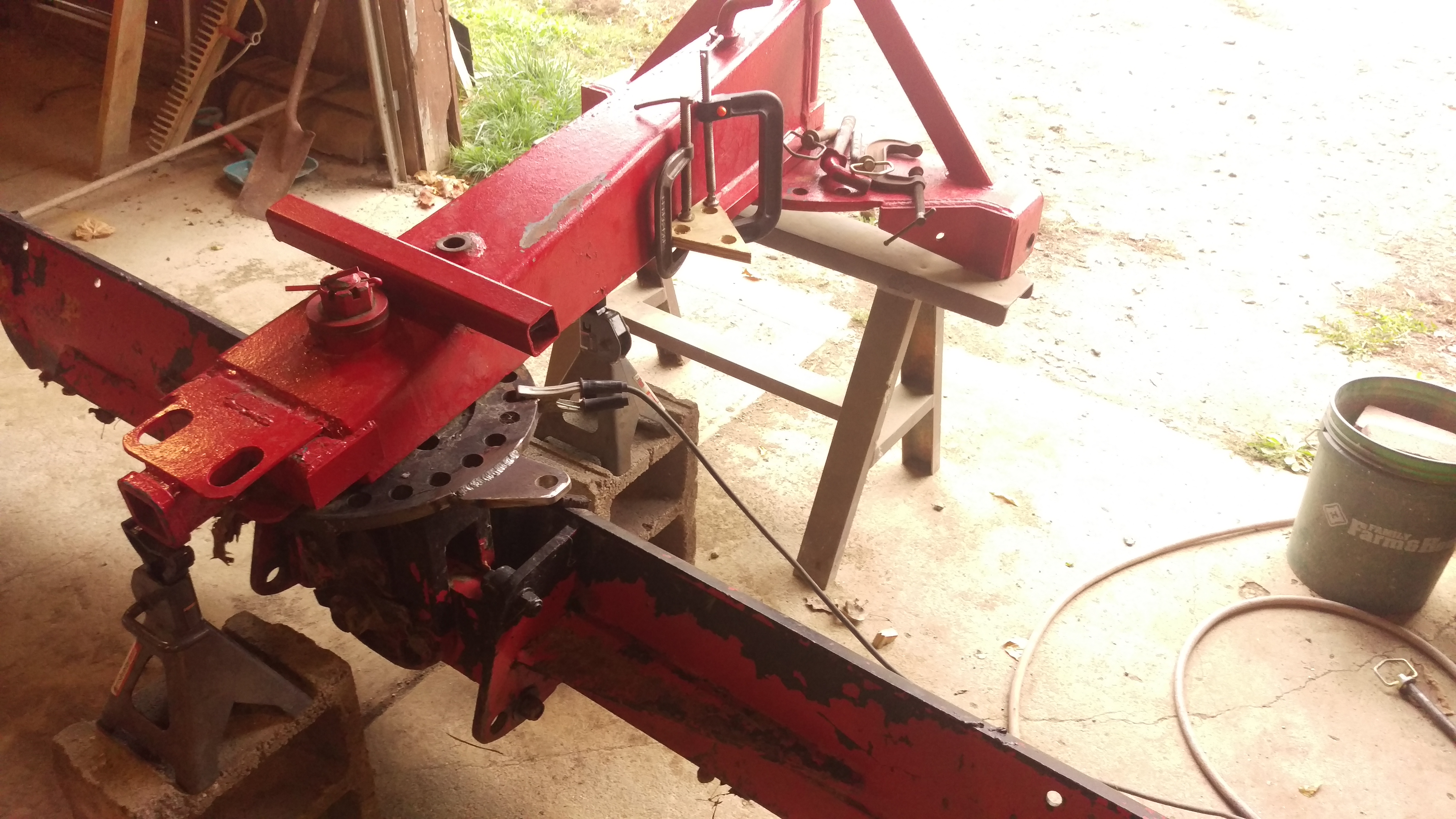

... Then connected the hoses & fittings, sanded and repainted her... And tested her out. Played in the gravel for awhile and everything works great!
Hydraulic back blade - YouTube
FYI ... The blade is an 8ft Servis (now Rhino) HD blade, weighs around 900 lbs.

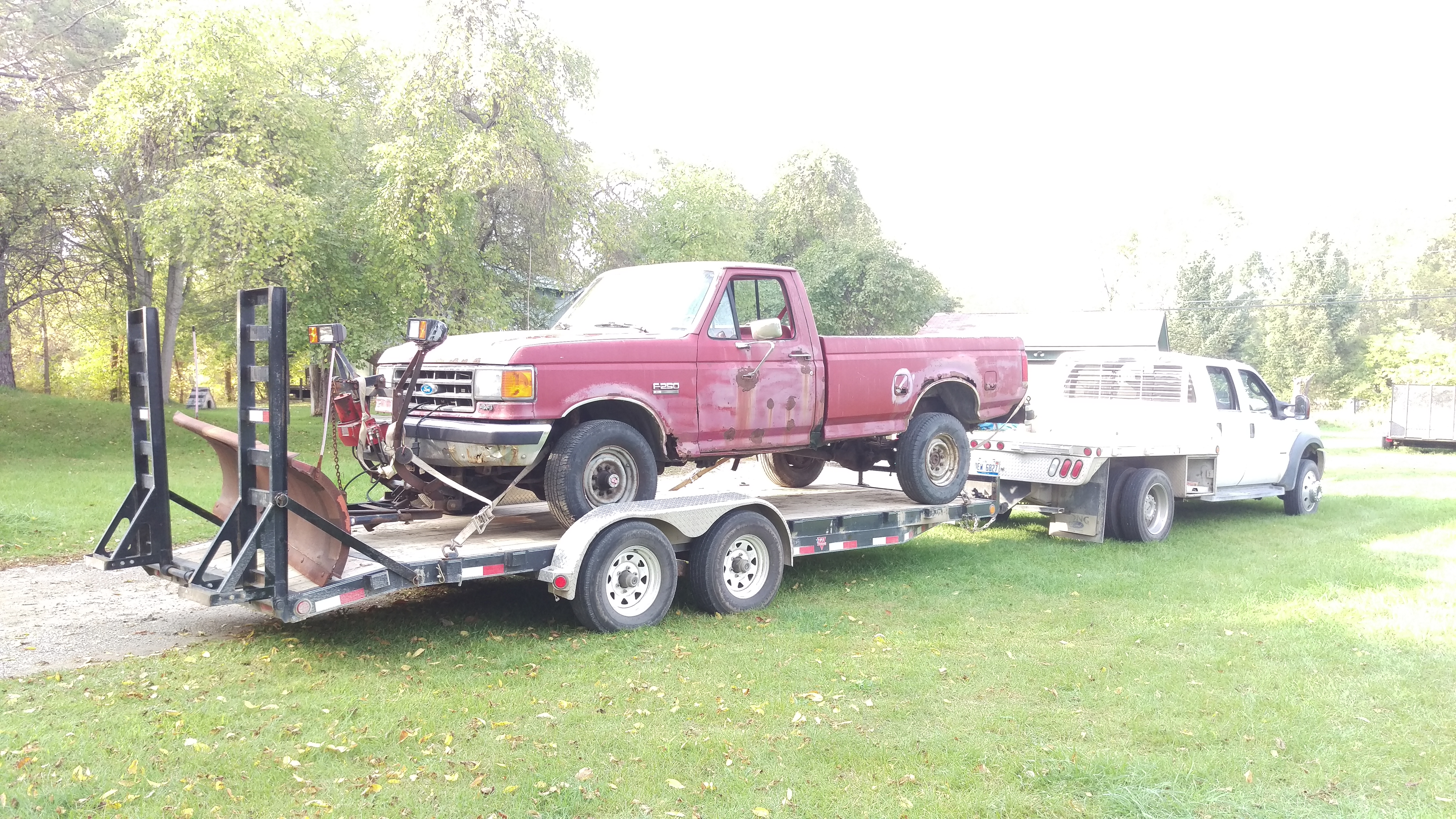

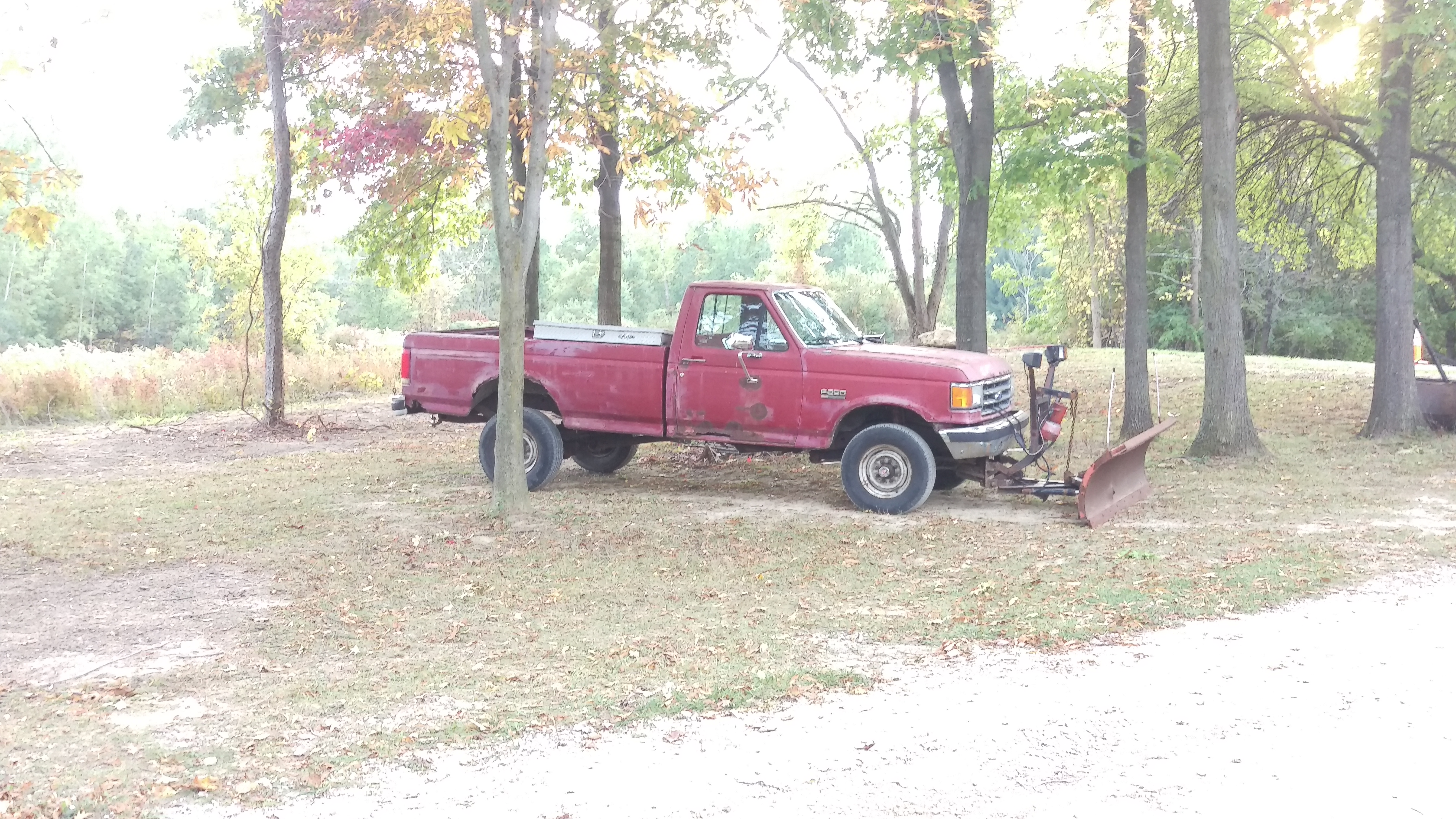

I sold that white F250 V10 a couple years ago now, have had that F450 6.0 PSD since. BulletProofed it this spring.
Although I also just picked up this '89 F250 plow truck...
How's the LS holding up? And how's the 6.2L working out in that new truck?
