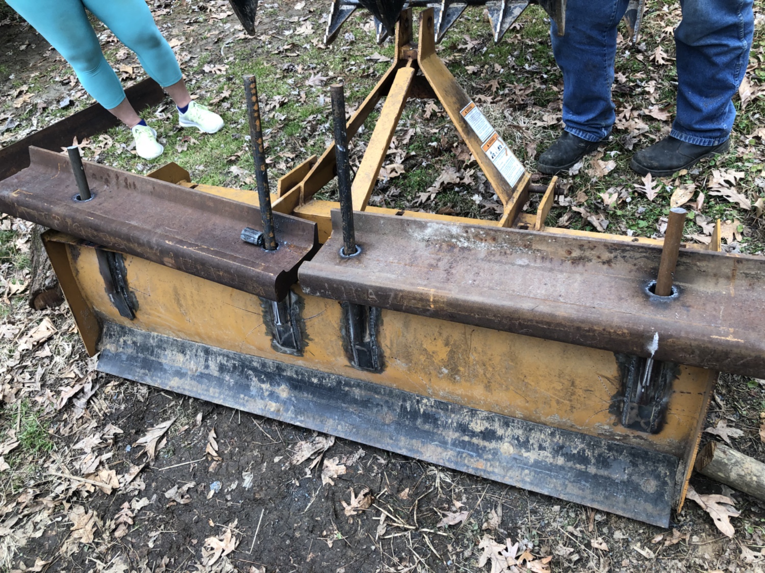

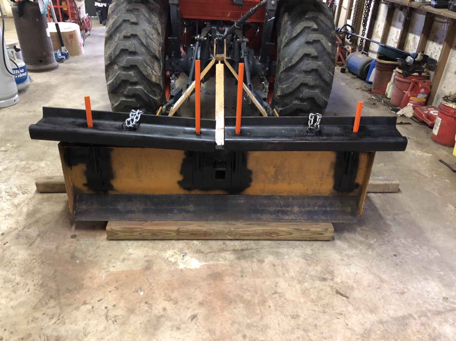

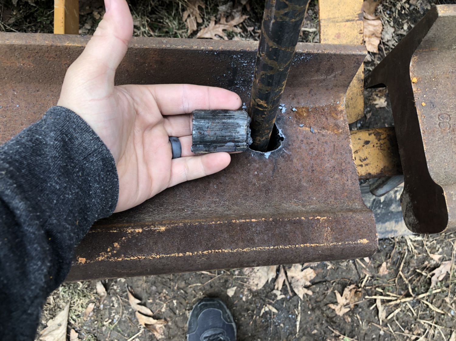

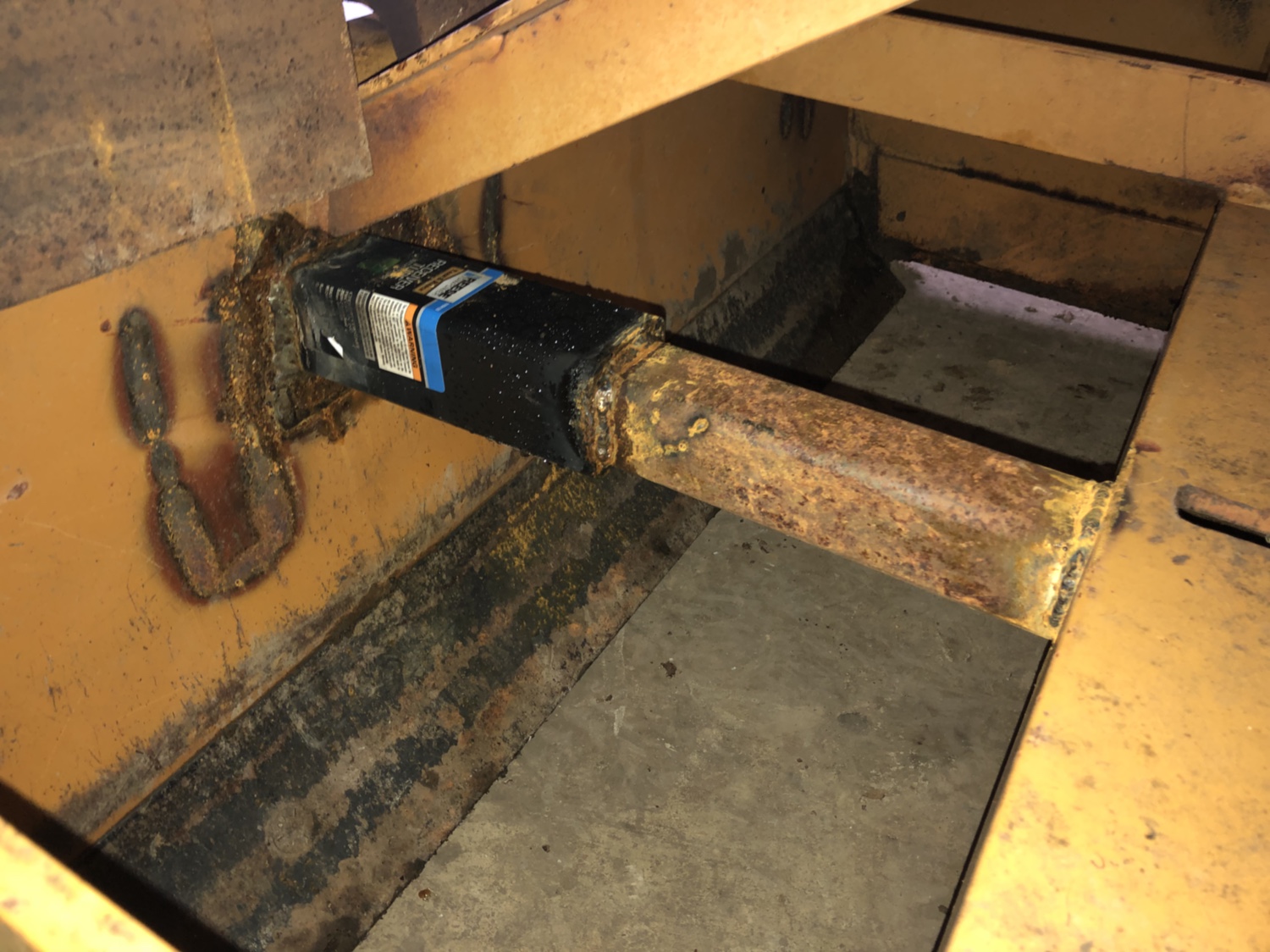

Picked up a box blade used and decided to add some weight for both better digging and a counter weight. The 2 3’ chunks of railroad are from a French high speed line and are heavier than regular track. They come in at 177 lbs per 3’. Also had a receiver hitch added for moving trailers around the yard!
Notice how thick the slug is from the web of the track. Much thicker than regular track. IMG_0946.JPG
Fully welded from front to back for plenty of lift capacity on receiver hitch
Had some chain attached so I can lift the weights off the box blade by myself.

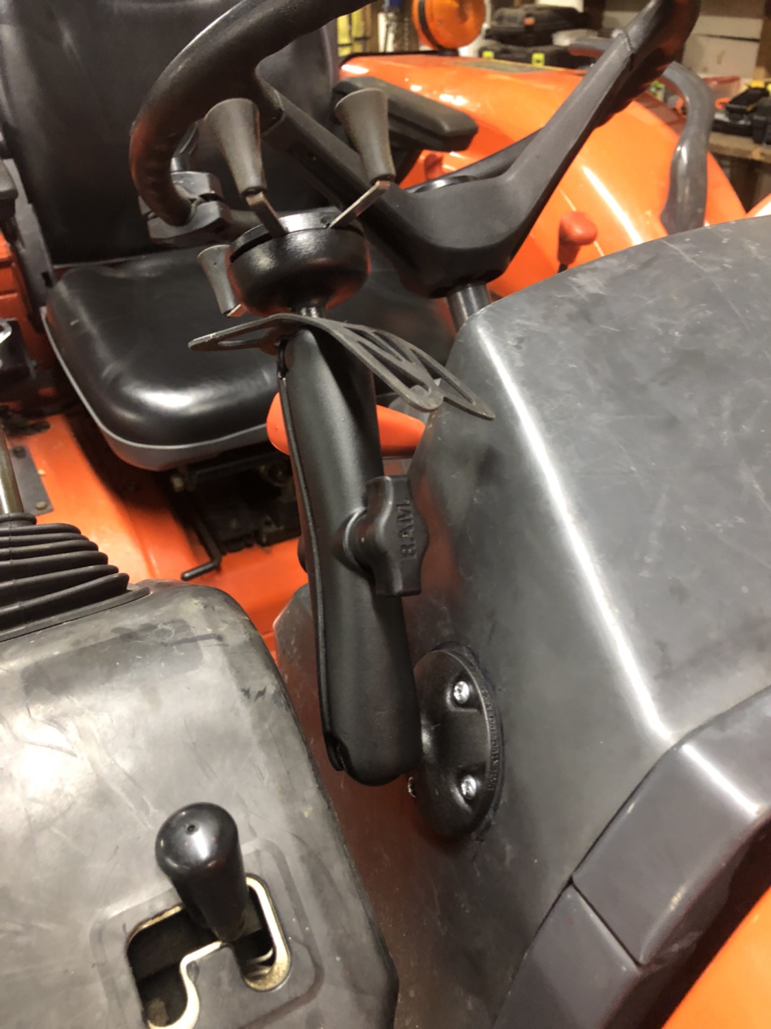

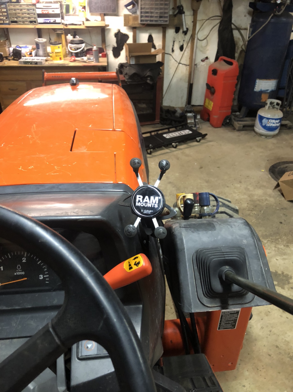

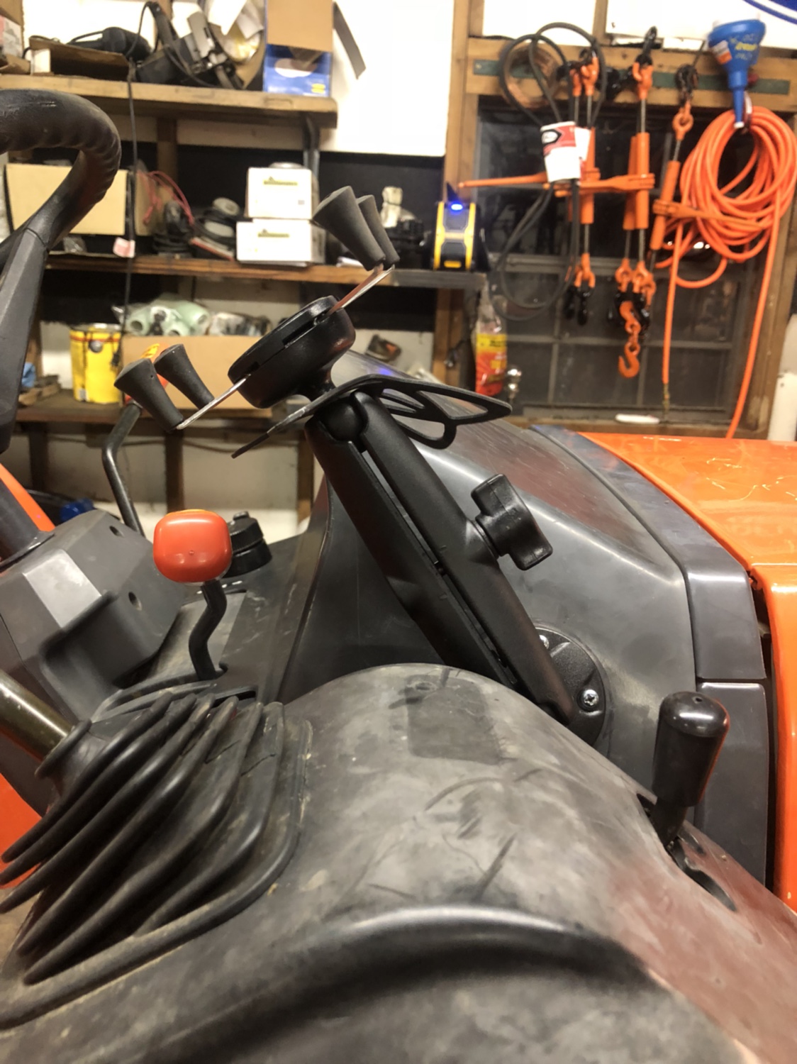

Added a ram mount phone holder. Keeps it from being bumped when on my belt and risk of it falling and me not noticing.

Gonna try again. Thanks for the feedback also! Glad to share stuff and it help others! Links to products used for he phone mount at bottom of this post. I did use 2 1” square pieces of metal behind the plastic housing to give the nuts something solid and large to prevent/ or reduce the risk of pulling them through the plastic. Increases surface area on the back side of the mounting bolts.

That's perfect! Never would I have thought of mounting it there! Perfect location, I believe. I'll look at my layout when I get home in a bit! Did you use some type of gasket between the Ram base and the tractor housing?

No gasket. It’s just the base straight on the plastic. I held it in the general location I wanted it and used a marker to trace half of the mounting base. That way I could get on the side of the tractor, line the tracing up with the mount base and drill the holes.
I do feel the metal tabs I used on the back of the top and bottom bolts will go a long way to prevent the mount from pulling the bolts through the plastic.
I also used blue lock tight on the bolts/ nuts to prevent loosening from vibration.
I am really happy with the low profile to the hood yet easy to see and access. Should be fairly safe from being hit by limbs or anything like that.
