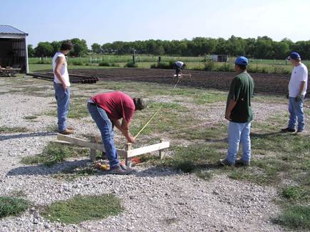

We're building a twenty four by forty shop with twelve foot walls, three-twelve pitch roof, and a sixteen foot overhang on each side. It'll have two twelve foot wide openings for roll up doors and one service entrance.
First we had to lay it out.

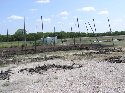

Then we had to drill holes and set posts.

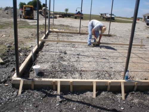

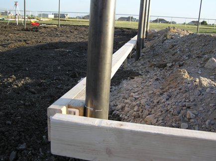

After that is was time to form up the shop floor. This is a picture of the brick ledge kind of thing we do on metal buildings. We use a two by two (one and fiva eighths by one and five eighths) nailed to our forming lumber. This gives us a ledge for the sheet metal to go down bdside the slab and still have a floor so the varmints don't have easy acaess.

One of the things we did was put in the plumbing in the slab for a restroom if one is ever required down the road. It only takes a couple of minutes now but would be a major project later. We put in the P trap and ran the three inch PVC beyond the wall. We also put in a future water source access.

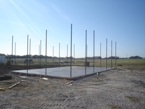

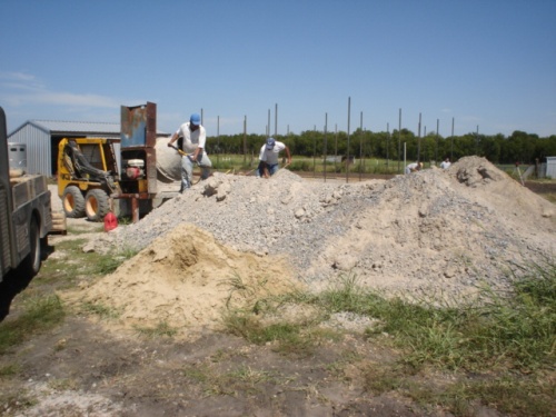

We mixed the concrete on site for the slab.
   / Finally, a barn built with our new connectors

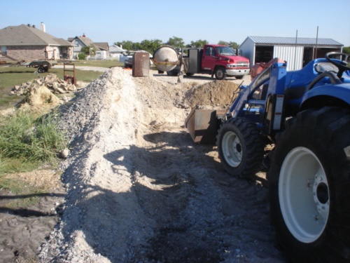

It took a lot of sand, gravel, and cement. We started mixing about two in the afternoon. It took sixty mixer loads. We had it all poured just before eight in the evening.

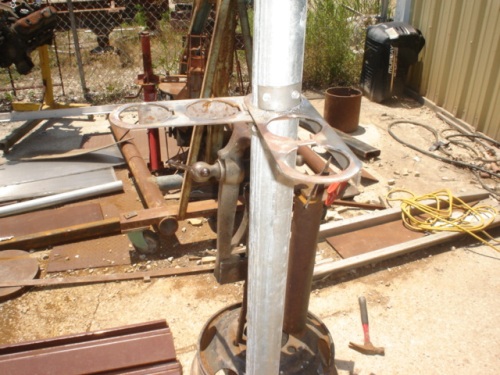

What makes this work and what I've applied for a patent on is this principle.
#9

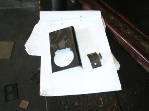

These come in rights, lefts, straight throughs. The idea is the brackets are placed on the posts and attached via self tapping screws. Then the four inch purlins are cut to fit between the posts and then attached to the brackets or connectors with self tapping screws.

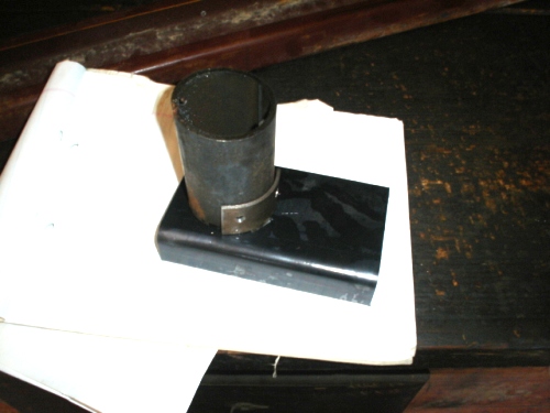

Originally I came up with one piece that was a right, a left, and a straight through. But then as I saw confusion in the eyes of those I showed them to I realized maybe offering three pieces would be easier for folks to understand.
This is a shot of a corner using the original design.
