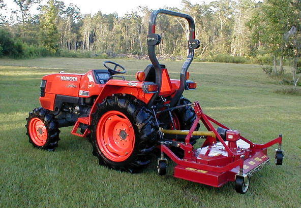

on my L2800dt my dealer recomended filling the rear tire with water and anti freeze for better balance when installing and using the front end loader.i usually always have a box blade or my finish mower hanging on the rear for ballast.so my question is,do i still need to add water to the tires and is it worth it in the long run.

Sweet picture! Nice tractor, green grass.... sure beats staring out the window at this snow coming down.
My dealer recommended filling my tires for FEL use in place of using rear ballast and so far , I've not needed any additional ballast with the loads I pick up. Sure makes it nice for maneuvering without having a lengthy implement hanging off the back.
Most of my snow plowing is now done in 2WD, also, which makes steering easier.
Did I mention how much I like that picture? /forums/images/graemlins/grin.gif

Hey Vulcan, boy thats one nice looking tractor! /forums/images/graemlins/laugh.gif Is it a shuttle shift?
You know as far as filling tires go, it sure can't hurt. I filled mine myself for just the cost of the fluid (windshield washer at $.94/gal) the only real drawback I can see is if you're in an area where flat tires is a problem, like having old boards or nails hidden in the grass. If not, than its probably a good idea. My tractor is about the same size as yours and it feels a little more stable with filled tires.
