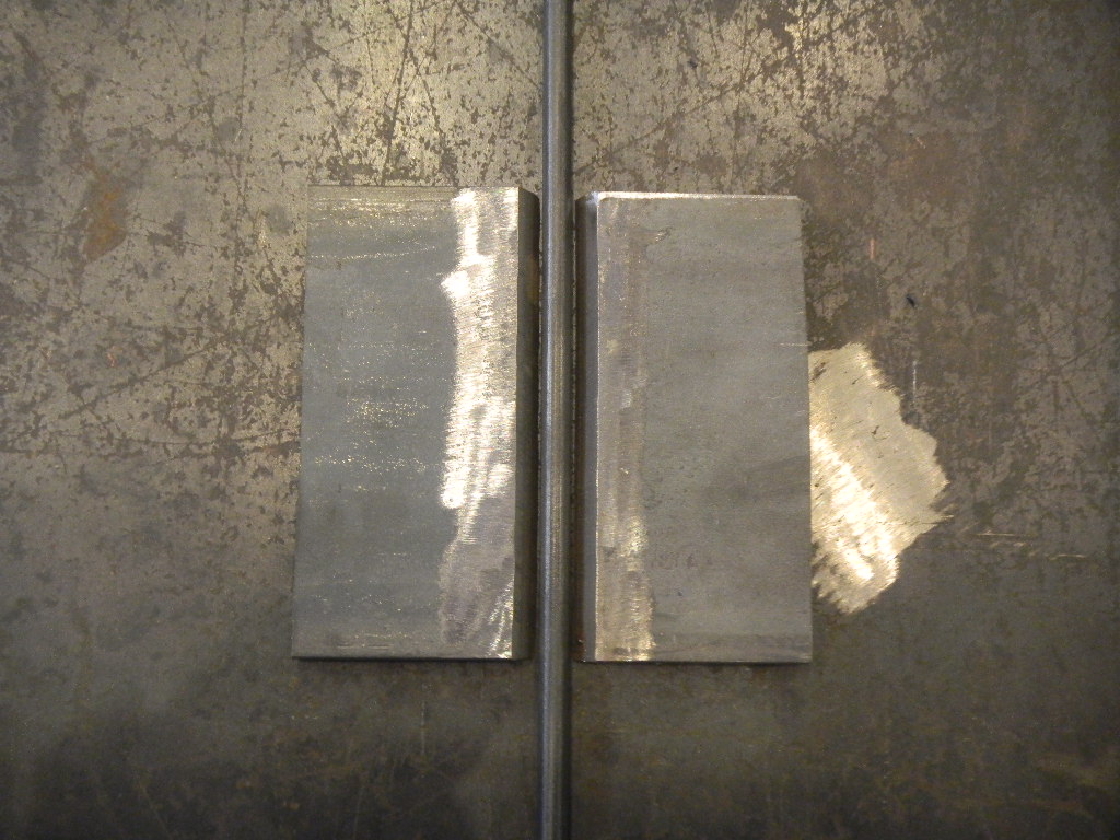

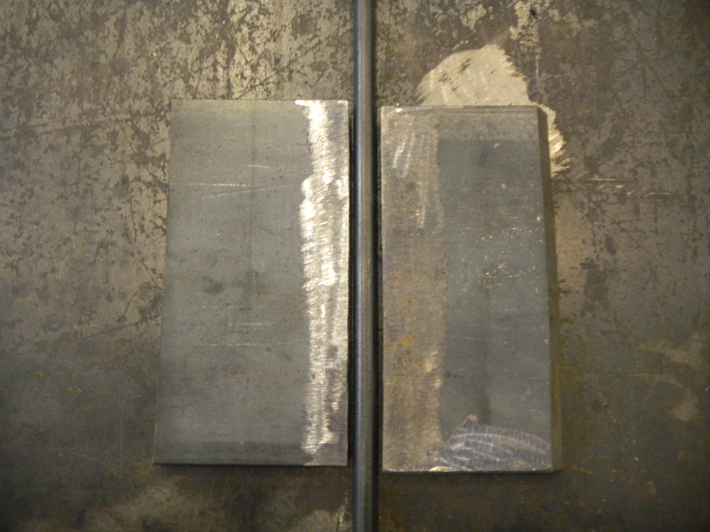

My dad's tractor loader bucket is worn thin on the bottom rear and is rusted/pitted pretty bad. He picked up two pieces of 1/4" X 6" steel that I welded to the inside of the bottom of the bucket. The scrap yard cut the pieces of steel 1/2" too short and there's a 1/4" gap on both ends from the sides of the bucket.
To fill in those gaps I had thought about laying a piece of 1/4" round rod in the gaps and welding it to the steel plate and to the sides of the bucket. I think that would tie everything together making everything stronger.
Am I going about this the right way?
   / Filling gaps #2
That is called slugging the weld. People do it all the time. ;)

   / Filling gaps
Thanks for the good info and I also learned a new word today, slugging.:thumbsup:
Now I just have to get it finished.
Thanks again

   / Filling gaps #8
1/4" gap welding 1/4" plate should be doable without anything extra, unless the bucket sides are real thin or something. If so, I'd just turn the heat down, lay a pass on the bucket side on each side, knock the slag off. You should now be down to ~1/8" gap. Perfect.....weld it up with a second pass
   / Filling gaps
#9
Yeah, I'd looked at doing that but wasn't sure about it. Some places on the bucket are really thin. The more I studied it the better using a rod for filler looked.
