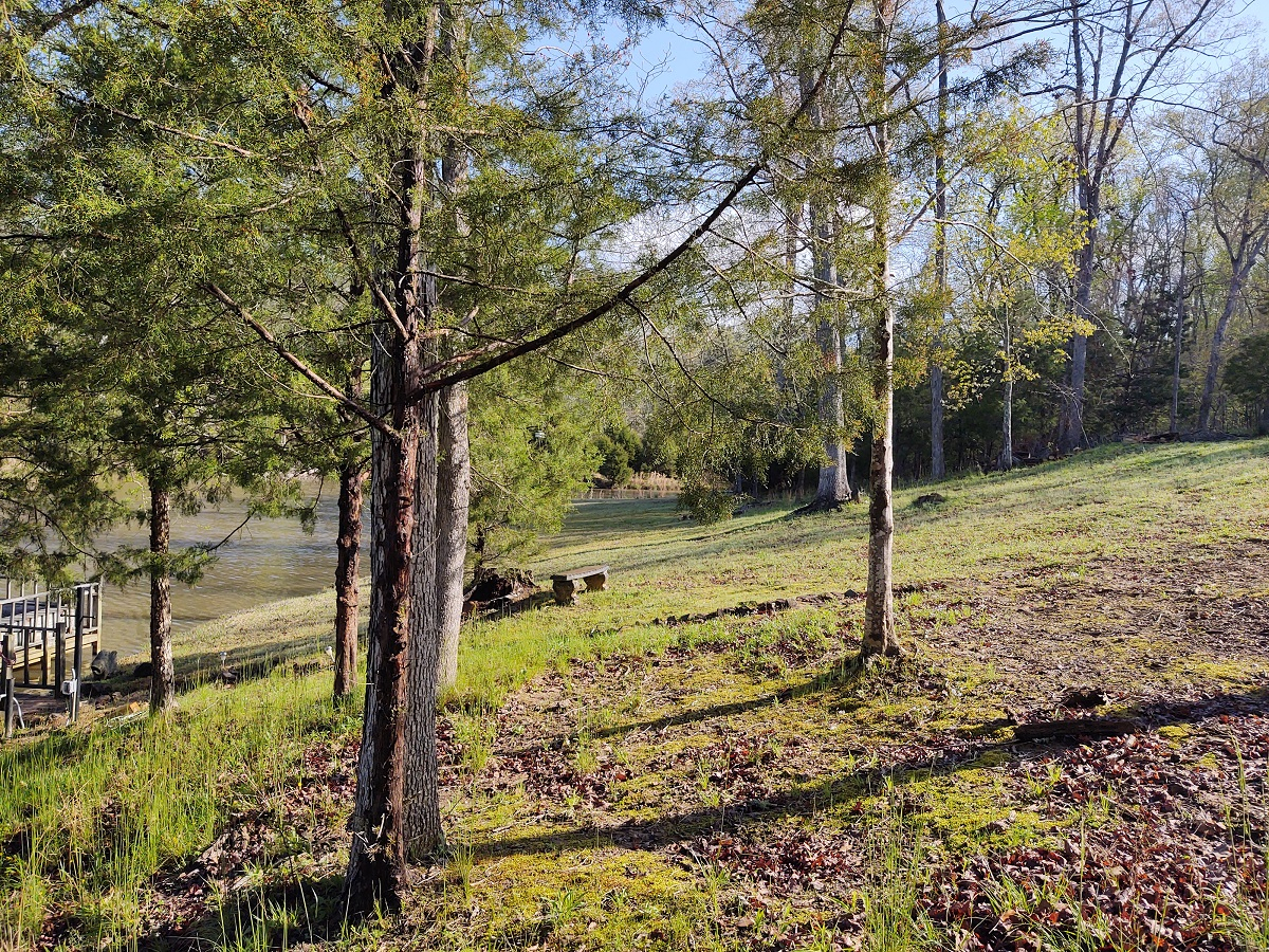

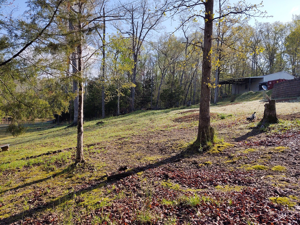

I just did this on my GC1735E. I did the tires first, they ended up at 110# each. I noticed that it helped settle the tractor some so that it was not quite so bouncy. It was "better" but still felt tippy with the front end loader on my hilly property. I have since added 480# on a heavy hitch so about 550# total to the rear and it's a whole new machine. Because my yard is so hilly, I am going to need some weight even with mowing. I think having the mid mount deck will help a lot, I had to take it off for tree and dirt work due to ground clearance, but 200# sitting that low should help. How hilly? It makes me nervous the entire time I am not going straight up. I did some measuring and almost all of it is 10-15 degrees, with some areas closer to 20. See attached, with my helper.
