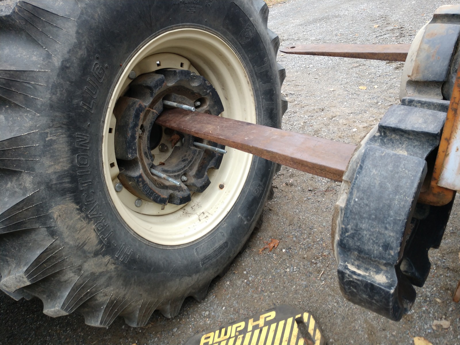

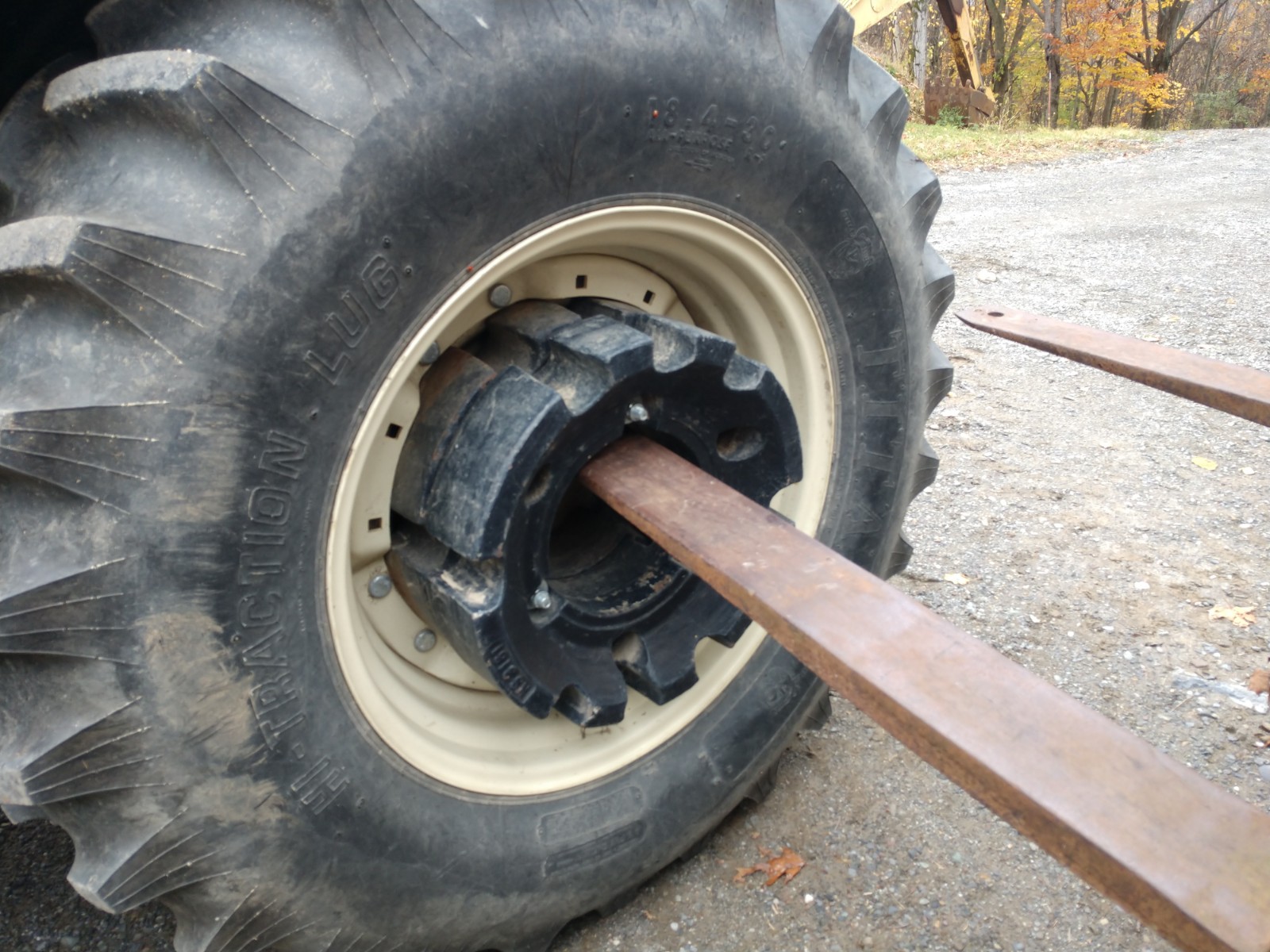

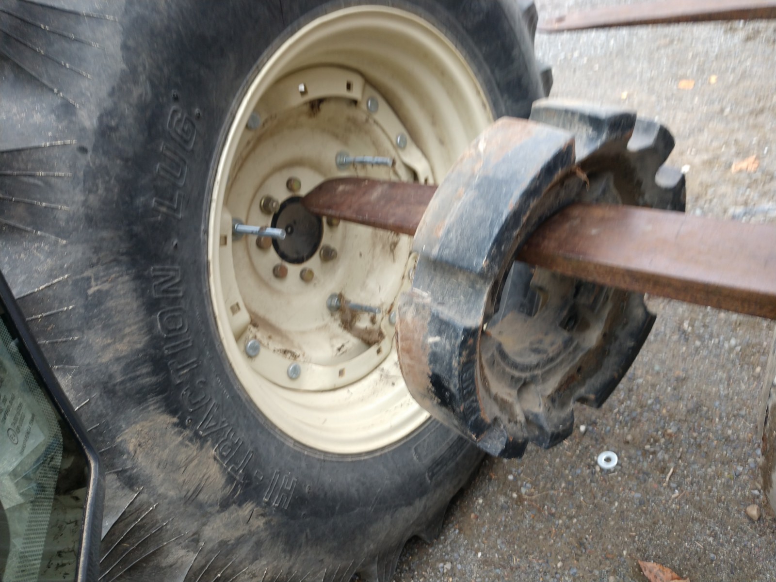

My weights are 300# each, a bit much to manhandle;
removing weights 4.jpgremoving weights 3.jpgremoving weights 2.jpgremoving weights 1.jpg
That said, yes non liquid filled tires are much easier to dismount and repair.
