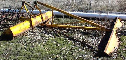

You could always do it old school, marking elevations with stakes and moving the dirt and then checking and staking again. The amount of dirt you are moving needs more than box blade. You need something like this...if your tractor is big enough.
Belly Dump
/ Field Leveling #22
Belly Dump, learn something new every day.
But looks like it would work better as you don't have to drag the dirt all the way, you can carry it and dump it.
