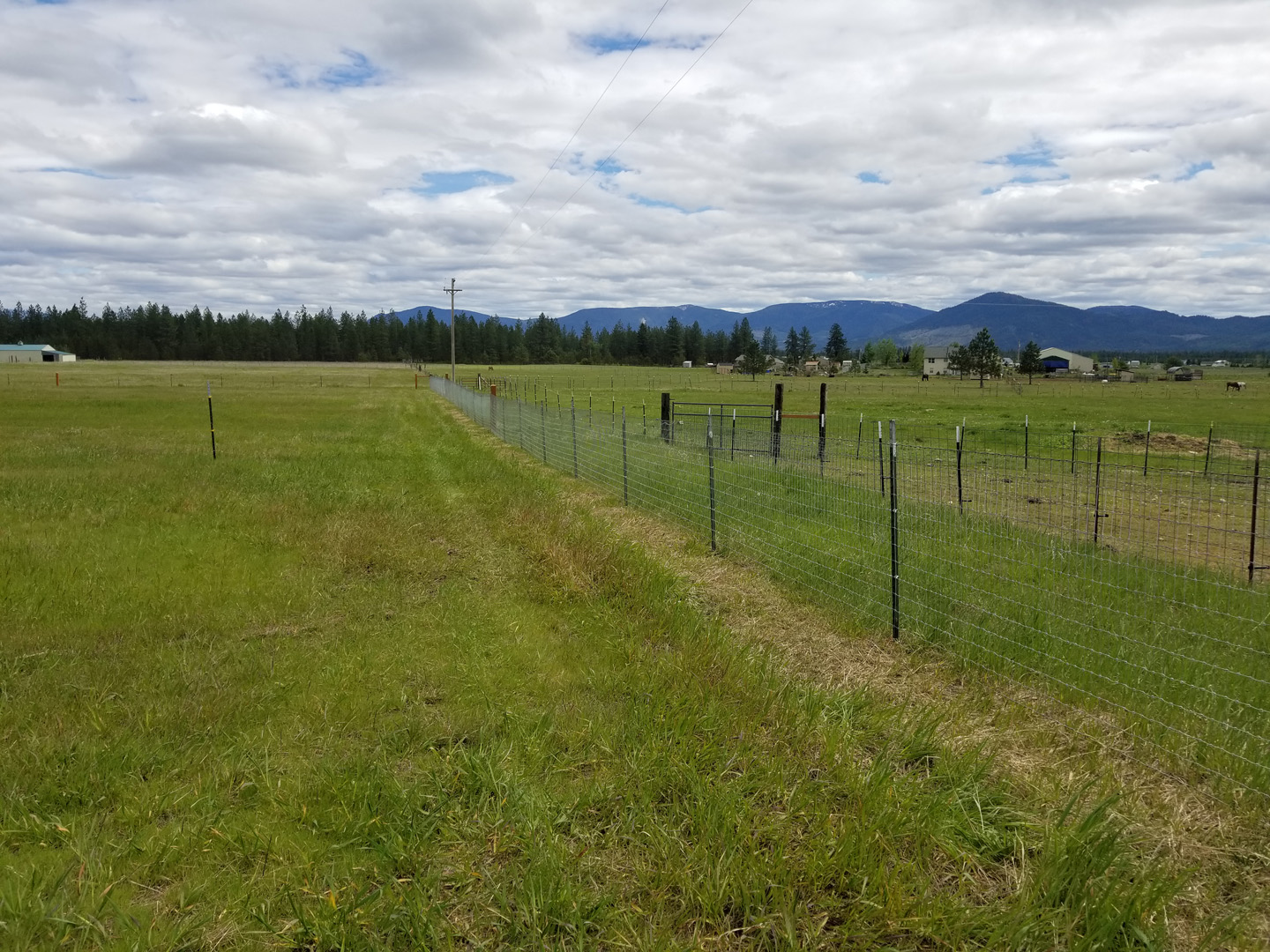

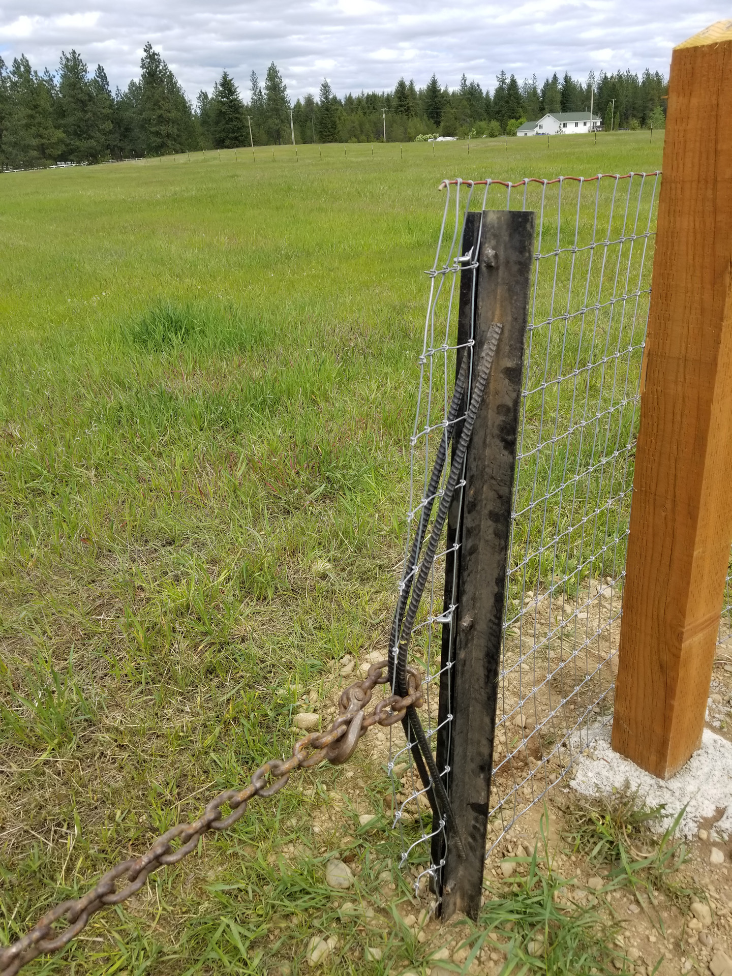

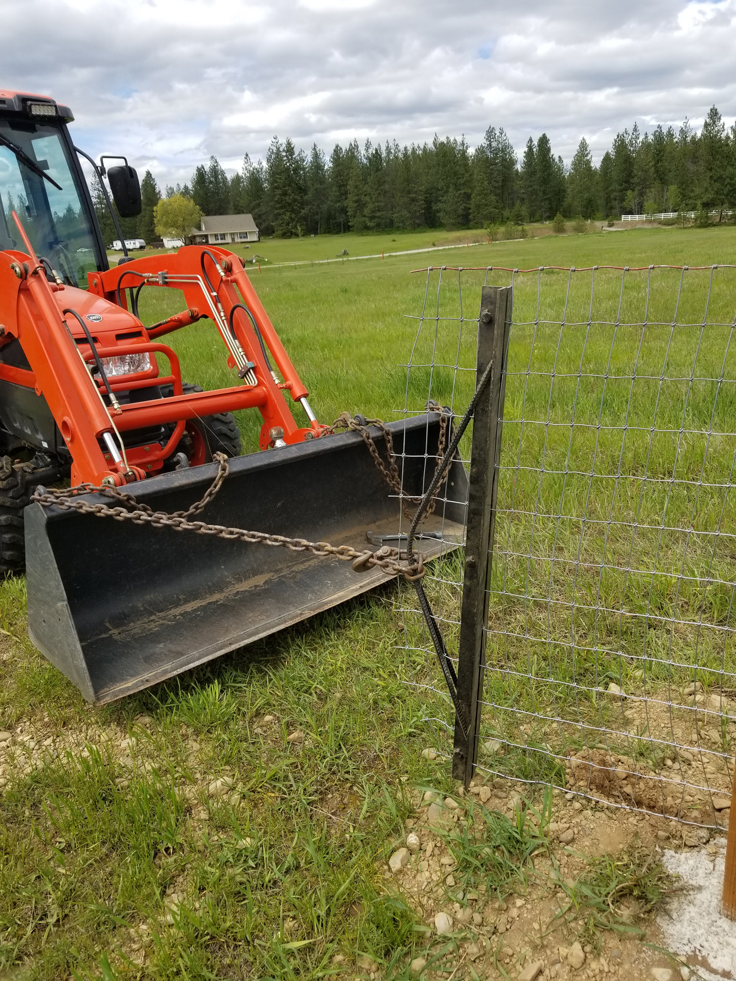

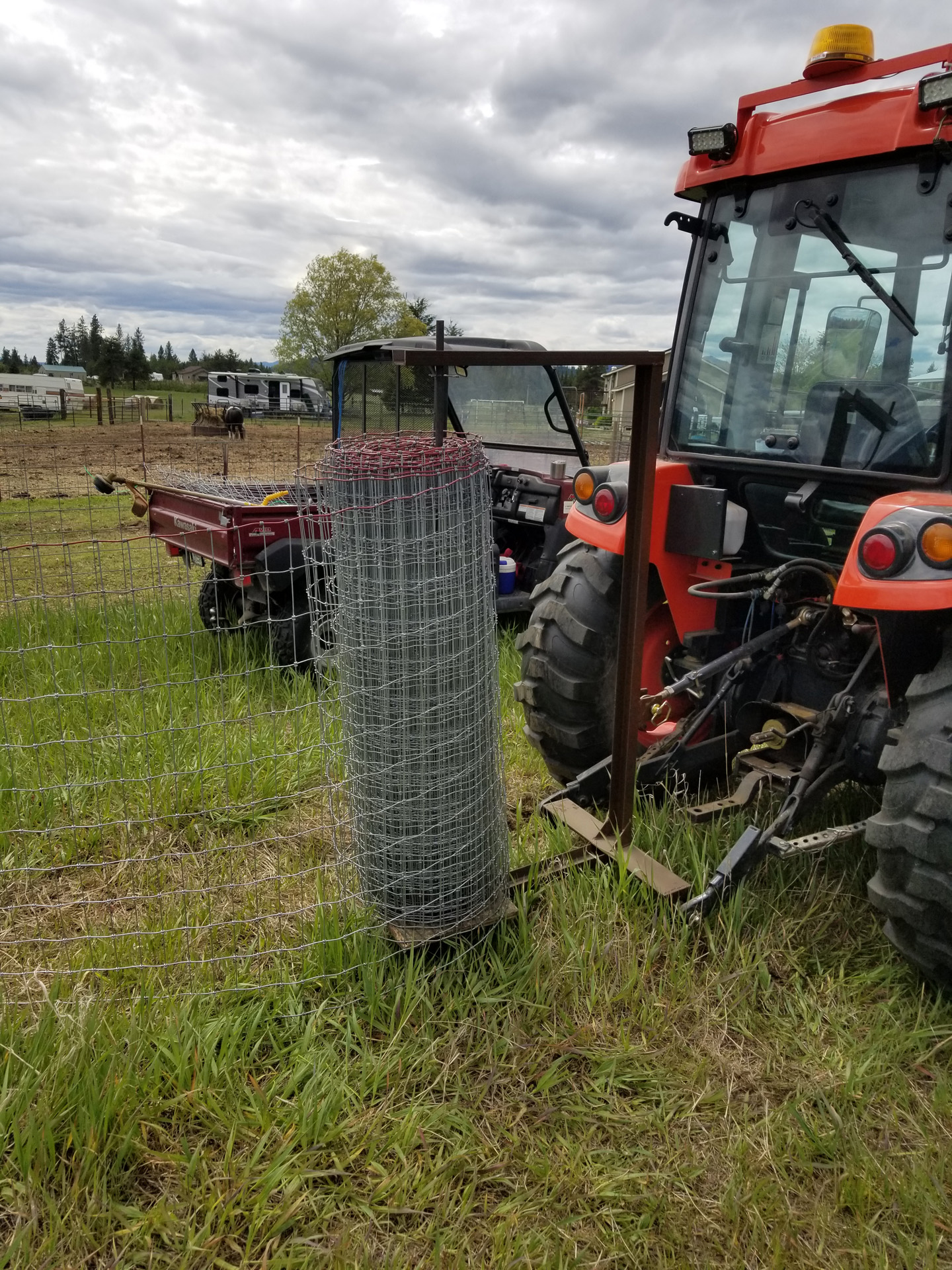

well, i finally got around to installing the fencing. Worked great. Only thing i added was a round 24" diameter bottom plate in place of the piece of wood. I thought the wood piece would just spin ant all would be good, but it actually got caught up a few times in the wire. I cut a piece of 12g steel from scrap i had on hand, and all works great now. Heres a few pics, but they dont show the round bottom piece . in use.jpg pull tight 2.jpg pull tight 1.jpg fence 1.jpg
   / field fence 3 point hitch unroller #12
Looks great !!! Awesome pics , thanks for posting ..... Great insurance also for those beautiful Fjords ! :thumbsup:

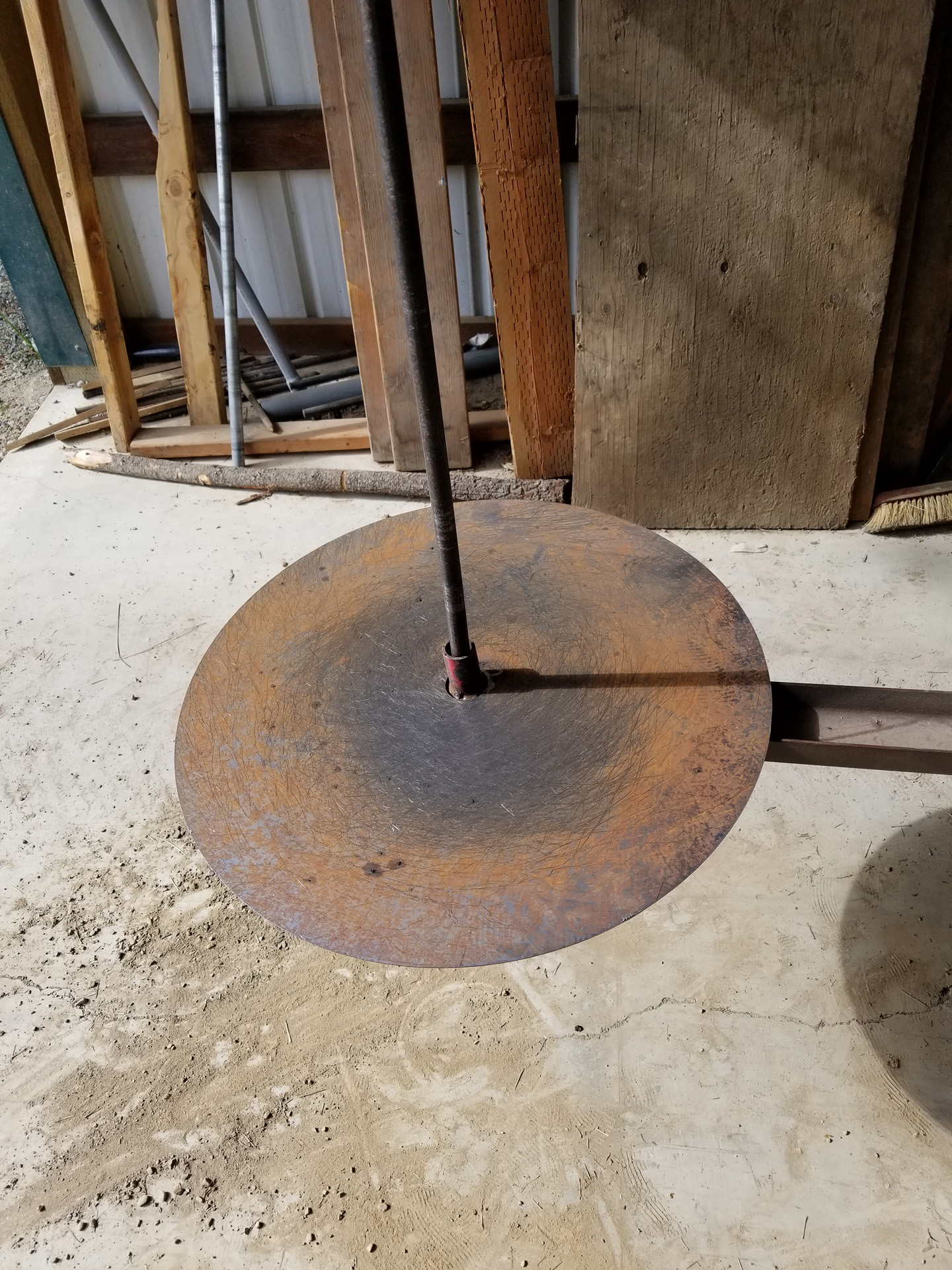

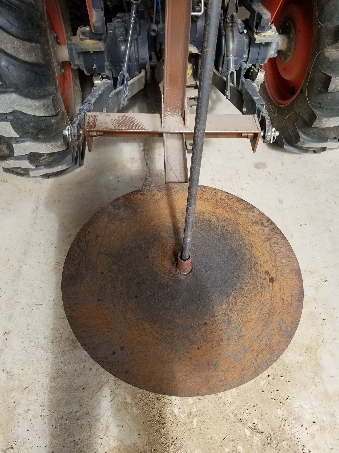

Heres the round plate i had to add. i also added a small piece of pipe to help direct the support pipe in while installing a new roll of wire. With the round plate this thing works great. no more binding. 20190527_163617.jpg 20190527_163628.jpg
   / field fence 3 point hitch unroller #14
Good job, I think it looks great.
