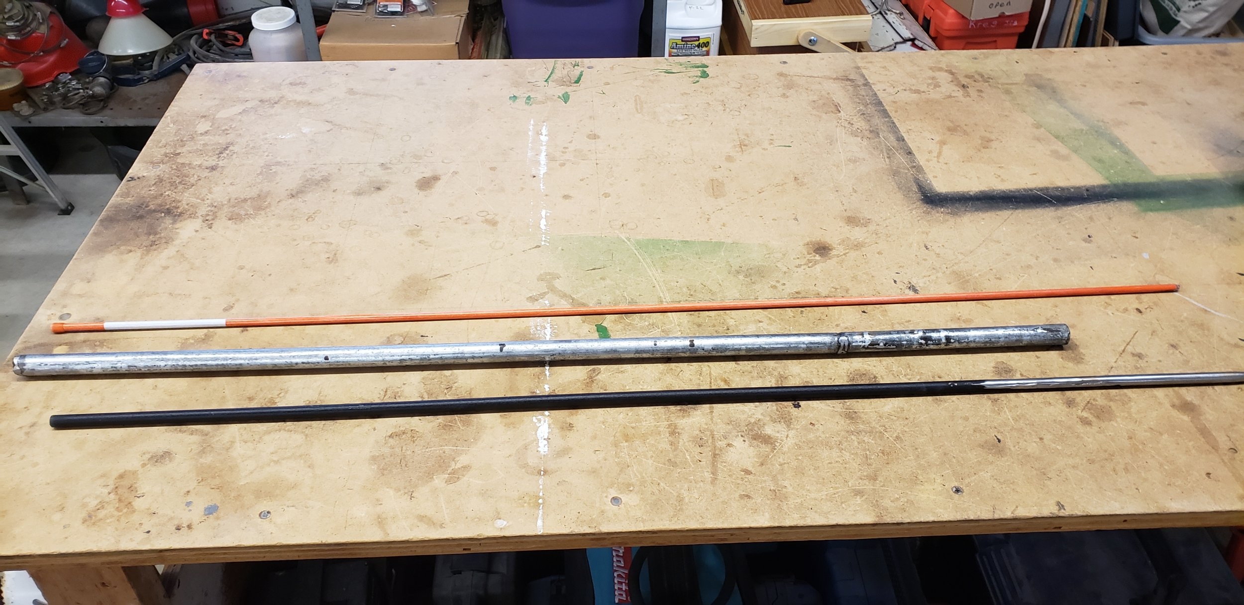

This is what I made for fiberglass driveway markers. It is a 42" by half inch pipe with a 48" by 3/8" steel rod that slides into the pipe. One end of the pipe is welded closed so it can hammer the metal rod into the ground, making a hole in hard/rocky ground for the 48" reflective marker to fit into.
With soft ground the 3/8" steel rod is not needed.
Maybe something like this would work for fiberglass garden stakes and cause less stress-splinters on the stakes.

I have been contemplating making a 3/8 diameter rod with a side hammer on the top section 6” above the waist.
So you can walk along and pound in the steel rod and back out to make a nice hole and drop in the fiberglass rod.
I think it will be nice for frozen ground. Know I just need to remember to build it before next winter

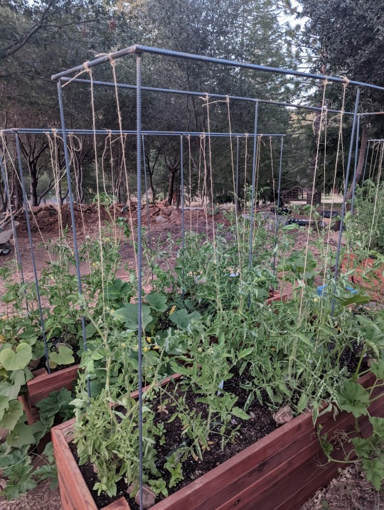

I avoid fiberglass as much as possible; it seems really nice when new but then rapidly becomes a disaster.
I use steel rebar for a lot of things. Bent into a J it makes a great hold-down for deer cages put around young trees. I mostly bend it in my truck's (empty) receiver hitch; tight bends by putting it in the hitch pin hole and wider bends just in the end.
I was requested to make these for the tomato beds, rebar was cheap and easy to use for it.
