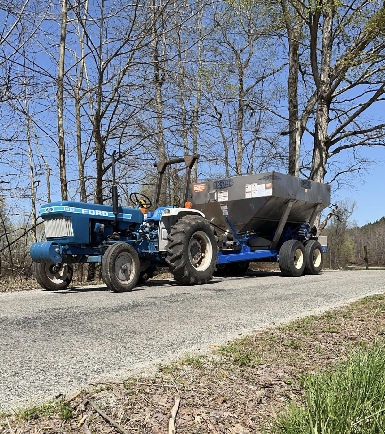

Stopped by the local co-op to get the fertilizer wagon and a couple thousand pounds of fertilizer for my sheep fields, the little ford took it like a champ.
A fertilizer wagon is just a rolling load, so how heavy of a tractor you need depends on how much fertilizer is in the wagon and how flat or not your land is. The spreader you have looks like a pretty typical 5-6 ton spreader, which would weigh not that much more than your tractor if it had one ton of fertilizer in it. So, I am not surprised that the tractor would handle it easily. If it was completely full and you had some hills, you would need your Farmall 95 to pull that.
