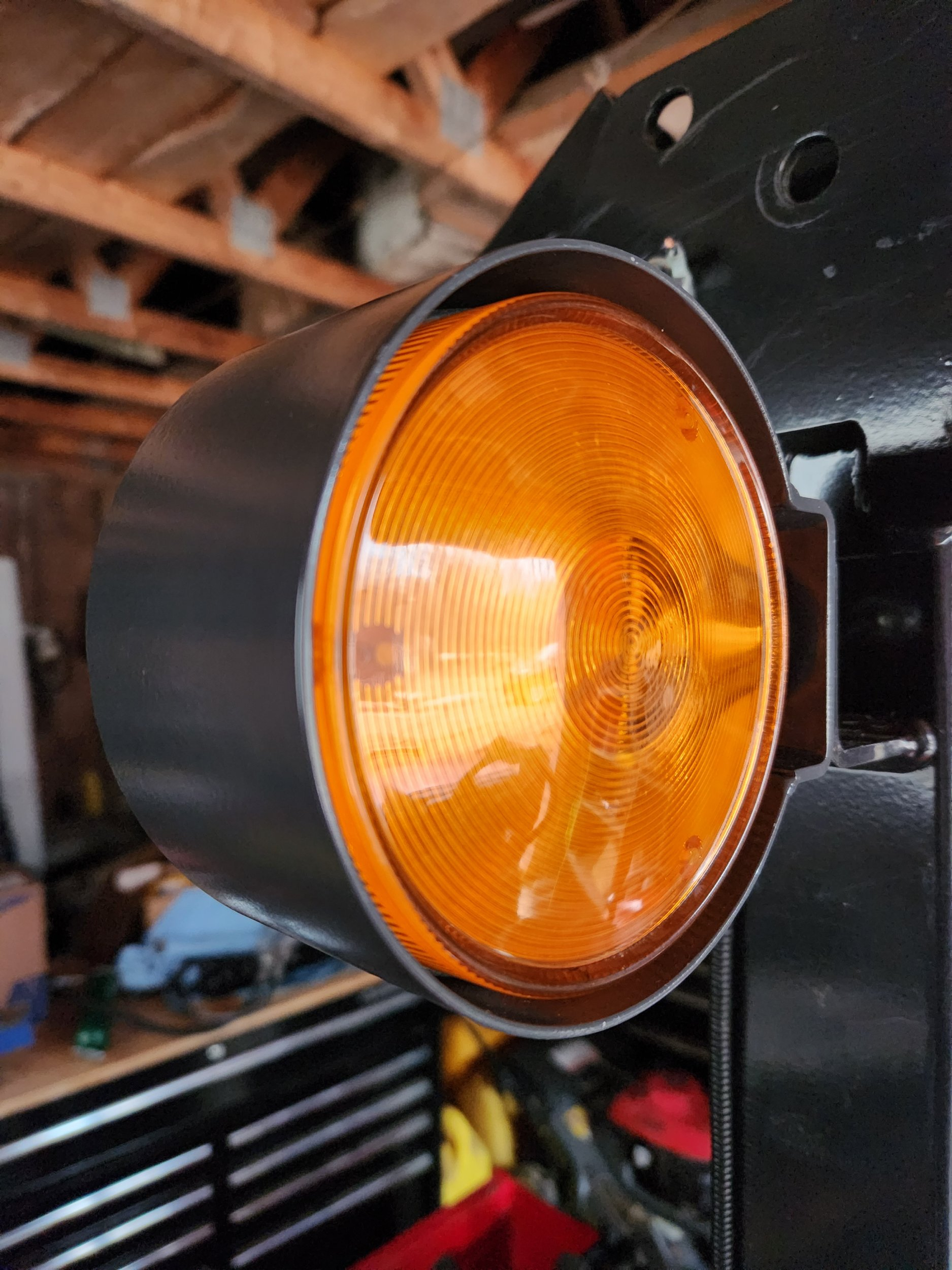

Paul's work is simply amazing but for those of us who do our own work I just use a piece of pipe with a diameter just larger than the light and slightly wider. Bolt or weld on to tractor. If you have square lights you could use box tubing.

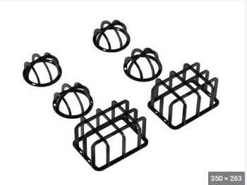

fabricate them... somthing like this below

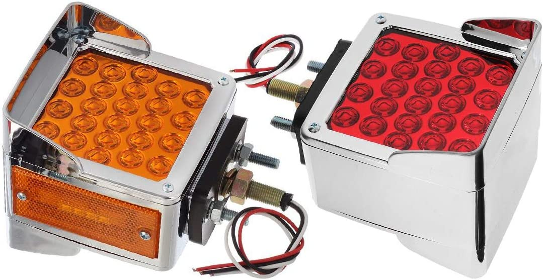

I was always busting off those cheap plastic OEM fender lights while mowing the tree line. I used to keep a couple of spares around as replacements. A few years back, I installed these:
There're plastic but much stronger than the OEM factory lights. So far, they've held up well.

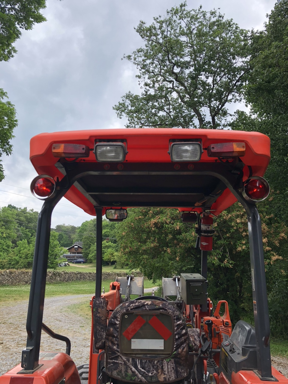

I picked up guards for my Kioti from Paul and Kathy at Specialty Repairs Custom Mods and have been quite happy with them thus far.

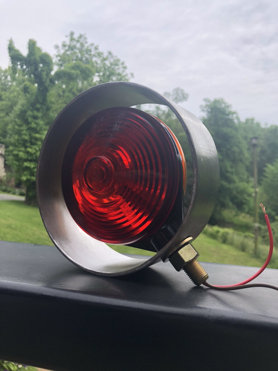

$6 piece of SS tubing. Cut with side grinder. 1/2” hole for stem. Does take more skill to drill stainless. Made set for me and set for friend. Still have some stock for more or maybe a cup holder.
