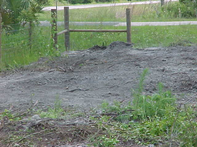

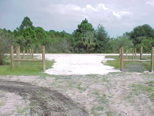

We fenced the perimeter of 7.5 acres -- my 5, and the 2.5 of my daughter, next door. We used hog wire (4" x 4" mesh) rather than no-climb, but we don't have horses. It's primarily to keep my dogs in and the 4-wheelers out until the house is built. Hog wire is only $78 per 330' roll at TSC, so that part was cheap.
We used the 3" roound wood posts from TSC for all the intermediate posts, and made the corners from 7" round. The key is to do the corners strong enough to really crank the fence tight. If you radius the corners, I'm not sure what you're going to be pulling against.
Attached is an early picture of our driveway opening (it will be landscaped) that shows the corners. As you can see, each corner consists of 3 7" posts in an "el" configuration, joined with horizontal 3" posts. What doesn't show up in this picture is the heavy wire diagonal loop, running from the base of the corner post to the top of each outer corner post, and twisted tight (like a turnbuckle) above and below the horizontal. That locks the enitre structure together. Each horizontal is held in place with 12" long spikes, sold by TSC for the purpose, that are driven through the 7" verticals into the ends of the horizontals. TSC also sells a coil of the heavy wire for the diagonals. The wire is held in place on the posts with staples. You stick the handle of your fence pliers (also from TSC) into the loop and twist until the diagonal is stretched really tight.
Once the corners are done, strip back the horizontal wires of your wire mesh fence so you have enough to go around the 7" post and back to itself. Wrap each loose wire around itself and twist tight, like tying a twistee on the end of a garbage bag. Also put a couple of staples on each wire.
With one end of the fence securely fastened to the reinforced corners, unroll the fence, and clamp the other end to a pipe, 4x4, or a special fence puller clamp sold by TSC. Attach to your tractor and pull that baby REALLY tight. We got it so a significant portion of the fence at each end was standing upright by itself from being so tight, and the middle part was like a drumhead -- it was easy to stand up against the intermediate posts and staple. Like you said, the intermediate posts are really just to hold the fence vertical -- the real support is from the corners, which is why they have to be so strong.
When the landscaping is done, I'll trim all of the posts to be a bit higher than the fence. At the driveway, I'm going to use 3 horizontal 1x6 boards between each post for appearance.

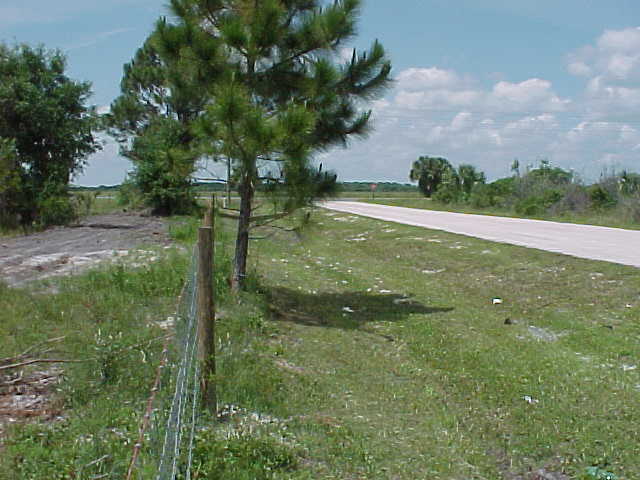

Finally, here's a shot of the fence between the driveway and the corner pictured above. We used the wood posts spaced approximately 12' apart, and it makes a nice looking fence.
