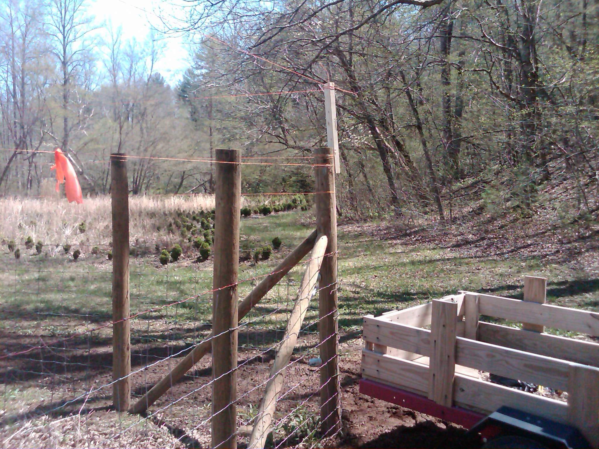

I have tried the string, two string and electric fence. I had scarecrows, buzzers, Mylar balloons, soap, perfume, hair, etc to keep the deer out. Then someone told me to pee around the fence and the deer would not come in. I peed so much around the fence that when I would get near the produce section of the local grocery store I would start to unzip my paints.:laughing: Everything would work for a while then they would mow it down. I grow 3-4 acres of produce and have seen 20 deer in the field at one time.
The electric worked for 2 years but then they started coming in. You could see the ground torn up where they would pace around before jumping or going through it.
I finally fenced the whole 4 acres with standard field fence. Put extensions on the corners, gates, and Tpost. PVC on the Tpost to extend to 8-9 foot, I then took bailing twine and strung around the top. Usually two rows and tied survey tape every 5-10 foot. It has been several years now and not one deer has tried to jump it. And this was cheaper than buying 8' deer fence.
Now if I can just control the ground hogs!!!:D
