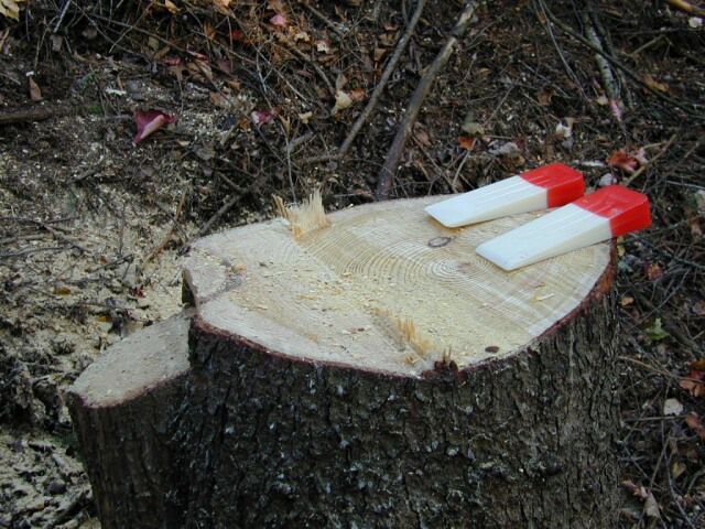

Well... I did it /w3tcompact/icons/grin.gif. I'm sure to others this is no big deal, but to me it great to have an out come with something that I knew little about. I got the tree to go exactly where I wanted it too. I did use the wedges (2 of them), I got the plastic type. The tree was leaning slightly opposite the direction of the fell and the top of the tree had more branches opposite the fell. I could have done a little better on the notch and back cut. The bar on the saw was about and inch to short, I thought it would make it. The cut was needed to be made almost chest high, next to a very large rock and uneven ground. The only route was to fell it one direction. Any other direction and it would have most likely gotten hung pretty badly.
Attached is the picture of the stump. You can see the thicker hinge on the far side of the picture compared to a smaller hinge on the closer side of the picture. The wedges are shown but not in the position I had during the fell.
QUESTIONS-> Should I have used one wedge instead of two? Also is there anything else wrong with the front cut and bcak cut shown on the stump? I know it should have been more level on the back cut and the hinge should have been more even across, correct?

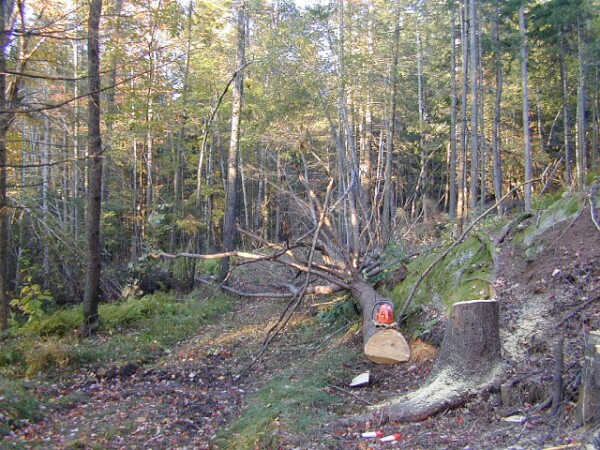

A shot of the whole tree on the ground.

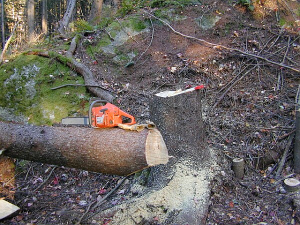

A shot of the butt and the stump next to each other. Gives you a better idea of my not so perfect notch and back cut /w3tcompact/icons/crazy.gif.

Nice work Derek, as I said the wedges are key not only in felling but in bucking as well. Cool when you can make that tree do exactly what you want it to isn't it. But please and this goes out to everyone---BE VERY CAREFUL WITH A CHAINSAW!
Now to your question about the notch. Yes it needs some practice. Your backcut was a little low, but you already know that. But then again that is how you become better as something-with practice.
There are alot of things that you can do with both the wedges and the type of cuts that you make in steering the tree during the fall. A full open face will give you the best steering, all the way down if that is what your looking for--safety.
