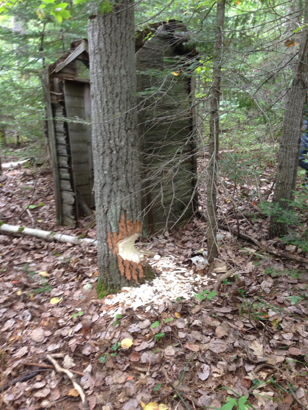

Actually you should be more worried about the poplars than you are. They are very split-prone. I had a friend helping on my property have a close call with a barber chair on one that was perfectly healthy. And is is VERY experienced in logging. A lot of times they are not as they rot easily and not always visibly from the outside. You can start cutting into one you think is perfectly fine, and partway in - zip! the saw moves fast all of a sudden as there is no wood in there. Poplars I watch like a hawk when felling. They make me very nervous. If I can, and especially if they are in a bad place, I will take them out when they are small and the risks are lower. No sense letting them get big as they just rot and snap or fall over early. Poplars are forest weeds. They grow fast and early in a forest and then die off when the slower growing stuff takes over (Oak, maple, cherry, etc)
Yes, Poplars are NASTY things, and I exterminate them. whenever I can. Unfortunately, the beavers love them, so I had to be Rattek this fall whereby they started cutting down every popular they found near my boat house. Now I am faced with the task of finishing off about three or four monsters that were partially cut, and will fall on my boat house if they come down without my direction.
