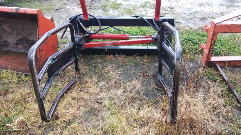

Are you using forks to stack those bales?? Curious what type of attachment you would use to minimize tearing the wrap??
   / FEL when using 3pt implements #45
We call em "soft hands" down here. Good for picking them up and the only real thing to remember is to maintain a 45° angle to the stack, which gives you the clearance you need without ripping the neighbors. You will notice the red bar- this can be removed allowing the hands to swing from side to side when empty but that slows things down a little, I find.

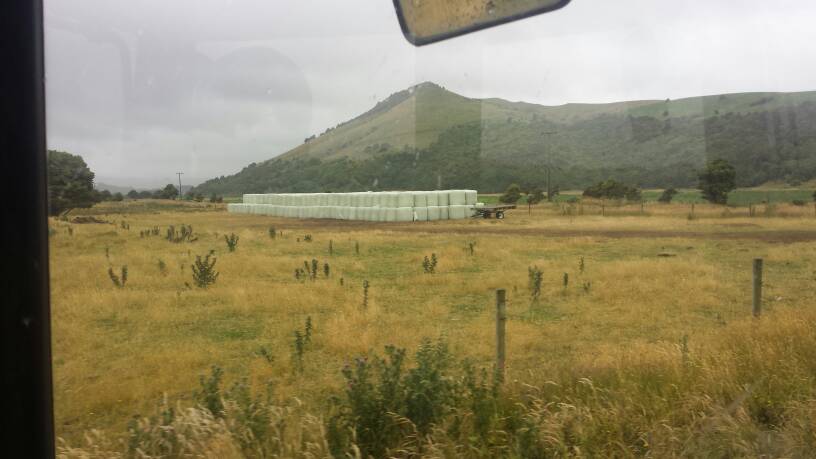

Yes, I used to work for a baling contractor, and most of our clients preferred the individual wrapped bales as they would place them out in their winter crop paddocks at planting time, and then cut the wrap off and move the electric fence. We mostly winter outdoors down here as our winters are reasonably mild. The only reason for so much wrap is to prevent punctures while transporting them, tube wrapped bales only need 2 or 3 layers to keep out the air. Without the double wrapping at the ends, maybe only used one-third the plastic. The big plus with individual is from the fact that it is better for capturing a surplus at the right time, rather than waiting for a large area to be ready for harvest. A lot of our clients would get us in 5+ times per year to bale up anything that got away on them, maintaining quality for the livestock. This is in contrast to the large area you would shut up for silage, which may actually reduce the intake for the stock.
We used McHale Fusion baler-wrappers as they were about the only proven comby at the time.. the boys came out from Ireland and simply could not believe where we were taking them, as steep as the farmer could mow with mower uphill and duals.. fun times indeed. Did about 60,000 per year per baler for 5 seasons.
A job stacking the other day, 420 bales and only ripped 3. Man loading the truck may have ripped 30 or so but some nice wide tape is fine if the plastic is dry.
I've been following TBN for ages but never said a peep, finally figured out how to attach photos so there may be a lot of 'education'

3 out of 420 ain't bad!!!!! :)
   / FEL when using 3pt implements #50
3 too many for Pete the Perfect. Just got in a rush and reversing before the bale cleared the gunnel on the truck deck. I'm a tough critic..
It only took a 5 hours to stack them, had 2 tractors loading 3 trucks at the other end and a one mile cart.
