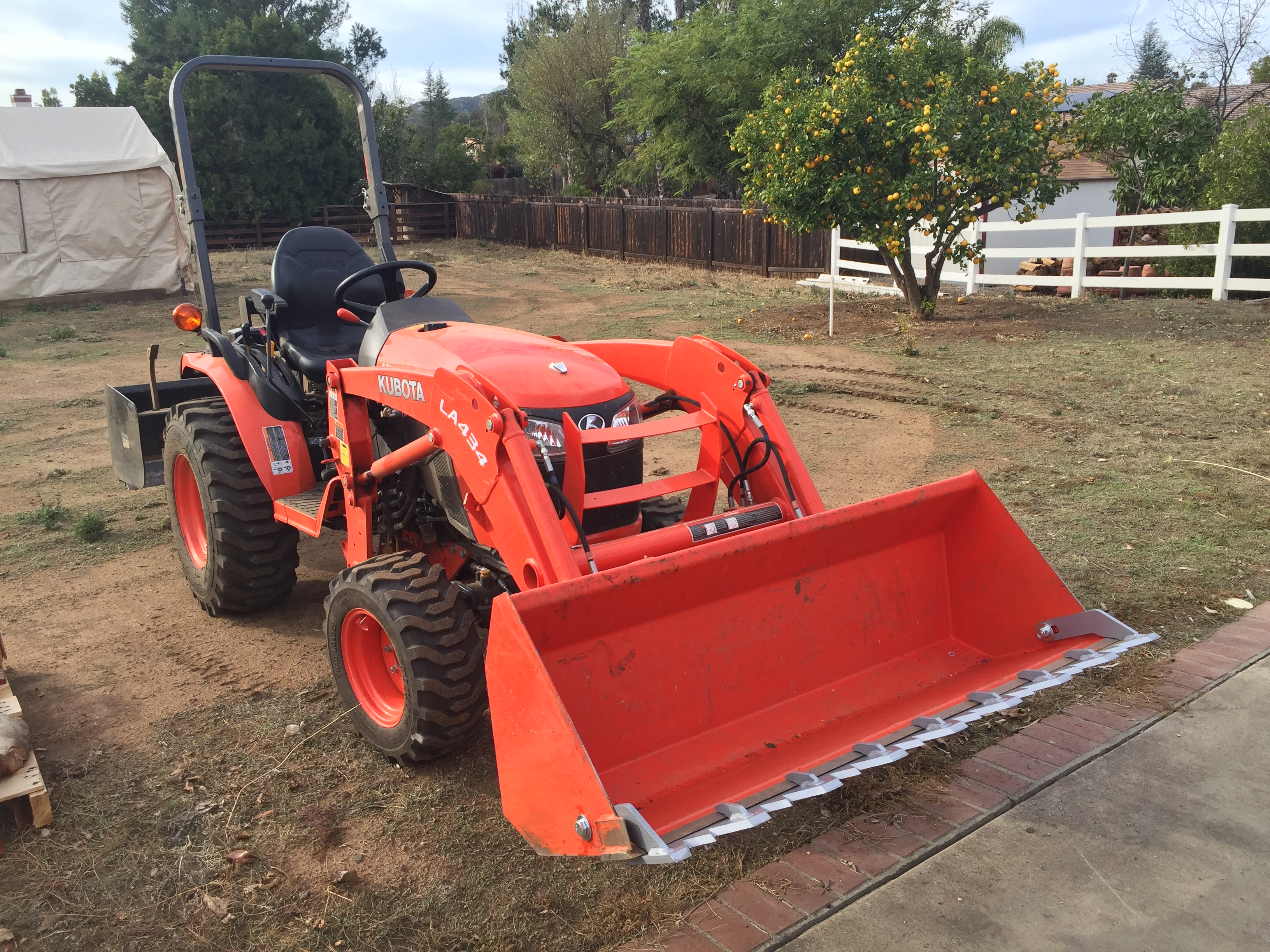

BXpanded Piranha toothbar. I bought one in 2014, put it on, and it's never been off.
Besides all the obviosu uses already mentioned here, I like using mine to cut through the bottom of my gravel road potholes just prior to my EA 8' grader blade smoothing the road over. With pot holes, it's not enough to just fill them in, they'll just reappear again as soon as someone rolls over it. You have to dig down tot he bottom of it and remove the compacted bottom. The BXpanded piranha tooth bar is excellent for this.
Good luck!

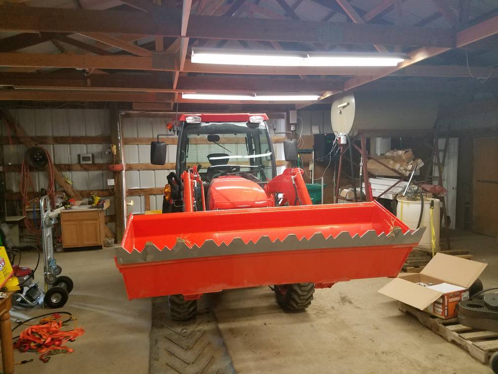

I put a Piranha bar on my Massey three years ago. For what I do, it is worth every penny. I've never taken it off. It improved digging in my clay-loam immensely. It really shines at brush removal, blackberries in the attached photos.
