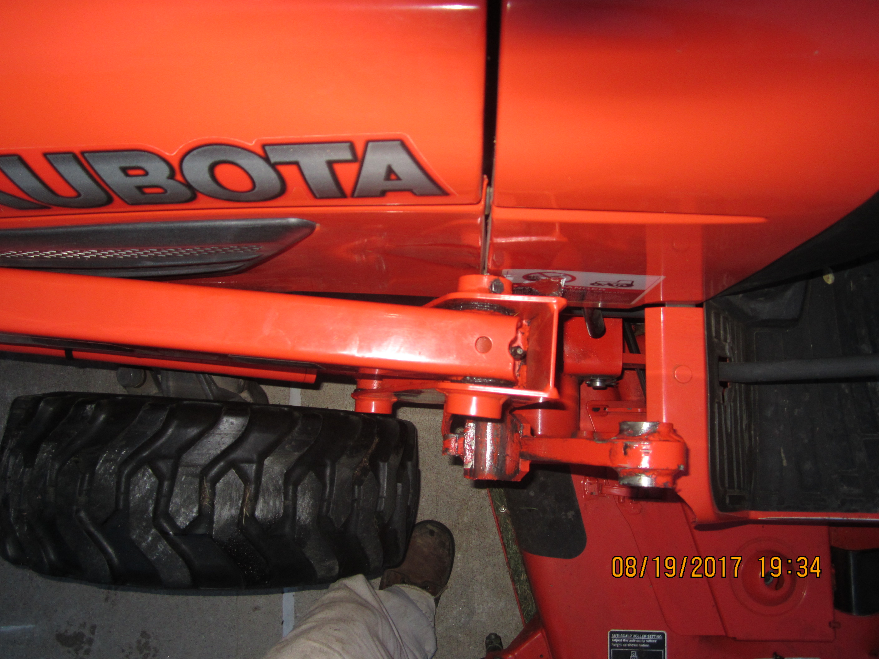

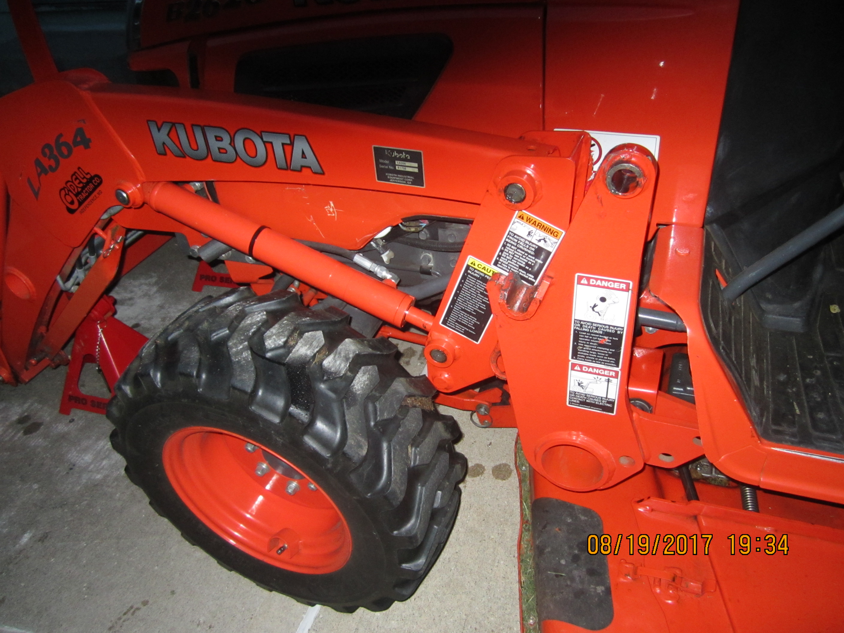

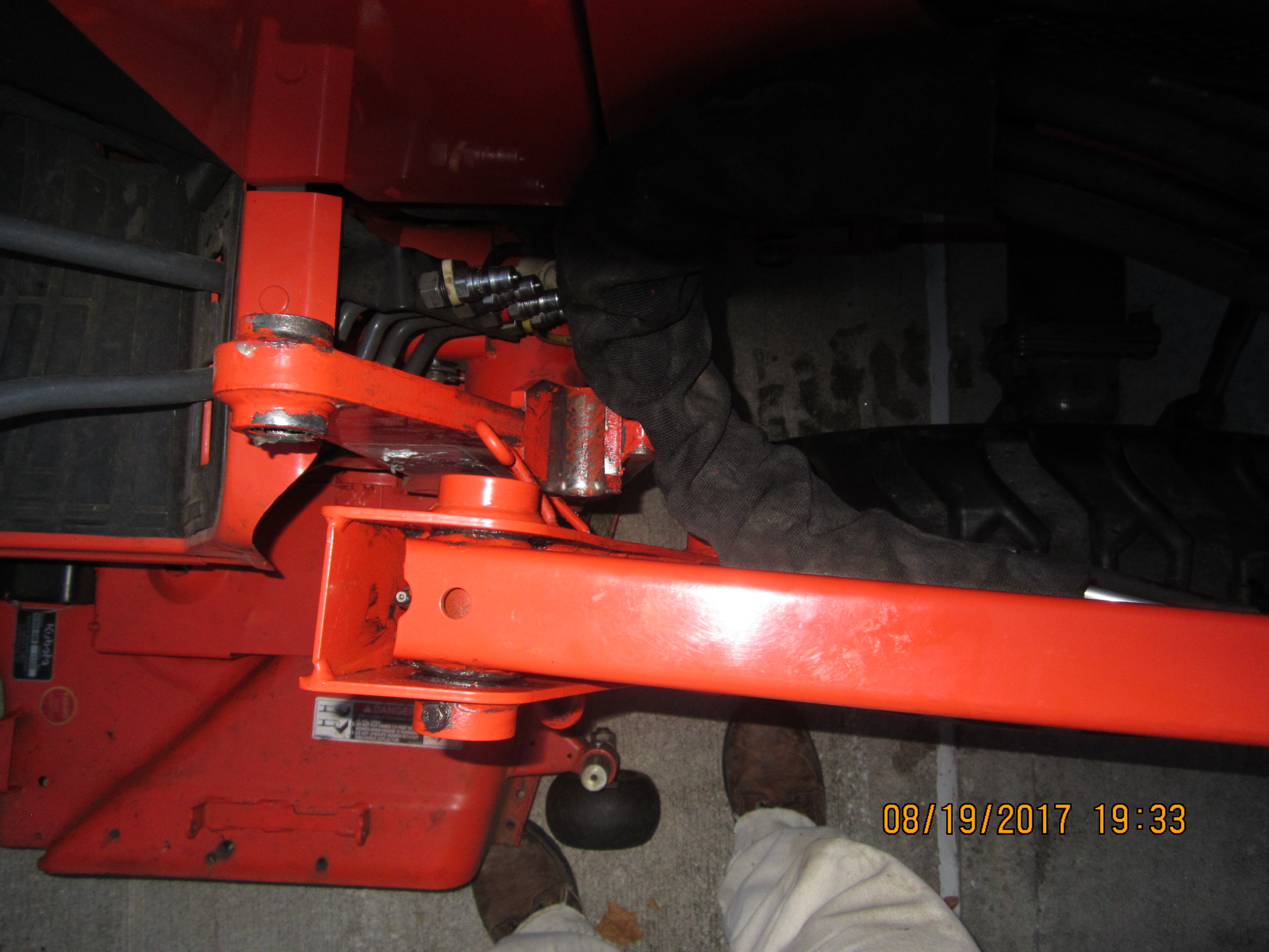

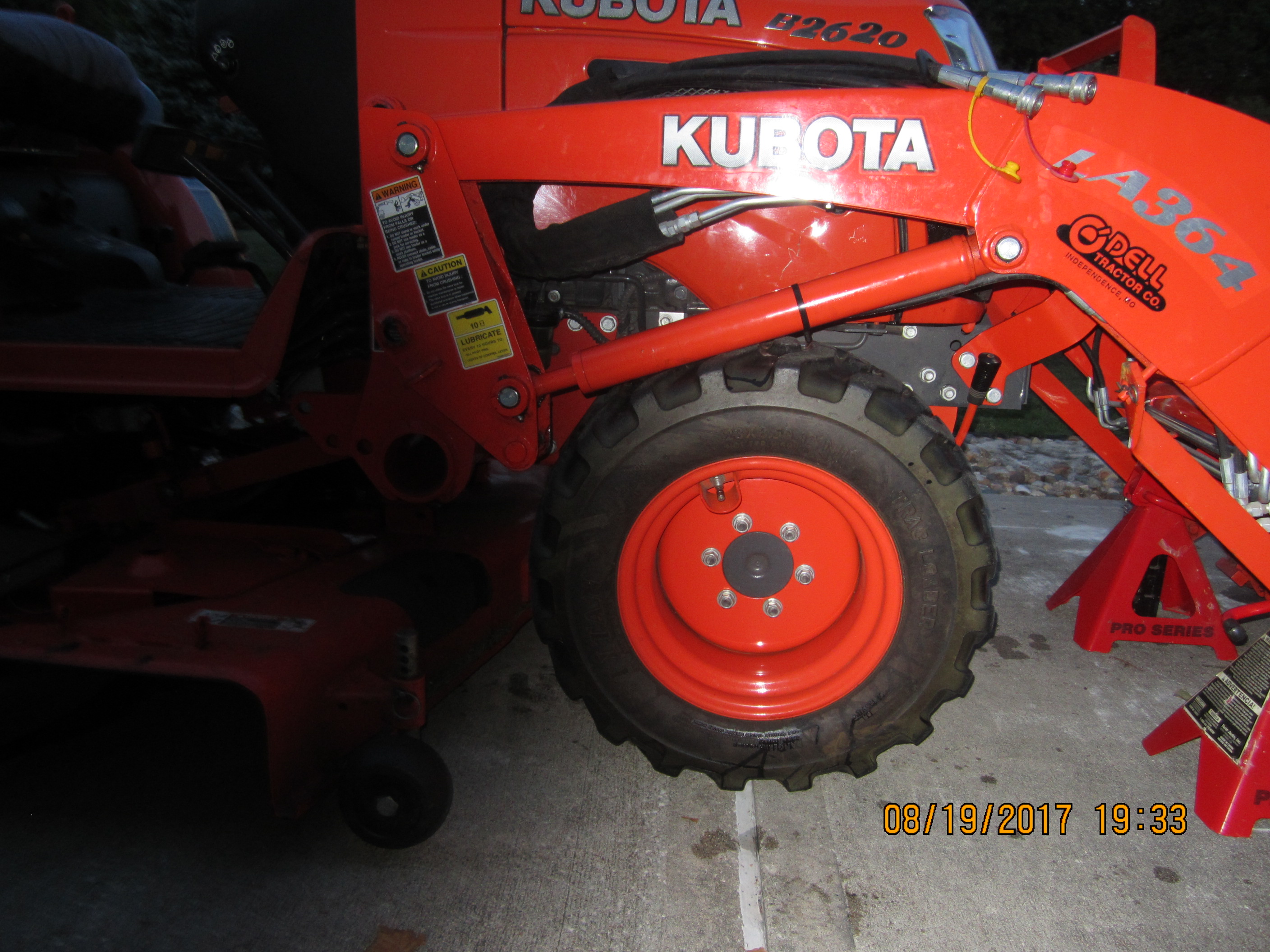

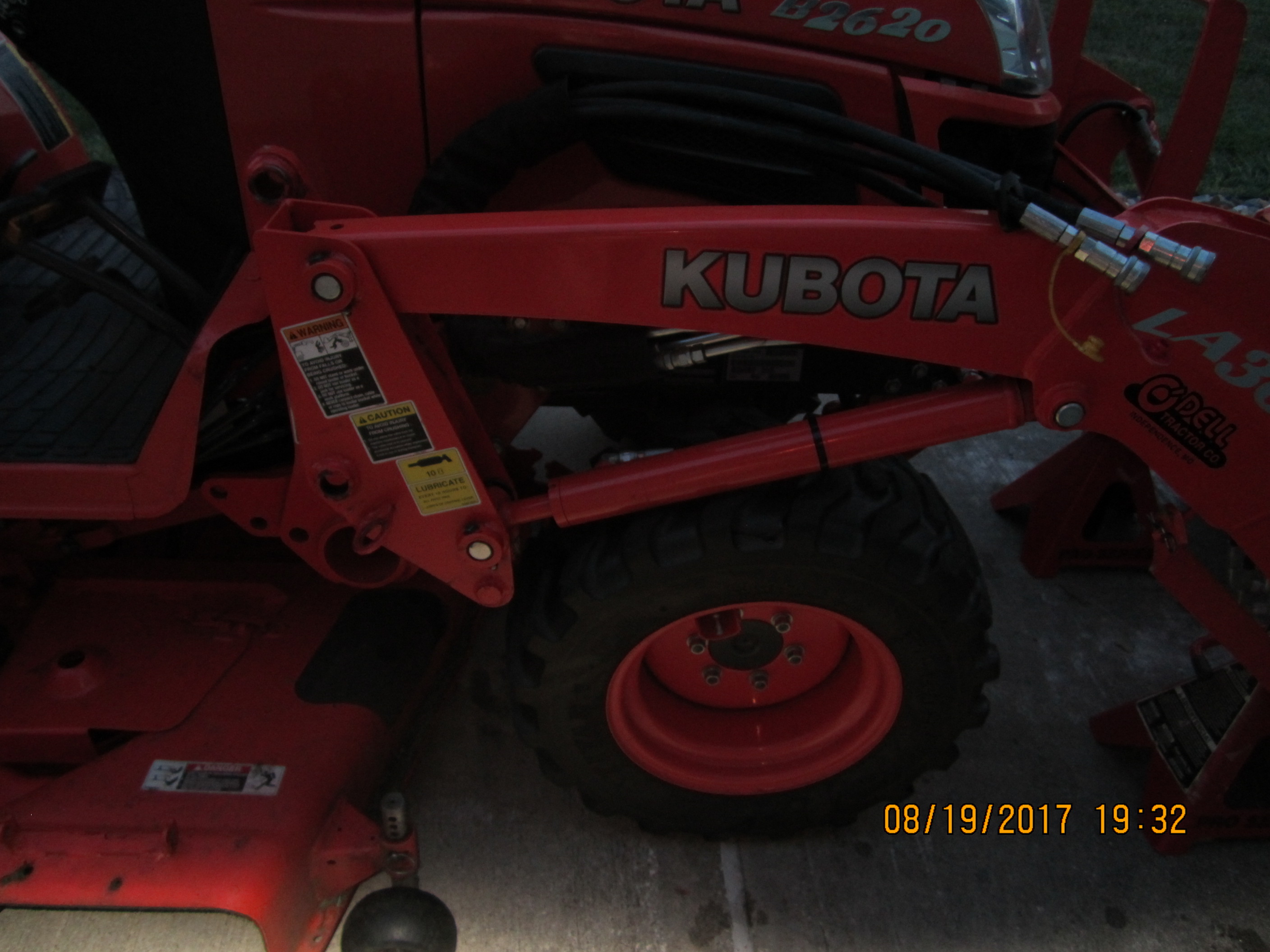

Well TBN'er, it doesn't pay to work when you are tired. After 5 years of owing/operating my B2620 and mounting the FEL as needed, I really screwed up.
From the pictures you can see that the FEL is collapsed on the right tire. I tried to get it up with the hydraulics but only made it worse. I gave up for the night. Anybody have any ideas how to detach the FEL from the tractor. I have caved in the right and left engine panels as well as the some of the front grill. I can't believe that I did all this damage......must be getting too old to operate the darn thing. Suggestions appreciated. 003.JPG004.JPG005.JPG006.JPG007.JPG

I think you are going to need some way to lift the loader arms off of the tractor from above so you can back the tractor out and lower the two parking stands down. One way to do that would be with another tractor and loader; another would be a tow truck. From the picture it at least looks like you are outside so maybe you can get access to it with other equipment. Another way would be to place enough weight in the bucket that the loader will stay planted flat on the driveway and use the bucket curl to raise the loader arms. There is a lot of weight in the loader arms so nothing is going to be simple, safe and easy... please be careful! Maybe your dealer will be able to help. Do you have KTAC insurance on it?
   / FEL Stuck...HELP! #3
Do you have an engine hoist or can borrow/rent one? Otherwise build a gantry and use a come along, wood would be adaquate. Luckily the loader isn't too heavy to lift from that end.
Out of curiosity, how did this happen? Was this during removal or installation?

Unfortunate, this situation is. The good news - you were not injured. I agree that the solution is to lift from above. Either some sort of portable lifting device or crane or build yourself a gantry. Also - get help from somebody who can be your eyes or operate the lifting device while you observe.
Other than the bent body panels - I think the situation with the FEL looks a lot worse than it will end up being when it gets separated.

No offer of a solution, but some advice. The panels are already bent, don't worry about bending them more as part of the recovery. Just watch so that expensive vitals under the panels don't become damaged. It may be necessary to sacrifice some additional inexpensive bits during the process. Most of all, be safe. Chain or otherwise support components to avoid sudden release as you begin to move things. Best wishes.

Honestly a couple fit guys could lift the arms without a problem if you have some friends/ teenagers etc. The B2620 isn't that big and the loader isn't really that heavy comparitavly.
You should be able to get the situation resolved without further damage.
A gantry is probably the best as you can lift both sides together, but not necessary.

Pull the top pin on the rear bracket and forward pin on lift cylinder. Should clear up some area for the arms to move.
