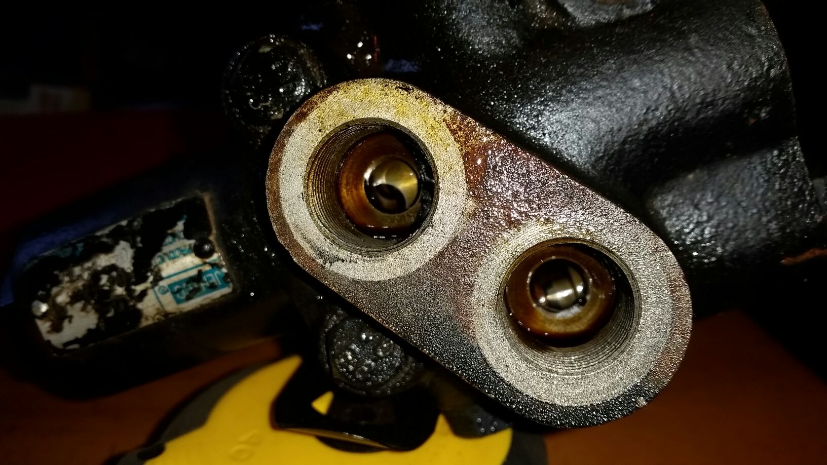

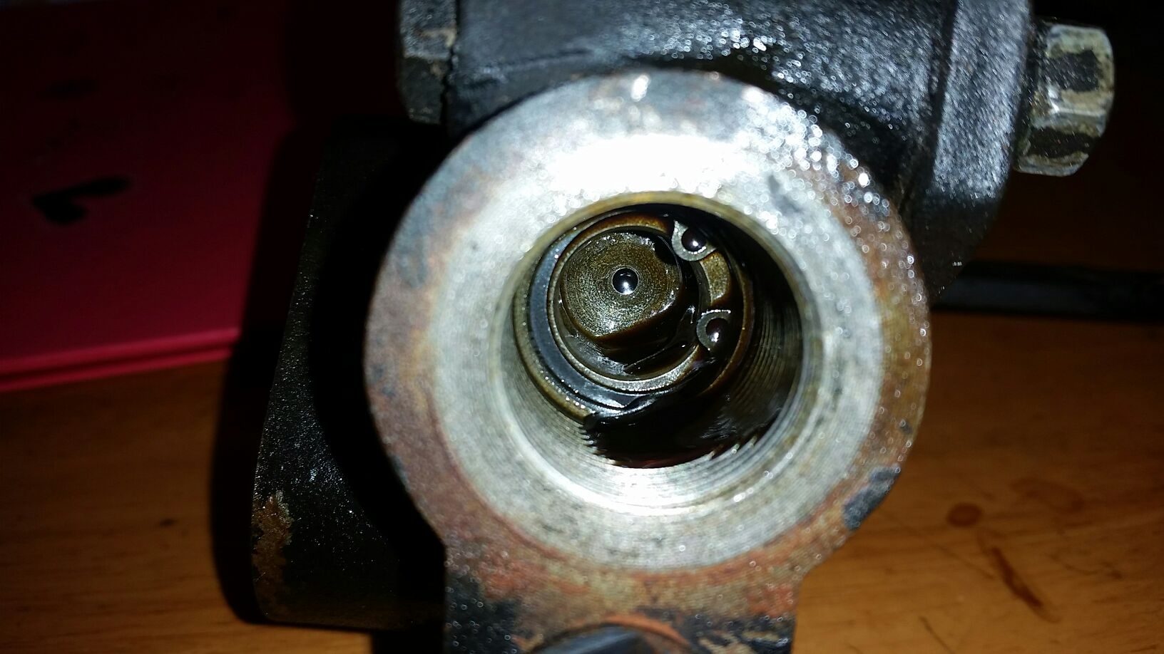

ive attached pictures of the priority val e ports. The big port with circlip is the inlet port from the loader control valve. The other single port goes to the rear 3pt lifter. The dual ports go to the steering wheel box. Im only posting the pics on the off chance anyone can see anything wrong when compared to a new valve. I probably wasted my time removing this.

Most equipment the steering would be first valve in circuit and then feed the loader and 3 point so that steering always has priority. Chinese tractor certainly could be different in design.

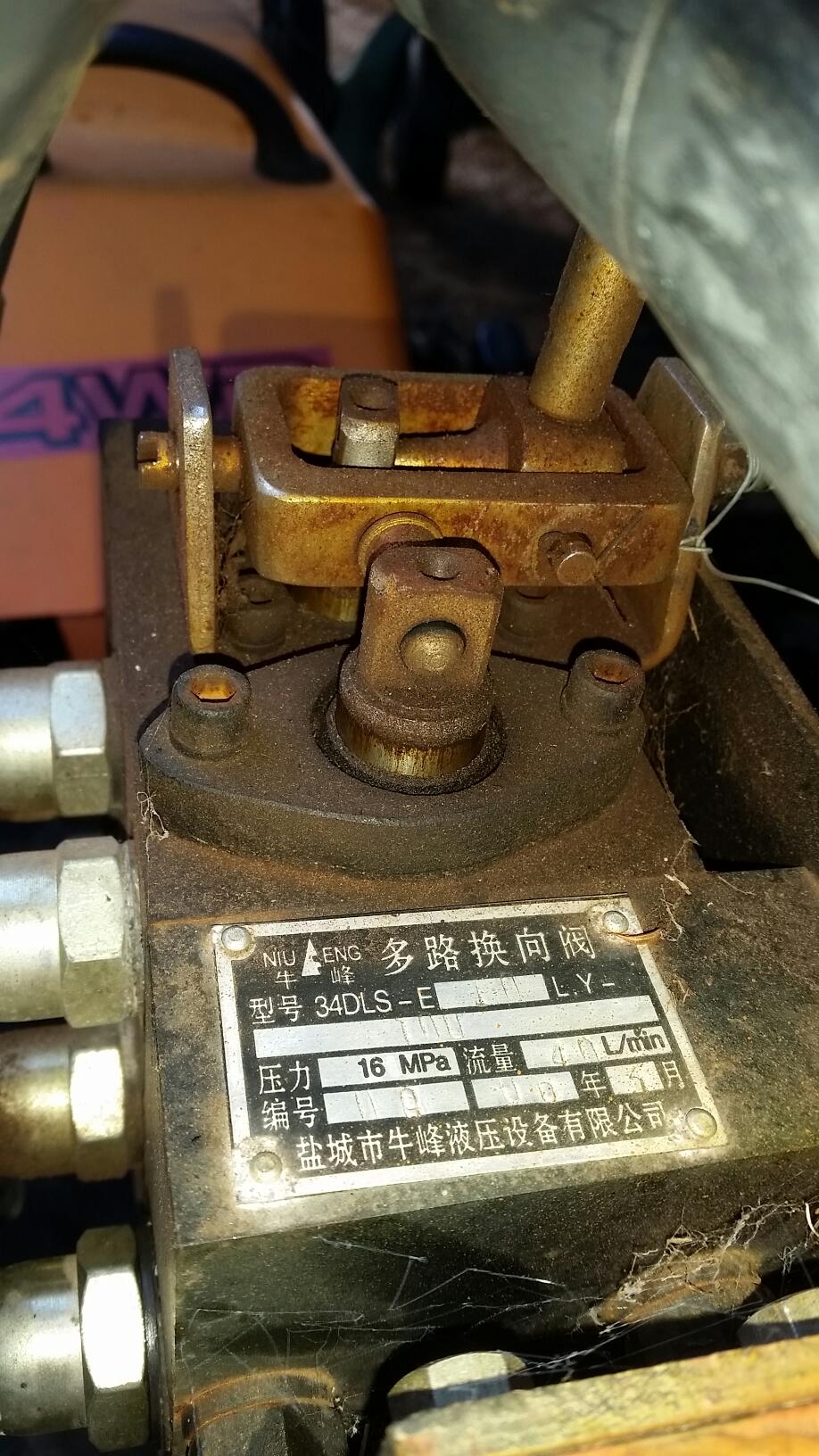

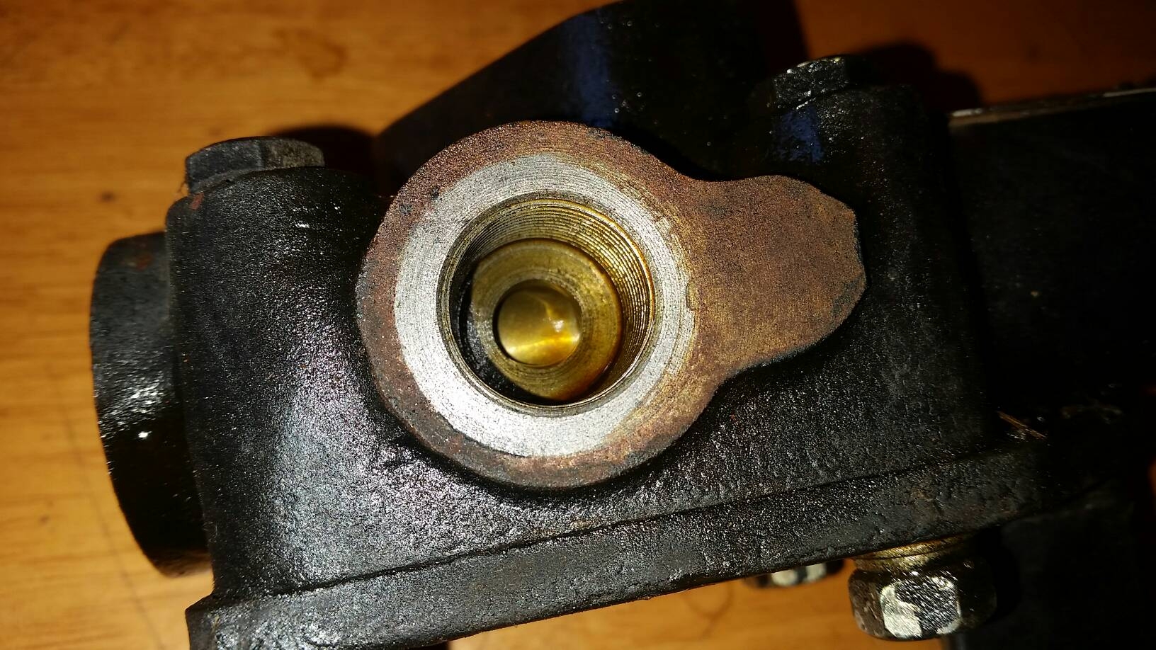

I should have mentioned that i think my FEL controller is the OEM. I have attached a couple of pics of it. Piper - you mentioned taking a crown nut off and checking if the adjuster has backed all the way off. Can you elaborate on that? I cant see a crown nut and not sure what and where the adjuster is.

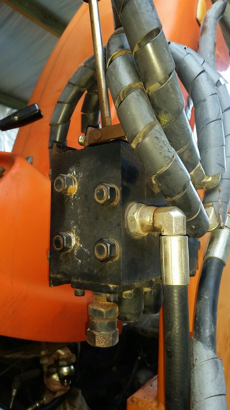

Sorry for the delayed response. I was able to find the old OEM loader valve but didn't have time to take it apart. Here is a picture of the bottom end.
I think the hex cap is actually the relief valve adjuster. There is a jam nut just under it. The whole assembly is held onto the main body with 4 cap screws. The other two dome shapes are covers for the spool valves.
If it were mine, I would start by backing off the jam nut several turns and then turn the hex cap. Put a mark on it and count the turns. I would try one or two full turns and test. Never having had one apart, I can only imagine that there is a spring inside that holds a pop-off type valve against a seat. adding spring pressure will increase pressure available to the loader cylinders.
If a couple of turns does noting, then I would back the cap all the way off and see what comes out. Do this carefully as it is likely to fly apart under spring pressure. Also lay out the parts in order so that you know how to put it back together.
The first things that come to mind are a broken spring or dirt under the seat of the valve. Next to check would the the valve face and seat are worn and leaking. Spray some brake cleaner or even WD-40 up into the seat to make sure it is clean. Re-assemble and test again.
Since both sets of cylinders are working, it is unlikely that the problem is in the spool valves, but not totally impossible.
You asked about using a pressure gauge. Putting one in the system at either quick connect will only show you the pressure of the system that is controlled by the relief in the 3 point control. To test the pressure to the loader cylinders you would have to tee into the lines that go to the cylinders. Jinma has used different style fittings over the years and you can't tell which one it is until you take them apart. Finding adapters might be pretty difficult.
Remember, the fluid only passes through the open center on it's way back to the tractor unless the loader valve sends it to the loader. The loader relief sets the working pressure for the loader cylinders (up to the limit set by the 3 point relief) and acts as a safety relief for when a cylinder bottoms out,
