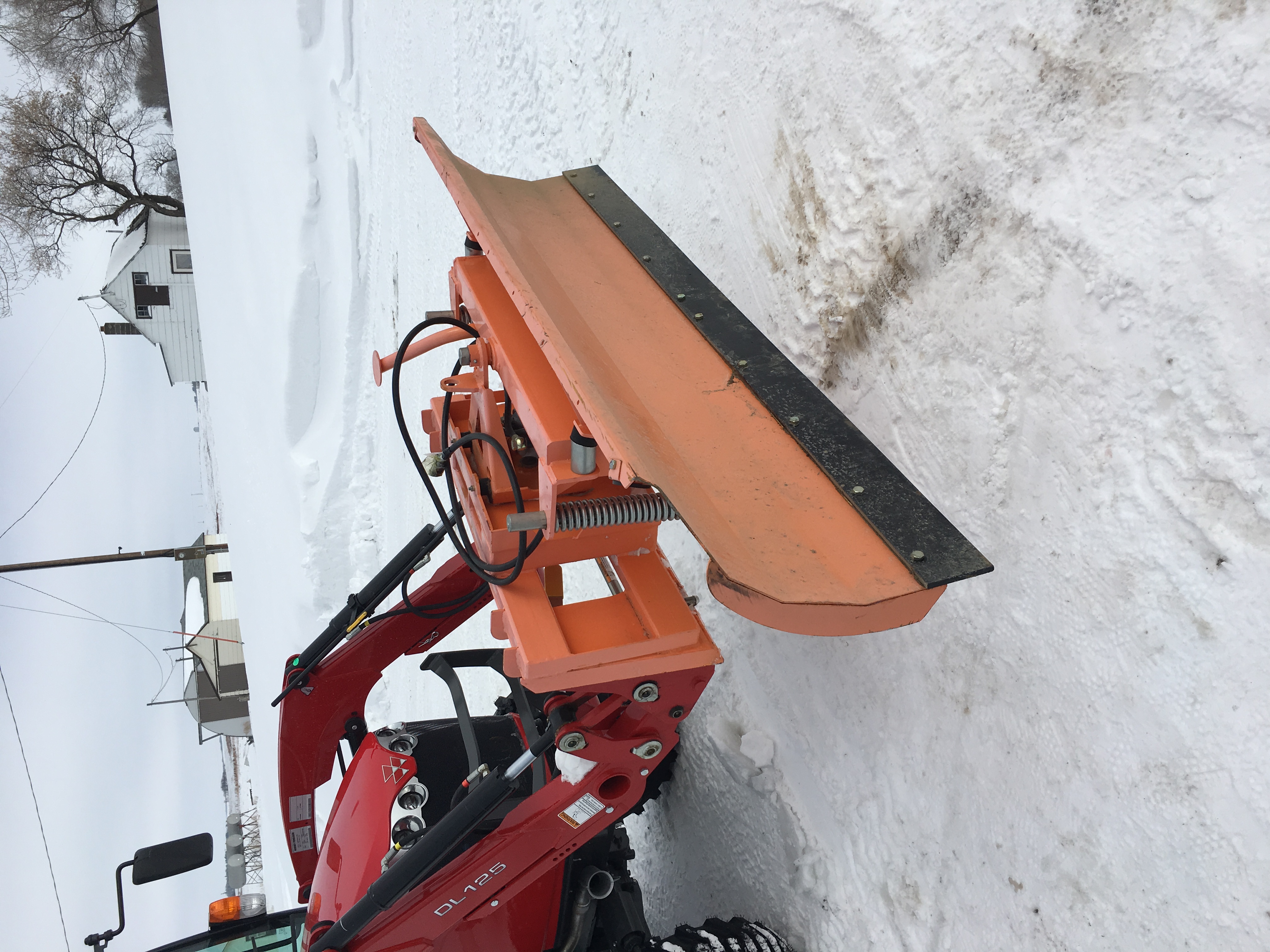

About 2 years ago, I think, I was thinking about getting a FEL snow plow. One of the big issues was that in order for it to articulate 'Right/left', they typically are pushed WAY out front, which is even further than the regular FEL.
As I was investigating, I happened upon a guy in either Northern US or Canada, who was building them with his own design which put the blade much closer to the FEL. I don't remember much more about it, but I believe he also designed it to be self limiting on down pressure from the tractor. He had a YouTube video and a website which was pretty obvious (I believe) that he was building snow plows. ie "snowplows.com" kind of address, (I could be absolutely wrong on this memory and it could have nothing to do with snowplows) but 2 years later, I haven't been able to find either his YouTube videos nor his website. (Apparently, I failed to save either... which is very unlike me, but I can't find them, so my assumption is I did not.)
Anyway, Anyone have any links to someone doing this? They guy, if I remember correctly, did other custom machine/steel work. His videos were NOT overdone, just a guy talking about his snowplow. But, I seem to remember I really liked the thought and design, but the price was a bit steep for me at the time.

A frequent poster on here made one with a design that he (aptly) termed "under slung". perhaps if you search that word/phrase, you'll find it his thread.
The lazy way to take a truck plow and adapt to a quick-tach plate is just to use the original plow mounts right onto the face of the plate. But as you note, this puts the blade way out front. So you have to hang the plow assembly under the Q/A plate a bit instead, can easily shave a foot of length off. I can't wait to make one myself someday once I get a) a new tractor with Q/A, and B) a welder.

There are a lot of ads around here for a China made plow with a single cyl running parallel to the blade. I have one, faily close to the loader arms. Priced around $ 1200 cdn. Weighs in at 560 lbs, IIR, seven ft. Minus 25c here right now , don't really want to go out to measure. Listed on kiji Sask, will being up a pic. Prob same thing sold in the US somewhere.
   / FEL Snowplow closer to machine... I once saw a video... #4
   / FEL Snowplow closer to machine... I once saw a video... #5
Yahoo, it worked !!!!!!!!!!!!
