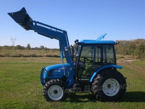

I googled your machine and (assuming it has the LS loader) it is mechanical SL. From the pics I saw you should have lots of curl. Did it originally have curl and now it doesn't? According to the LS website you should have 46 degrees dump and 35 degrees rollback. If you measure the angle between full curl and full dump how much rotation do you have?
Maybe you don't have the correct bucket for this tractor? If the back of the bucket is not at the correct angle to match the loader geometry then this could create the problem you have - actually you would have too much dump and not enough curl.
Since it is a new machine don't you have warranty?
Here is a pic I borrowed:
