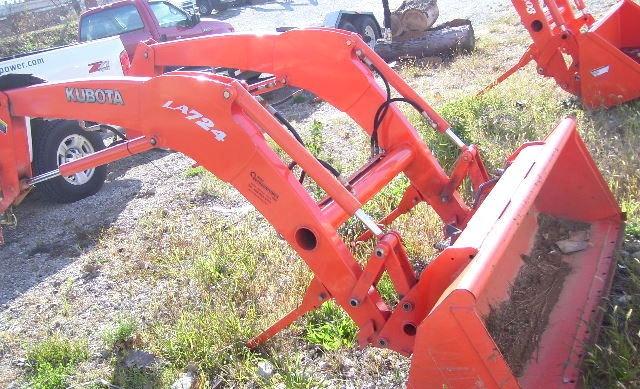

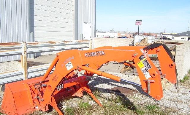

It is really and easy job to dismount or mount, maybe 5 minutes each. Make sure your lines do not have any pressure in them when installing or removing, or they will be hard to seperate. Once took my loader off on a cool night and let sit outside. Next day was warm and sunny, could not get hydraulic connectors to mate because sun had raised pressure in loader lines, had to bleed off pressure. FEL has stands you know. Philip.
