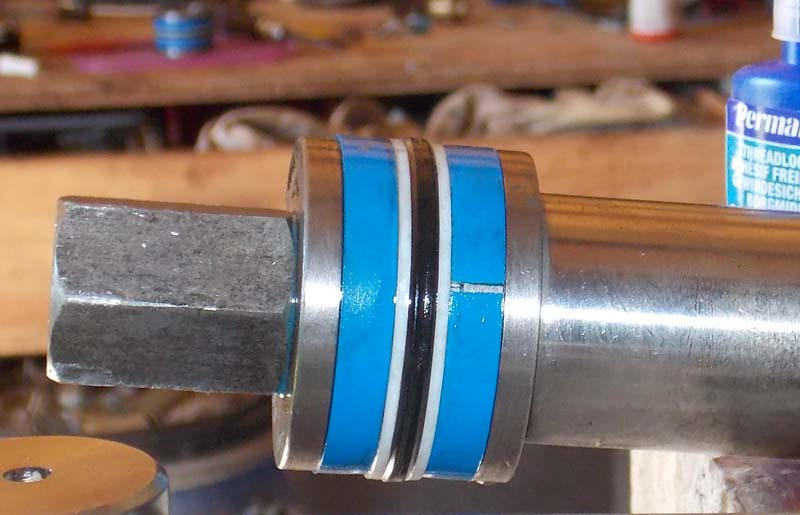

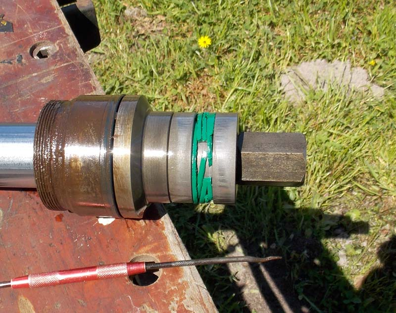

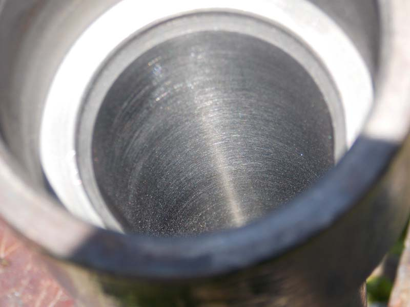

First, I replaced the main cylinder seals and pistons.
The seals weren't looking good.
The bores were already honed slightly oversize, and by the time I finished getting all the scores out, they were even bigger.

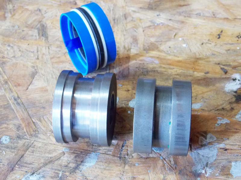

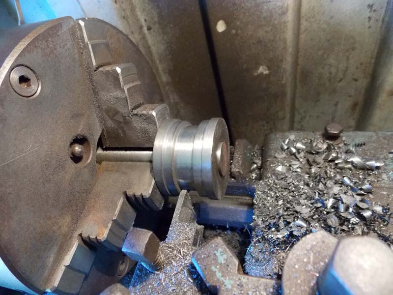

New style seals come with plastic bushings to protect the bore, so I made new pistons to accommodate them, slightly oversized to compensate for the increased bore.
This is actually easy work, great accuracy not required.
I engraved the new seal number on the piston, for the next guy.
The old pistons can't have been original; they're a tiny bit oversized too, the bore was once 2". And the center bore is a bit eccentric, highly unlikely if factory made.
Even though the increased diameter is minor, 0.4mm as I recall, the gap in the plastic bushing is obvious.
After reassembly, the FEL held position much better, and after I changed the spool valve block it's really good.
Not bad for 60 year old material!

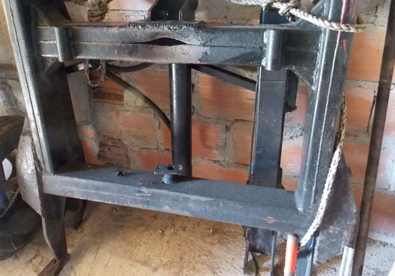

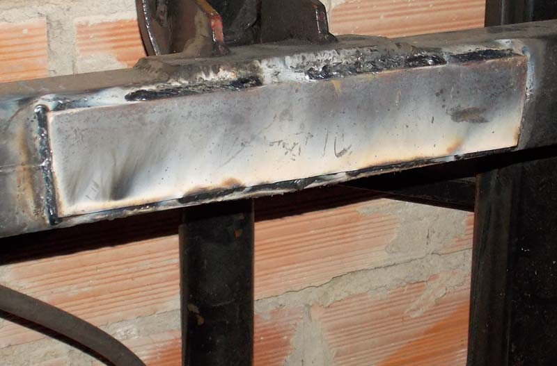

This is what happens when you use your old FEL frame to pound in fence posts.
My tractor gets abused, then cherished with love, new plate, and welding.
The only strip I had that was wide enough is 10mm thick; so I'm all set for pounding in more fence posts should the need arise.
I made a sort of cap that sits on wooden fence posts to prevent splitting while pounding, 2 steel plates with a 1" thick plastic buffer between them. It works ok.
Not perfect, buy ok.

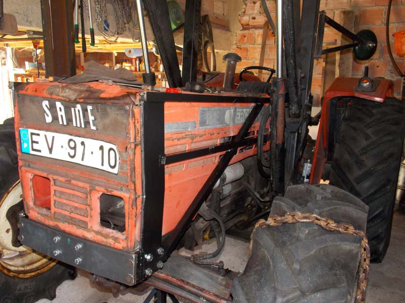

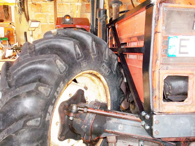

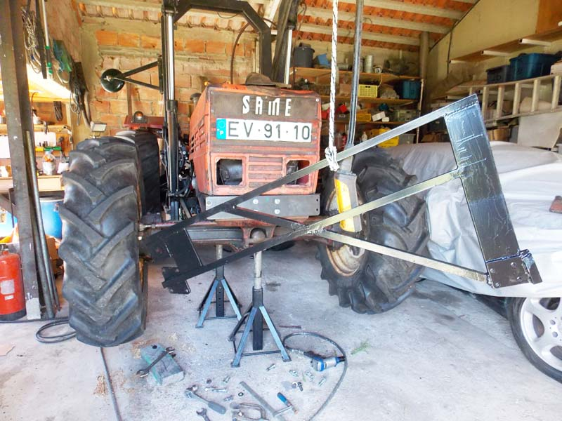

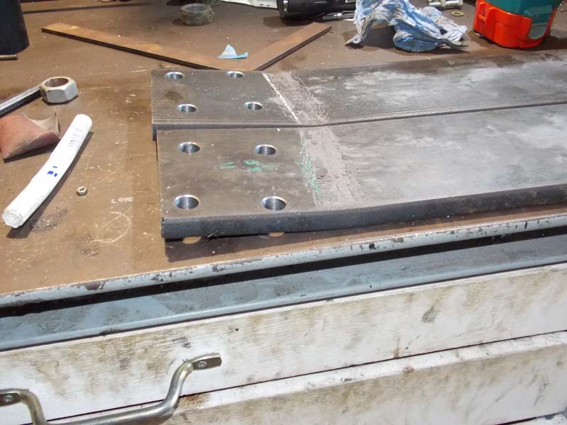

The FEL came mounted on the tractor, and basically doesn't fit over the large front tires. Or between them.
When the front axle is angled, steering was severely limited.

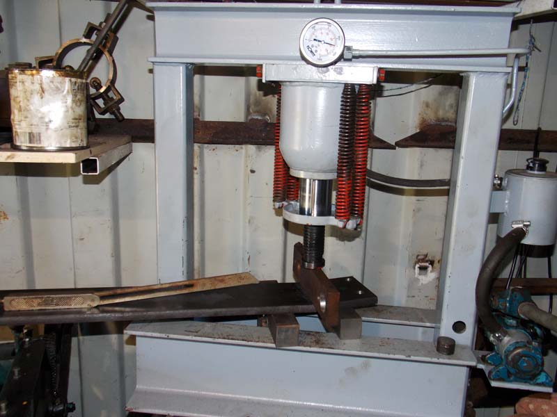

First I bought a length of serious strip, 15 X 120 mm. It only comes in 6 meter lengths, but I'll use the rest some day.
It had to be bent, and my home made press was able to do it, but it took all the pressure it has,
Frame bolts are 14mm, not a common size.
Next I made new pivot pins, threaded, and hardened because I felt like it and the material I have is made for that.
I heat them red, drop them in a bucket of water, and then temper in an oven at 500C.
The big ones are for the main pivot, 30mm thick. The other ones are for another job.

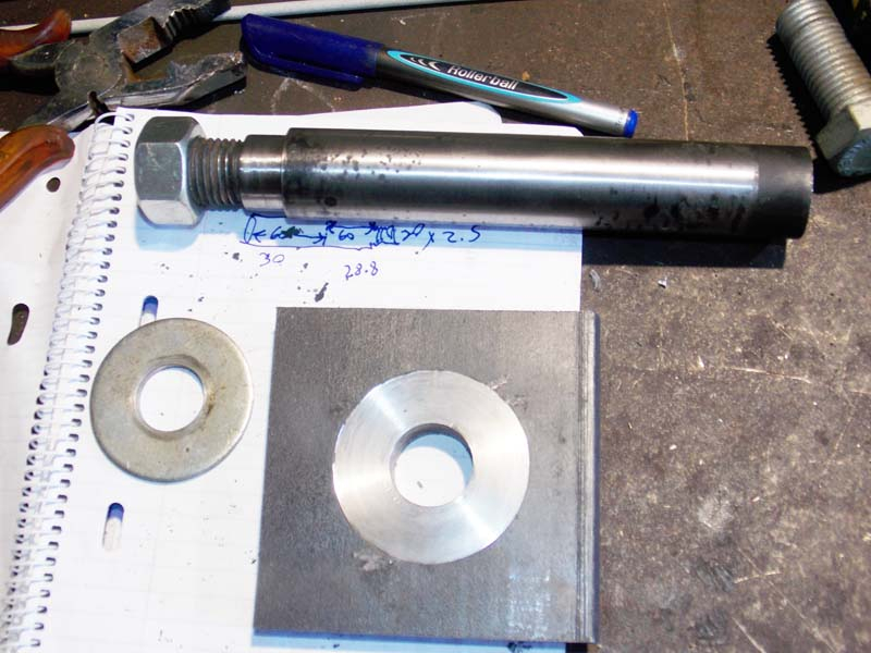

After a light polish, I bored out these plate bits to fit.
Next is the rough work; frame sections made from 30mm solid square bar.
They're not too heavy to carry by hand, but are far easier to fit while dangling on a rope.
On the bottom right is the tricky part, a receiver for bolts that will pass through the front plate I've attached to the tractor already.
The rick it to bolt up the parts, then weld them together, remove and complete the welds while hoping they don't warp too far to refit.
Tire clearance is now ok at full lock and tilt.
I still need to make a front grill; I want it to be hinged to tilt forward with the old engine cover attached.
And there will be lights, protected behind strong SS mesh.
The FEL arms still interfere with the steering when they're lowered, and I haven't thought of any reasonable plan to solve that problem.
It's rare that the arms can't be simply lifted out of the way with a pull on the lever, so I'll probably just live with that.

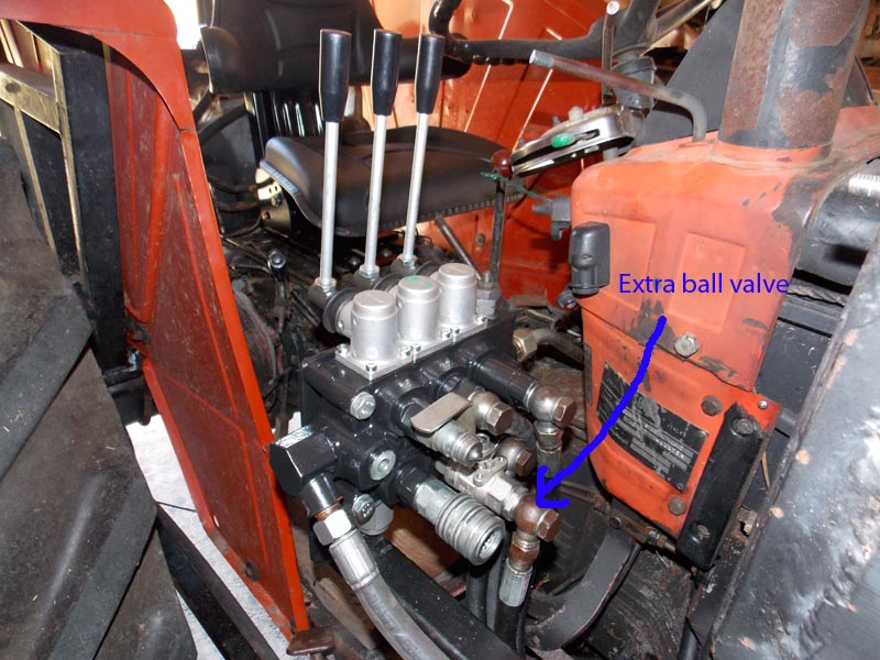

And another update, because I'm housebound today.
I replaced the hydraulic valve block.
I bought this block from flowfit in the UK before Brexit cut us off. Good material for good prices.
The old one leaked internally, and was a 2 bank.
I wanted to rationalize the plumbing, because the way the old one was done was to interrupt the tube at the original rear block, with a hose running forward and another running back. 4 or 5 feet of extra tubing.

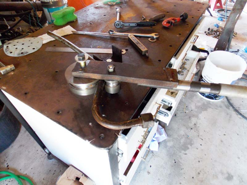

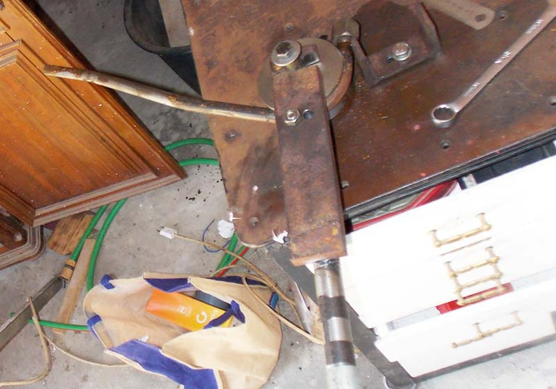

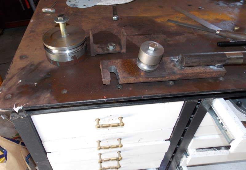

So my first job was to make a tubing bender. It bolts to my workbench / tool box.
Not my own idea, I saw one like this in a workshop in India.
This is 18mm steel hydraulic tube, stiffer than some but still hand bendable with a decent lever.

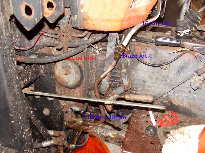

To get around the clutch pedal, it needed some extra curve.

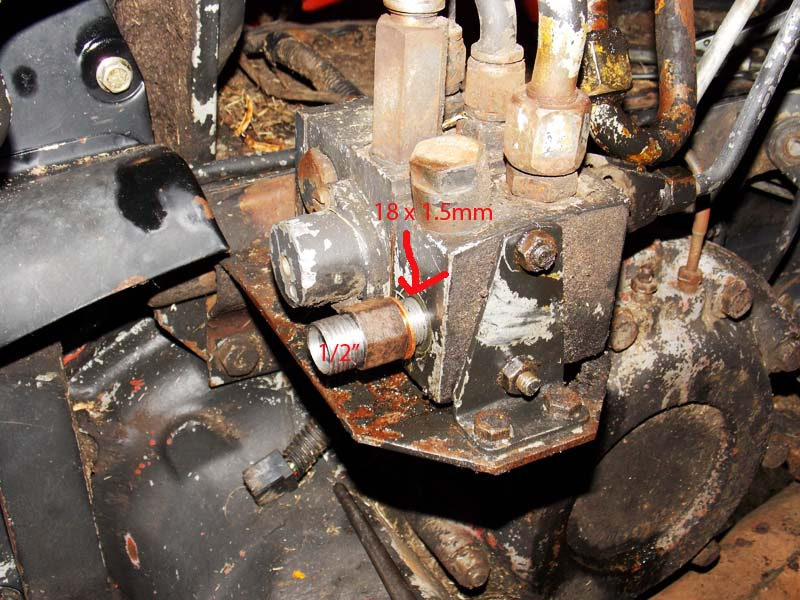

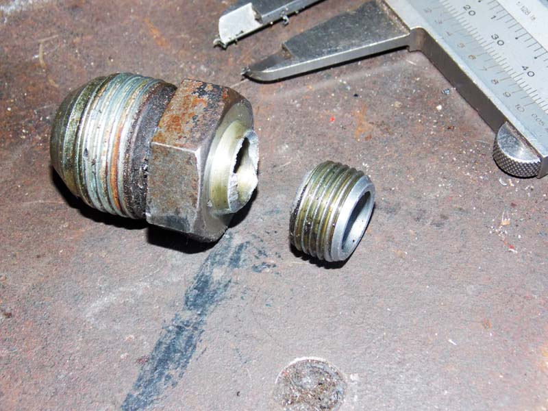

Stupidly, I broke this rare hydraulic fitting.
It took a couple of hours; I bored it out, brazed in a piece of rod, threaded and bored it. I like this sort of work, it makes me feel clever and compensates for the dumb feeling of dumb mistakes.

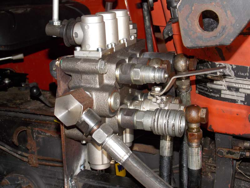

The original SAME auxiliary valve block is actually inadequate for the flow, even before I upgraded to a larger hydraulic pump.
Also, the fittings aren't available here, so I made an adaptor to fit the type my local tractor shop uses. He makes up hose sections for me fast and fairly priced, and he's just a few miles up the road too.
I made a bunch of fittings, which was silly really; they cost nothing but took nearly an hour each, when I could have bought off the shelf for 6 euros.
Except the end one, 3/4" male to 1/2" female custom elbow.

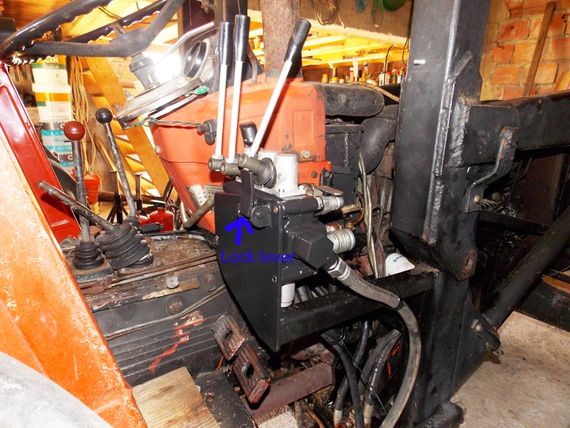

I put the extra ball valve that I used on my old valve block to hold my hedgecutter up, but actually this new block has so little internal leakage that it's not necessary. And it leaks just a little through the gland, so I'll be removing it during the next hydraulic system upgrade, when I'll be adding a priority bypass valve for the 3-point lift.
As you can see, there are quick couplings on the outer bank. That's for my hydraulic hedgecutter that needs continuous flow, so I made a little lock toggle to hold the lever when that machine is used.
