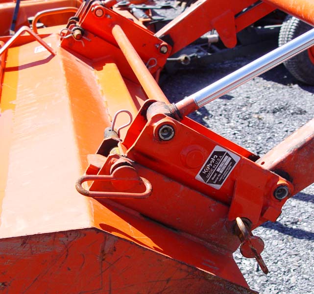

I ordered my B3030 with a quick coupler BL1767 for the FEL but I read on TBN that there's another quick coupler available: B2365. My dealer didn't inform me about that second one. /forums/images/graemlins/confused.gif I'd like to have more information on this B2365.
BL1767 fits a LA402 FEL... Of course, if possible and if there's a new model of quick coupler I'd like to have the new model.
Maybe someone on TBN could give me more details about it.
I've included a photo to show what a BL1767 look like. I know that ATI is making a quick coupler "Skid steer" type but I'm really looking forward to get something from Kubota.
Any information would be greatly appreciated.
Thanks

My understanding on the BL1767 is it will not fit the 403 loader. Spacing on the 403 loader arms and bucket are different than the 402 loader.
Is your picture of a 402 or 403 loader?

Usually, the quick coupler BL1767 is made to fit on a FEL LA401 or LA402. The loader pictured is a LA402.

I just spoke to my dealer. He's looked in his book and confirmed that a quick coupler BL1767 doesn't fit on a FEL LA403. B2365 is the good one.
He told me that the the pallet fork frame and forks still the same though: L2077A and K9048. I'm not so sure about that...

Found that 403 arms are 3 3/8" closer together than 402 FEL. None of the attachments from the 402 will fit a 403 FEL.
B2365 Quick Hitch is the same type as the BL1767, using pins to remove FEL attachments.
<font color="blue">He told me that the the pallet fork frame and forks still the same though: L2077A and K9048. </font>
The forks may be the same same part number. I doubt that frame is the same because of the 3 3/8" change in loader arm width.
