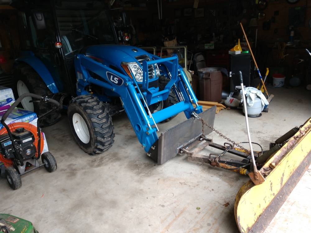

My 86'' dozer blade is not too far up front from the pins of FEL, so I do not get pushed sideways quite as bad as some that stick out further. But for this reason I also keep chains on front.
   / FEL plow vs. rear blade for 1 mile of infrequent chipseal road snow removal #8

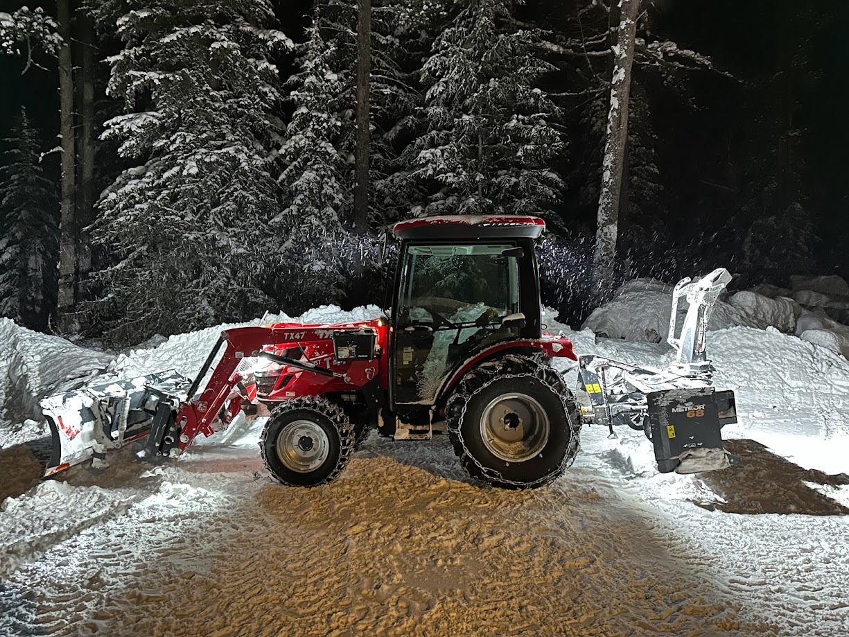

I was reluctant to put a front blade on the loader of my JD 1025R, but it has worked out well. My previous JD 650 loader would not have tolerated it, but the 1025R loader seems much more stiff. I suggest looking to see if the original FEL manufacturer offers a blade for the FEL, that way you'll have an idea what they are thinking about doing that.
Blade on the front, and blower on the three point works perfectly. Blowers are not so desirable on the rear of standard transmission tractors (poor choice in blowing speeds) but with hydrostat they're fine. I plow a windrow, then blow it. The plow run is quick, the blower run is slower, but cleans up very well.
