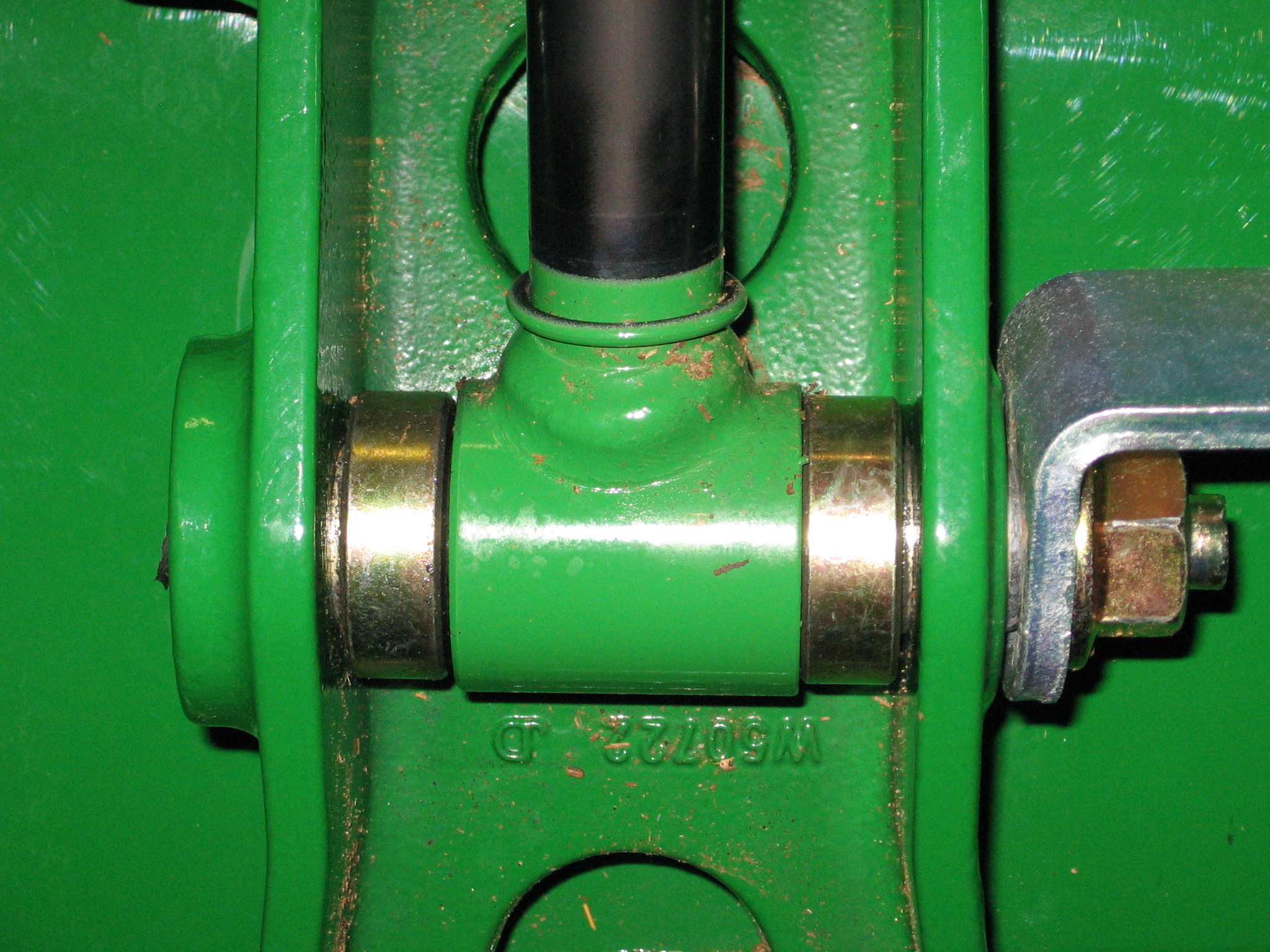

Hi guys
Is the level indicator supposed to be tight against the bucket mount or loose?
I was cleaning debris around the linkage and noticed I could wiggle it back and forth a little. The nut looked loose,but it is tight to turn with a wrench.

It's fine, it needs to pivot. But it looks dry-grease that thing!
BTW, you can cut that O-ring off the cylinder-it's function was to keep paint off of the wiper seal at the factory.

Thank you Kenny sir:)
I will get right on that grease detail

BTW, you can cut that O-ring off the cylinder-it's function was to keep paint off off the wiper seal at the factory.[/QUOTE]
Thank you for this 'Tid-Bit' of info, I have ask most everyone that has looked at my 4520 what it was for and thus far no one has known......Thought that it might have come out of the cylinder, one less thing to worry about.
