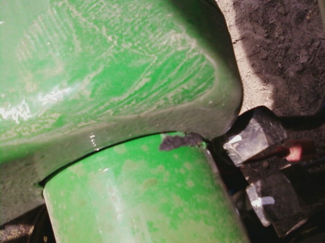

Thought this subject could use a thread of its own.
Several Deere owners have learned that their dealers bolted the FEL mounts on the wrong sides, resulting in FEL's that come off or just raise a bit off the mounts when FEL is being used.
Apparently Deere doesn't mark the mounts right and left (or for some setup guys they maybe should be different colors :D). Setup without regard to the correct position can lead to a dangerous result, and for some they have had busted windows in the canopy.

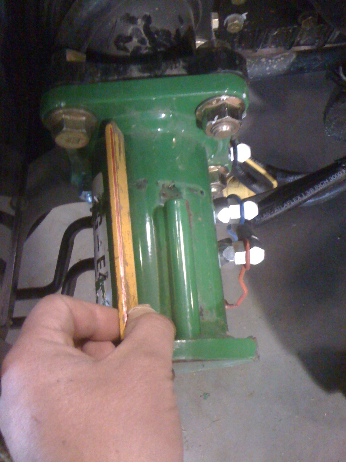

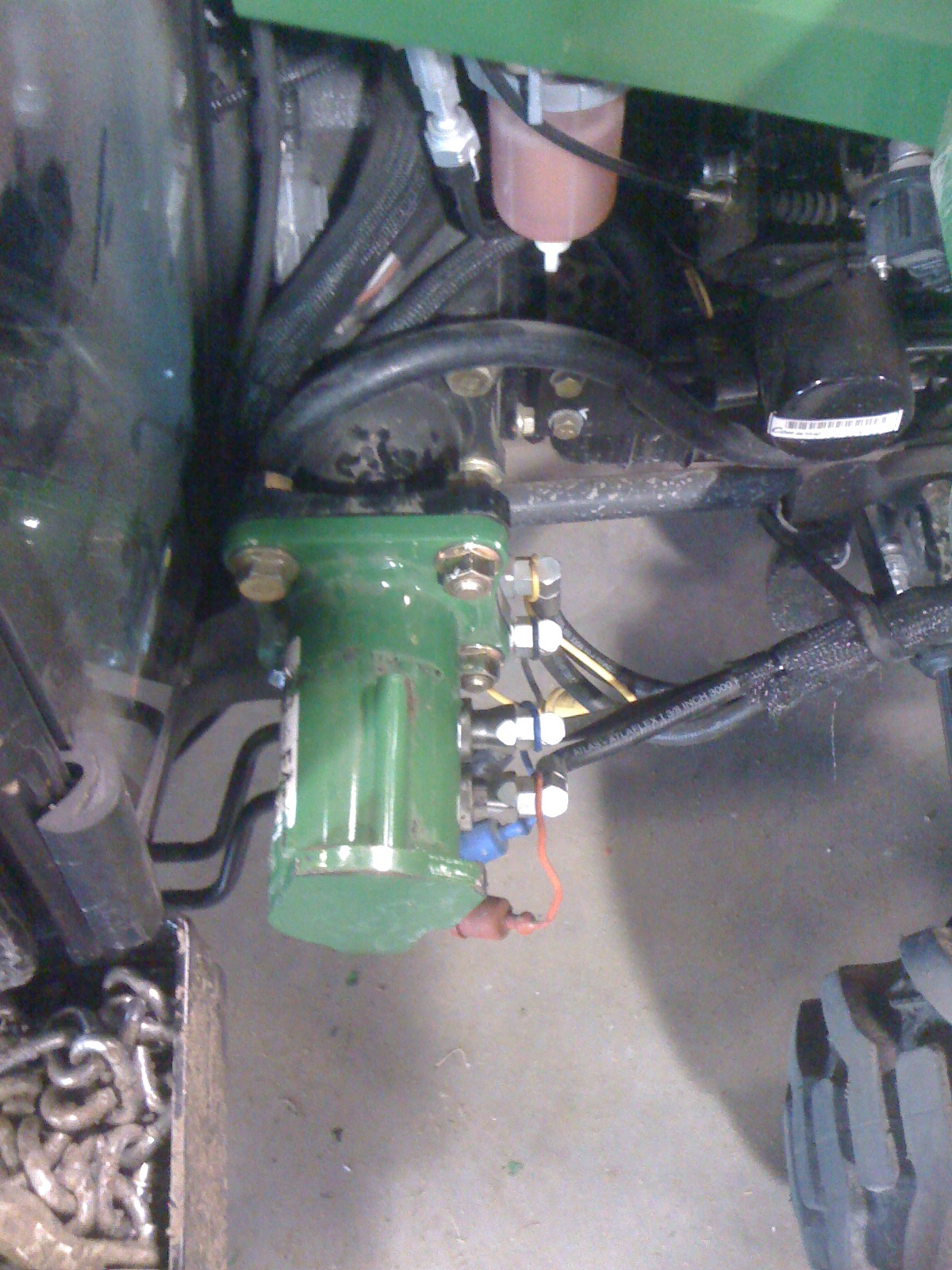

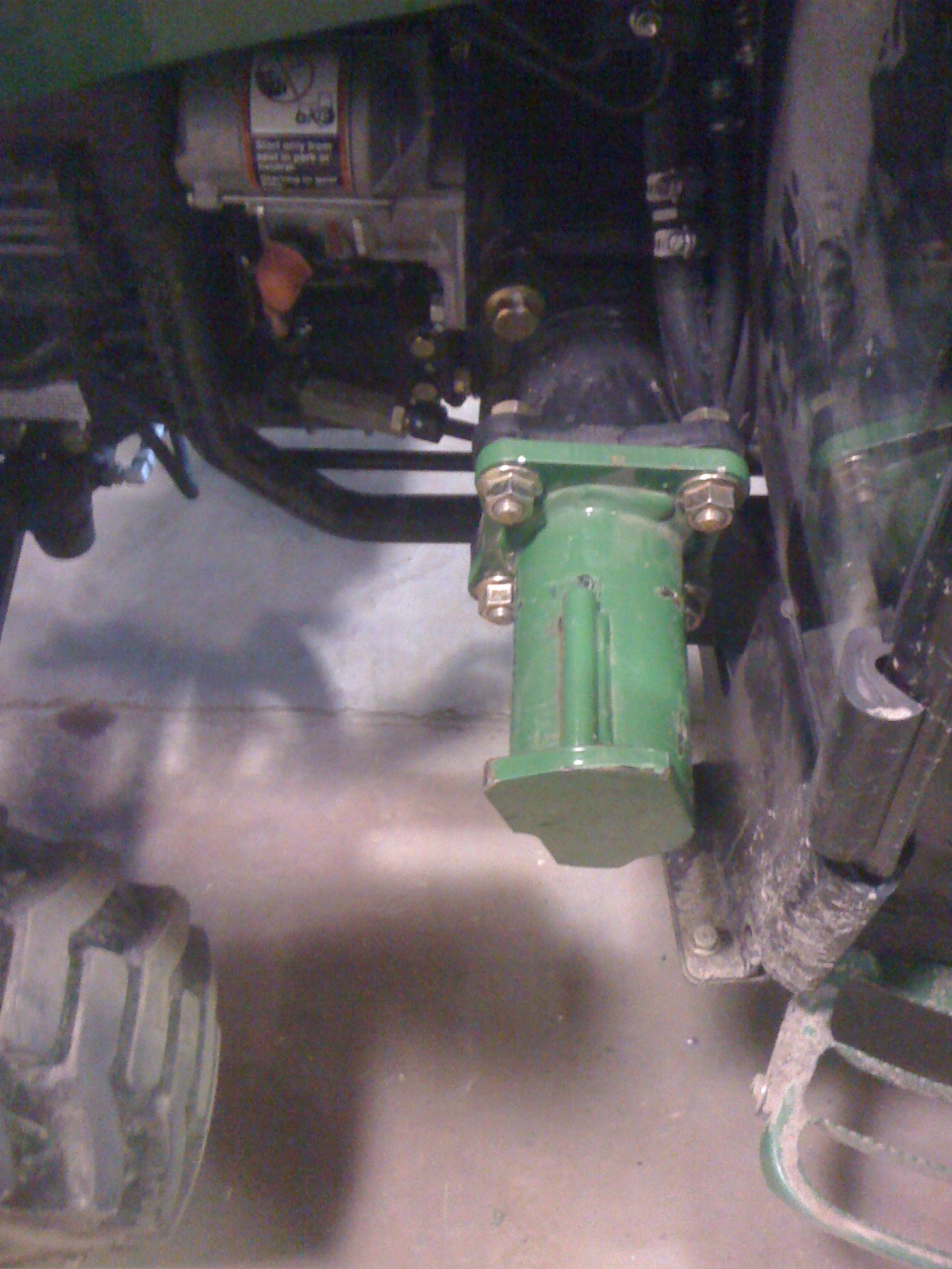

Wish I would have taken the camera to the shop and got pics as JD was just here fixing mine. But regardless the rod on the mounts have to face UP and toward the FRONT of the tractor for the loader masts to lock onto properly.
Edit.... Ok got some pics of the PROPER way to install the mounts. Last pic with the pencil gives you an idea of where the rod would be located if the mounts are on backwards.

/ FEL mounts wrong? #4

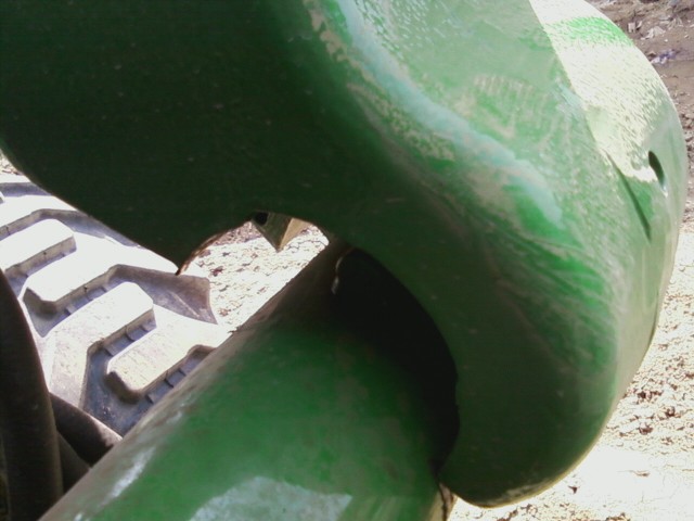

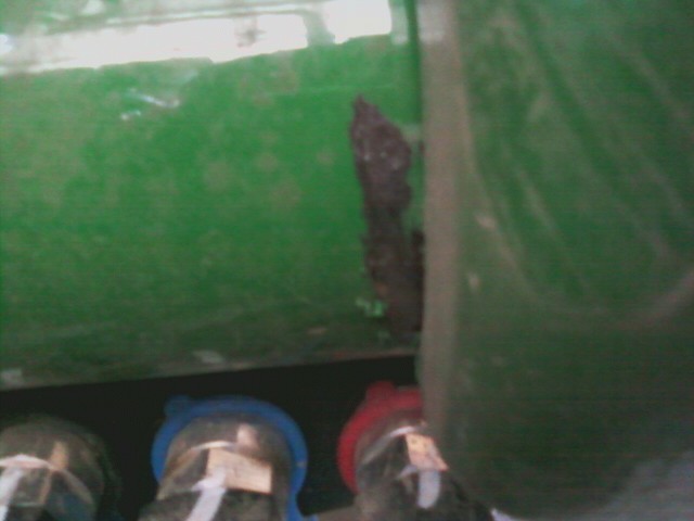

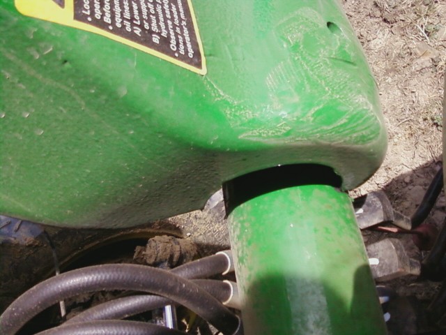

Here are some phone pics I took the day it happened. You can see how it was digging into the mounts when it was lifting. You can also see how high it was lifting up. In the last photo if you look close you can see the the rod is facing aft. They are picking up my machine tomorrow.

/ FEL mounts wrong? #5
Yep, the bump is towards the front of the unit, and the slot on the side of the mount is also towards the front
