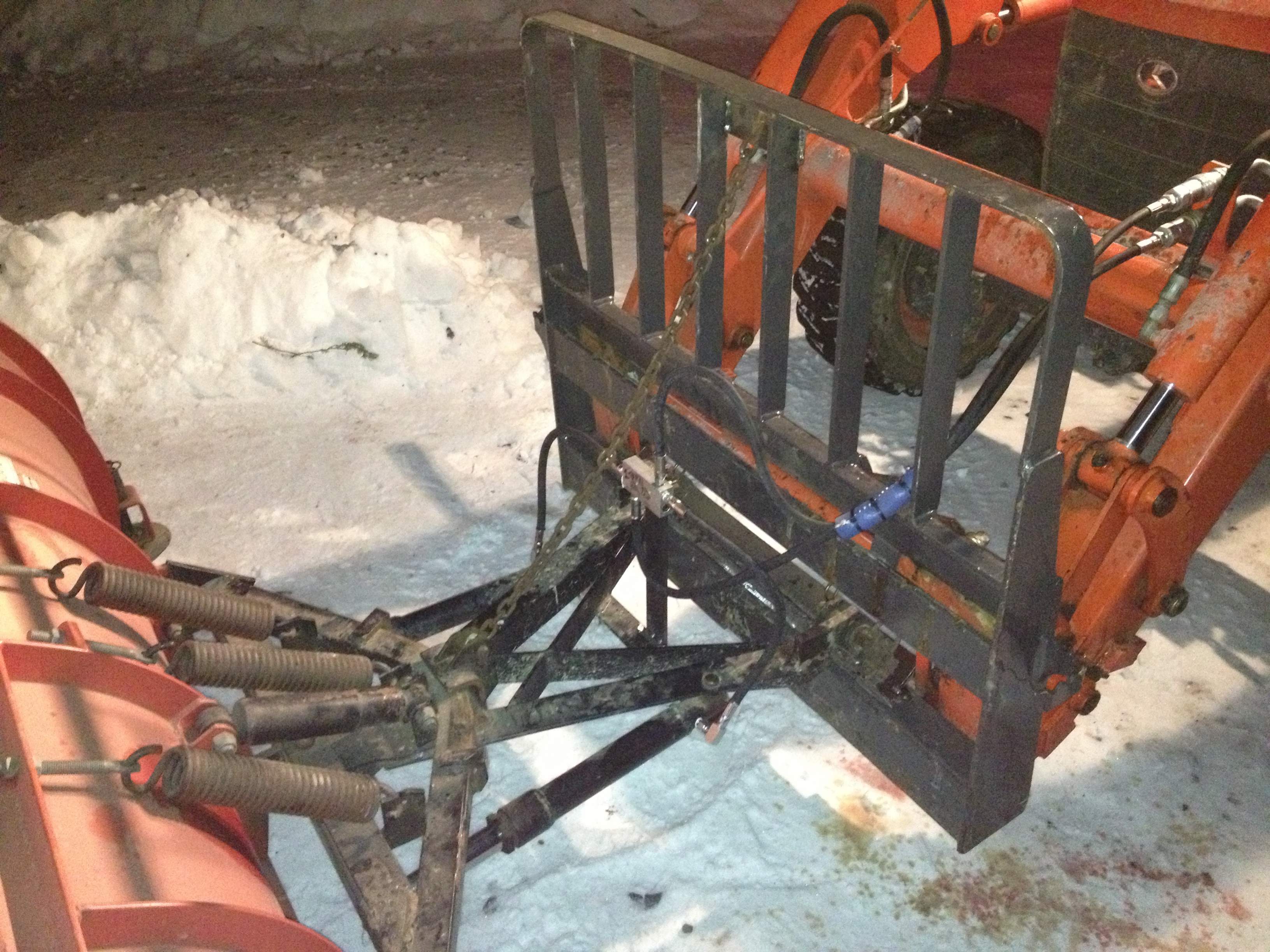

I like the pics!! I'm connecting a western plow to my front auxiliary hydraulics. Besides adapting the lines did u need a diverted or solenoid to run the power angle... Because I see you have them connect to the front ports like I want to do. Thanks!
/ FEL mounted snow blade #11
bravo5:
I did nothing. It works fine. One line to each cylinder.
David Pidgeon
New Haven, Vermont
/ FEL mounted snow blade #12
Ok thanks! Ill keep ya posted n the status. Merry Xmas
/ FEL mounted snow blade #13
Everything went well. I converted my forks to also accept the plow set up. One less attachment I have to store. image.jpg
