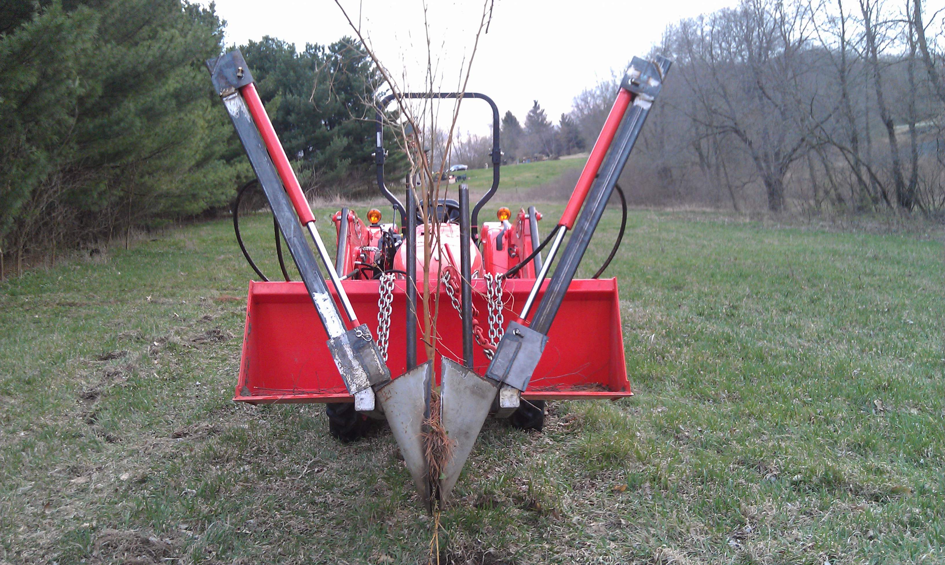

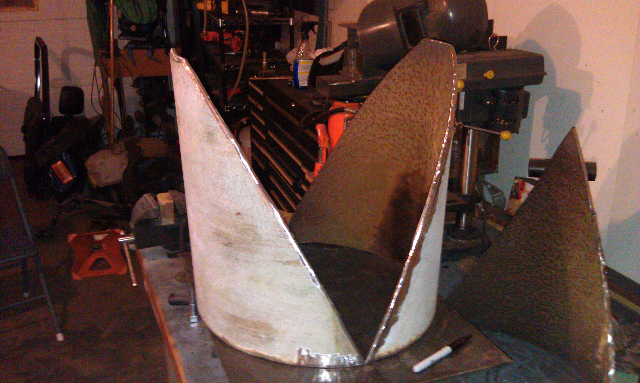

Finally making some progress. Here's the spades.

   / FEL mounted hydraulic tree spade #3
DO you have ASH trees in your area? The reason I am asking is Ohio is going to be so full of dead ash trees that one would not need to plant additional trees for firewood. Ash borer in 88 counties. Only reason I cold think of would be the additional curviture requiring more force going into the ground? Call Vermeer and ask one of their engineers.

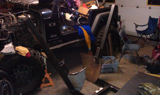

Haven't had a lot of time to work on it but the frame is almost done. Here's a picture with the spades laying on the guides.

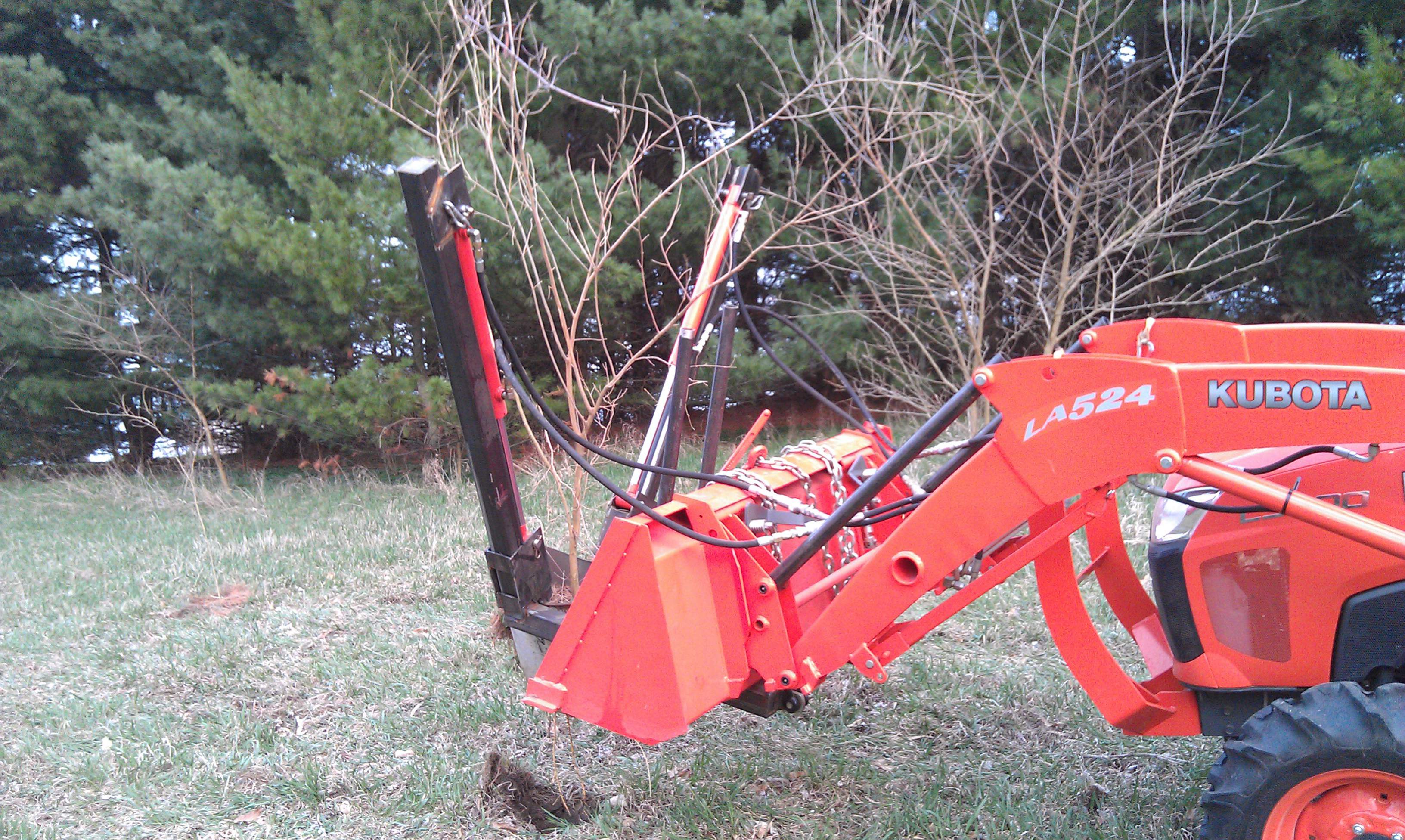

I'm deployed, so no progress lately. It works but needs larger cylinders. It also needs an anchor to hold the frame down while pushing the spades in. There are two upright pipes in the picture that capture a hydraulic motor. The motor drives and retracts an earth screw anchor to hold the frame down. It worked but needs improvement. I am going to replace the shaft of the earth anchor with an acme threaded rod to positively control the raising and lowering of the anchor.

Add weight to the bucket to help hold it down?
Looks great. Simple and ingenius.
I think that would work for a larger tractor. This one already has stability issues on my hill side.
