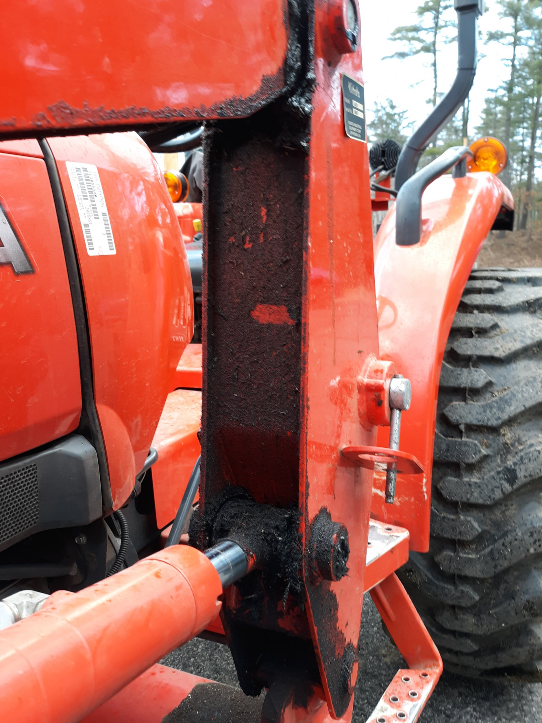

OMG, the OCD in me is having a heart attack LOL. Do you keep 4 feet away from the tractor? I seem to get grease on me by just looking at mine from afar!
   / FEL lubrication - has to be a better way #72

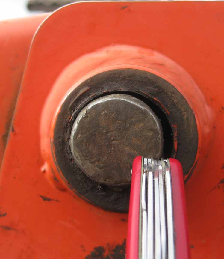

I used a pressure washer a few years back and cleaned all excess grease cause I was tired of it dripping on driveway, getting on the dog, on my clothes, etc.
i went as far as disassembling all the pivot points and cleaning them. Then just minor regressing.
   / FEL lubrication - has to be a better way #74
How to do clean the grease? Do you remove the excess grease after greasing or later on? If later on, how do you scrape it off? My new to me tractor had loads of old grease in the zerks and over the joints. I'm currently using a flat head screw driver that I gently rubs against the joints and twist around the recessed zerks to get as much grease as possible. I avoid using degreaser there because well, it's a degreaser and I don't want any to seep in the joints so I simply rub a cloths around the joints to remove as much old grease as possible.
I use disposable wooden chopsticks to clean out old grease and packed dirt around the zerks.

Like I said, quit greasing it entirely and when the pivot pins lock up, pound them out and replace with new ones. Issue solved. Some of my implements have dozens of grease fittings, they all get greased quite often. Grease is cheap, replacing worn components from lack of lubrication usually isn't so cheap.
I learned the hard way that the bosses and bores the pins fit into will wear just as fast as the pins. If the bores aren't lined with a bushing, you'll need to re-bore them and sleeve them to accept the factory pins, or turn custom pins. Now I go by the factory manual and regrease the FEL pivots every 10 hours of operation.
What I want to know is what's the best grease to use in the pivots. Kubota calls out NLGI-2, but there seem to be lots of different kinds available.
