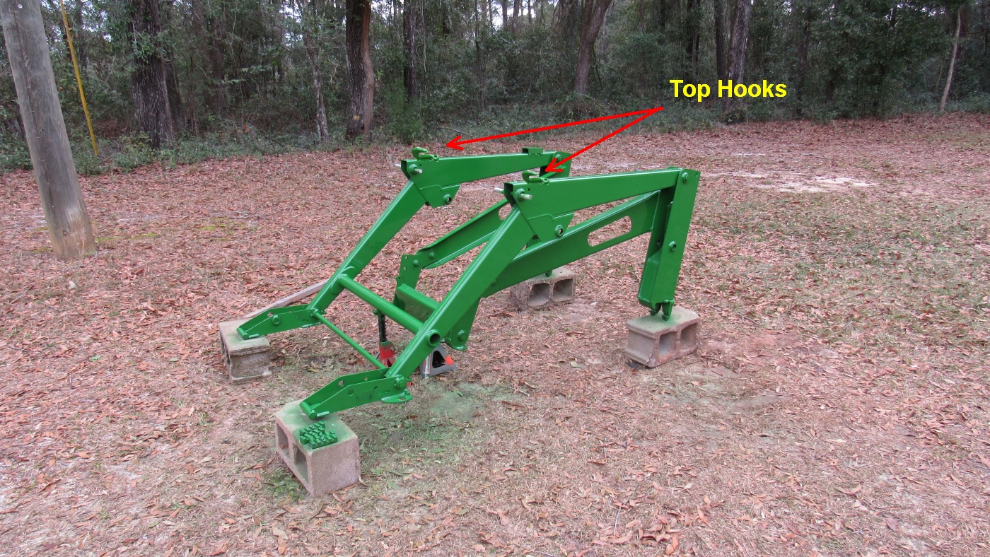

Those are good ideas for stabilizing a platform. The chain binders may make it adjustable to a degree. Might could weld some hooks on top of the loader arms to attach the chains to.
Photo creation loosely showing the possible location of top hooks. Any time I need to weld hooks on I buy the 3/8" forged hooks from Harbor Freight and cut the bottom legs off.

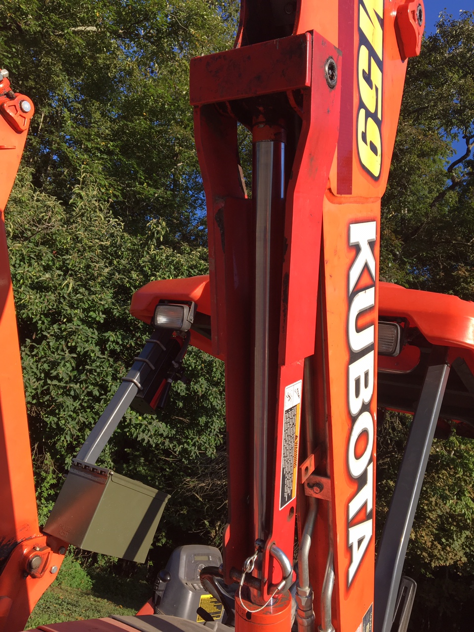

P.S. What I like about the clamp-on "donut" stops is that they are adjustable. I've used them with a 4'x8' lift platform on the loader for house painting and found them very useful. Forgot to remove them a couple times and the hydraulic downforce simply slides them to the end of the stroke. They never moved, however, from the weight alone. I got the idea from seeing a mechanic using split clamps in a bench vise to hold a cylinder rod from turning when removing a piston nut. The trick is to have the bore of the clamps just a hair smaller than the diameter of the piston rod. (Well, maybe half a hair. :)
I like the idea of load binders to keep the bucket from settling by the way. I used a couple pieces of 2"x2" lumber clamped to the front of the aerial platform as vertical struts to do that but it was kind of a pain to adjust them each time I changed working height.
Edit: Here is a pic of one of the locks: Not pretty but they work.
