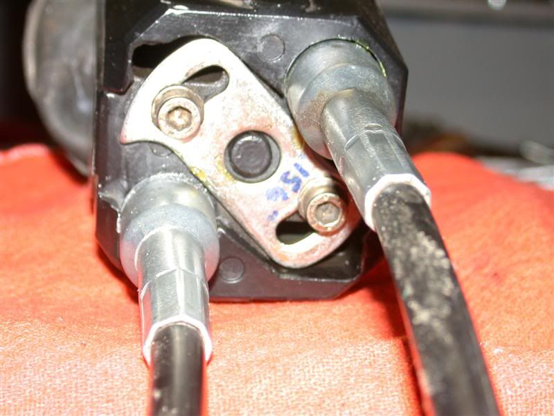

To re-install the cables into the Cofle joystick housing, there are grooves on the outer sheath ferrule.
There is a "keeper" bracket on the bottom of the housing that pivots to catch those grooves. The photos below show that pivoting bracket in the open and closed position. Then tighten the cap screws to keep the bracket engaged.
The joystick has those trunnion or toggle shafts.
In order to get the cables on those, you need to loosen the cable at the valve end. That will give you some slack to to get the cable ends onto the trunnions and into the housing.

Once the cable is off the valve, there will be some slack on the other end...the joystick end.
Now you can put the second (repaired end) onto the trunnion toggle. On this Cofle joystic, there is one flat head socket screw that holds the second trunnion toggle in place. Once that is tightened, the joystick toggles are secured into the housing. Pictures below show the joystick inside the housing and also the entire thing mounted back onto the fender.
That's all there is to it.
Except you do have to crawl back underneath to adjust the play out of the joystick and re-fasten all the components. I adjusted mine so that there is less play than before. I tried out the FEL in all functions and it worked just fine. I don't anticipate breaking off that new stainless steel end anymore. But I have a second end cap ready for when the other plastic piece fails.:)
