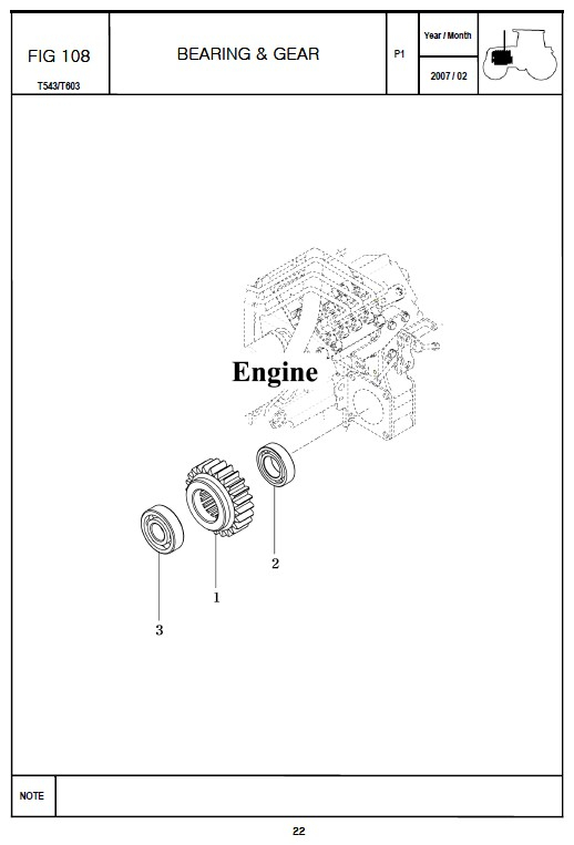

@ptsg
I have the service manual for the TYM T603. I have found no mention of this 3024CT PTO gear as the manual doesn't really cover the engine internals, etc.
I have a parts manual for the TYM T603. I have found a picture of the gear and bearing however I'm not seeing any part #s for these items (or for any items in this parts manual... I usually have to use the pictures & numbers and give this to my dealer for them to figure out the part #s). Also, the drawing is not really correct regarding the gear itself (screengrab attached).
Where/what method did you use to find the TYM part # for the gear?
The link you gave does seem to visually be the correct parts except the drawing doesn't do a very good job of showing the teeth on the gear. The drawing shows teeth perpindicular to the gear and the real gear has teeth that are slightly at an angle to the gear face (not sure what the angle is).
Thanks again.

@ptsg
Thanks again.
That parts catalogue for that tractor seems that it was put together in completely crazy way. They show the parts diagram for the engine in the beginning but then you have to scroll all the way down to get the list of what is what.
Basically, you take note of that number on the upper left corner of the image shared, which is FIG 108. Then scroll all the way down on the parts catalogue and look for the Fig 108 on that list. By then you can see the actual parts list that should be under the page you showed in the first place.
Hopefully it made some sort of sense. By the way, they call it: "Gear, pump"

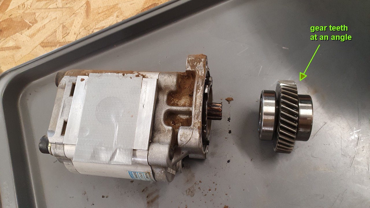

Thank you very much for that explanation on the parts numbers/list!
Attached is an image showing the gear teeth angle.
Thanks again.
Thanks again.
No worries.
Too bad they didn't add a picture of the gear on the website. That would clarify the teeth situation. On the other hand, the drawing on the website may not be accurate even though it should.
   / FEL Hydraulics Just Died #66
The gear teeth at an angle are called helical gears.
There isnt too many gears on anything that are straight cut anymore. Straight cut gears are noisy.
Ever drive a manual trans car? Reverse is usually a straight cut gear due to the sliding engagement method. Notice how you hear gear whine when in reverse but not any of the forward gears.....thats because forward gears are helical cut.

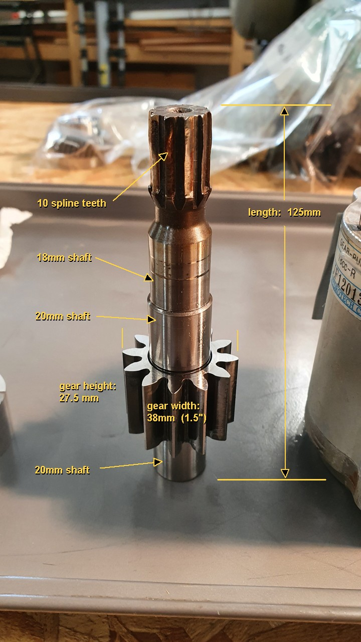

An update...
I've ordered various parts and we'll see when I get them and if they are correct. (Who knows how long this is gonna take). Drive gear from CAT, pumps from TYM, bearings, seals, etc.
I've taken apart the main pump and all looks good except the worn splines on the main gear shaft. If I had a new main gear shaft with good splines, I could reassemble and the pump would probably work fine. I've reached out to several machinists in my area but none want to/can do the job.
Attached is an image of the main gear shaft.
Now I'm in wait mode.
Thanks again.

Mike T
Typically the gears in pump are replaced in pairs since they wear in. If you replace just one gear it may wear in or wear out both gears.
