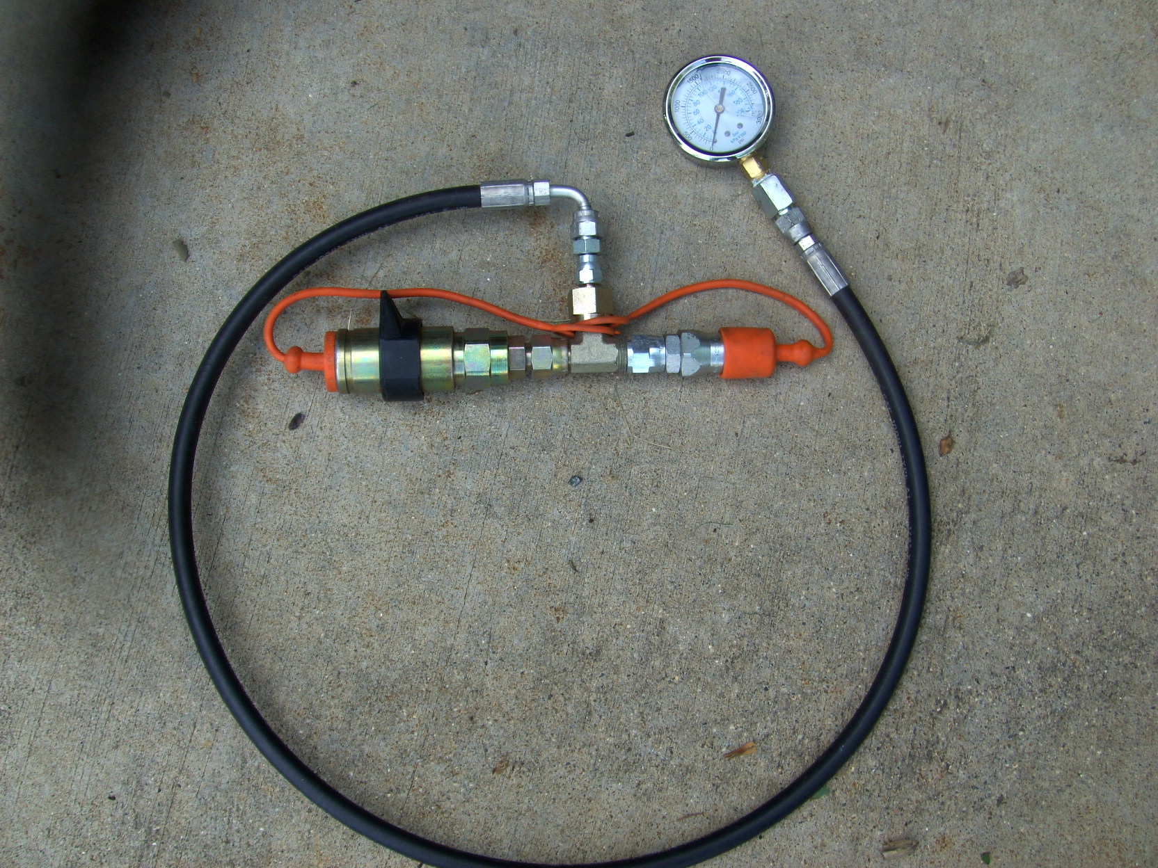

Another question, for J J or anyone else that has a 3000 PSI pressue tester. When I picked up the new hydraulic filter at the local CAT dealership I asked about buying a pressure tester as well and they had no idea what I was talking about. Mind you, this was the Part department guy, not a tech.
Is a pressure tester something that you can buy off the shelf, or do you have to buy a 3000 or 3500 PSI guage with the little straight end (like this ) , and then also buy a bunch of various fittings that would allow you to connect it to different places in your system? For example a bunch of 1/2 inch fittings to try it at the loader, some smaller ones to try it where the steel tube comes out of the pump, quick connects to test where there is a QC point, etc? Even though I did not use it this time, I can see that it would be useful for narrowing down any future problems, but I don't know where to get one or how to build one. If anyone has a picture of theirs, that would help too. Thanks! :thumbsup:

You can buy them, but it is better to build them for about $30
Round up the parts and put it together.
3000 PSI 2.5" LF LM GAUGE

Ok, i see. I thought it would require a T joint of some kind so that the fluid could still flow through, but only one of those is a T and the other two are just a single end connector, presumably so that you can test pressure at something like the output of a pump or something I guess. I will have to look around on youtube etc and see if I can find some tutorials on hydraulic mechanics.

One test rig does the tee thing.
You can eave the tee rig in place, but the plug in gage is only used intermittently for a quick check as the valve is probably in relief.
