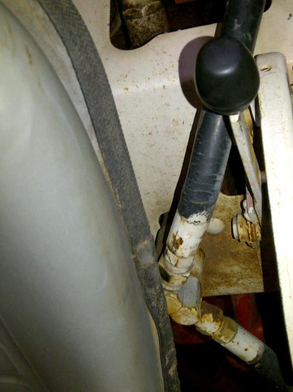

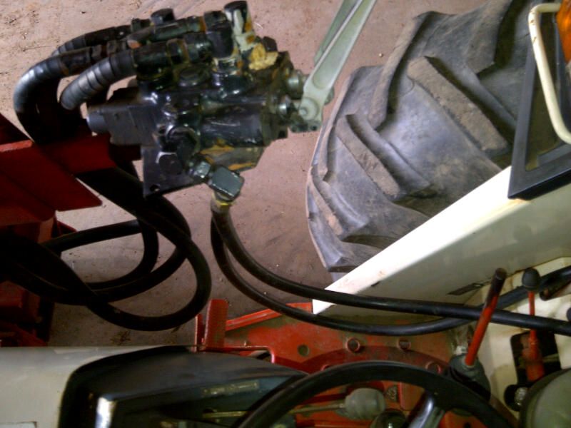

I did some looking at the hydraulics. Up front I have a hydraulic pump that is belt driven off the same belt as the alternator runs on.
Fluid supply comes from the center bottom of tractor and enters pump on the right hand side.
Fluid exits on pump's left and heads to rear of tractor. Splits about halfway back and goes under the axle on both sides of the tractor.
The left rear lines feed my rear hydraulics, which I have never used. The right rear lines go to the area that my loader supply hoses come from, but I can't see much because it is all covered by a casing. They also feed this big canister, which I guess is my hydraulic filter. Can anyone confirm this is the hyd filter? Is servicing it just a matter of undoing the screw at the bottom and then change a paper filter?

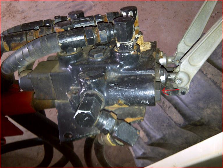

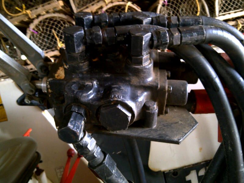

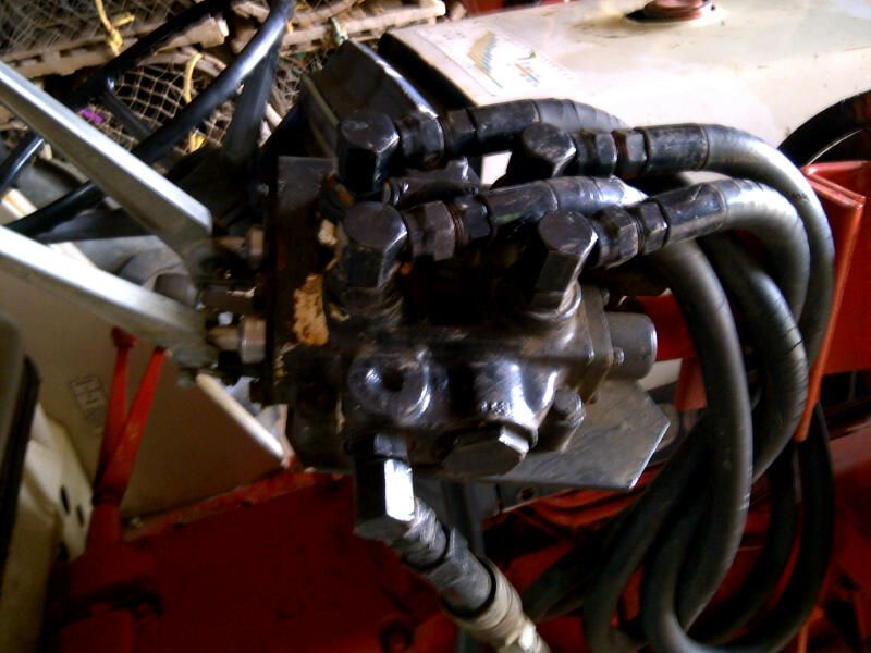

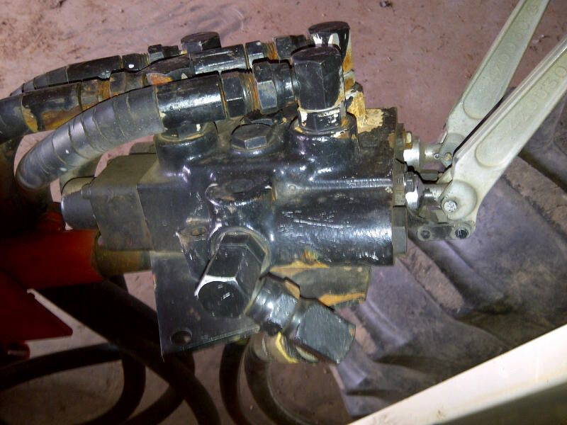

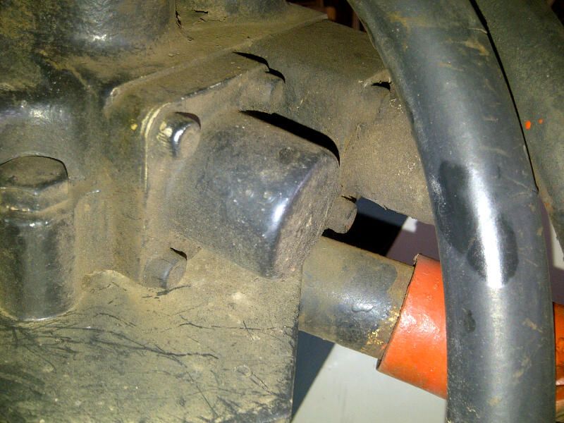

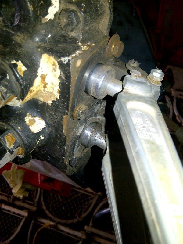

I also spent some time with the loader valve. Couldn't do much with the hoses connected because they were in the way so I started with removing the 4 hoses that go to the FEL cylinders. Holy Hannah, they were tight! Could not move them until I used a pair of 3 foot cheaters to get some extra leverage. I felt like the janitor on the last day of school with those giant bolt cutters removing all of the locks left on the lockers.
The first thing I tried was the relief. It came out easy. The o-rings looked fine, but other than that I had no idea what I should be looking for. It is just a post the goes into a hole. Nothing noteable about it or the hole. Is there something that I should be looking for there?
Next was the spring assembly and valve body. The spring assemblies were both loaded with crud, but that was separate from the internal workings of the valve and the action of the levers were both fine even with the crud in the spring. I don't have a clean workspace in my equipment shed, so I left it as it is and will probably take the whole valve to the city and clean those up where I have a suitable work area.
The valve internals seemed clean and the o-rings were fine. I pulled both shafts out, and inspected them and their housing and saw nothing that looked bad. I don't know what I should be looking for though, so it is entirely possible that there was something that I missed. Anything in particular that I should look for when I pull this apart the next time?
My next step was going to be the load check valves, but they were painted on and did not move with a regular socket. Before I had an opportunity to put any effort into removing them, the kids came down looking for me to start the BBQ and get them some supper. I reconnected the 4 loader hoses and started the tractor, no leaks. Tested the loader and bucket and still absolutely nothing happened for up or down on loader ams or bucket. :(
Next step I guesws is to get that hyd filter cleaned or replaced, and try to get a look at the load check valves. I may also look into a 3000 PSI test guage the next time I am in the city, if they can be purchased or rented for a reasonable price.
Any suggestions or advice gladly accepted if there is something else I should be doing or looking for. Thanks for your help up to this point. :)

Don't worry about the load checks, a failure there would NOT cause complete loss of function. A load check could be completely removed and loader would still go up & down. They are there to hold the load if you lift part way stop then try lift some more, then the pressure on the cylinder with load on it keeps the load check closed until pressure on the pump side builds to same or greater before the check opens to let fluid into the work port. This keeps the loader from dropping when you first move the lever.
That relief valve plug is just a stem block, there is another relief somewhere between pump and the control valve. Only inspection of the plug/stem is to see if the slightly tapered end is fitting tight to the seat in the valve and the smaller O-ring is not torn or pitted.
It's not real clear in the pictures; I see 2 steel lines coming off 1 side of the pump, is there another line on the opposite side of the pump. If so the 2 lines on the same side would be 2 outlets, meaning it is a tandem (2 section) pump. Quite possibly 1 section for 3 pt. the other for loader and/or rear remote since you mentioned a "switch" or lever close to where the loader valve lines come out of the tractor.

I suspect the front belt driven pump is for your power steering.
Yes that appears to be the filter housing. Unscrewing the bowl will provide access to the filter element.
Rear two section pump: pretty rare for one section to totally fail and the other still work fine especially when from your piping description the front pump feeds the FEL & the rear feeds the 3PH.
Without having some schematic or circuit diagram my best guess would be that there is a valve somewhere diverting the flow away from the FEL valve. I seriously doubt a relief valve since from the initial failure the loader raised part way. Then when you went to move it again nothing happened. I see no reason the FEL would cause this failure but again without knowing the circuit I am only guessing.
