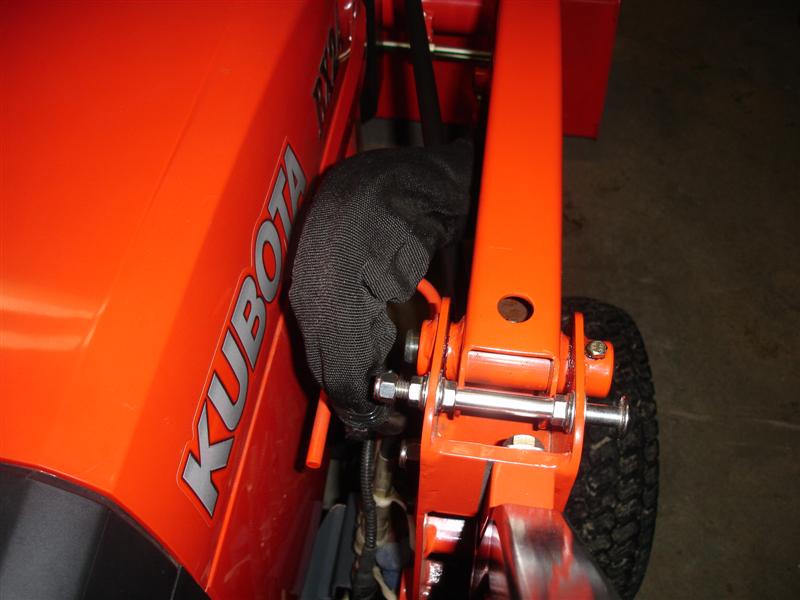

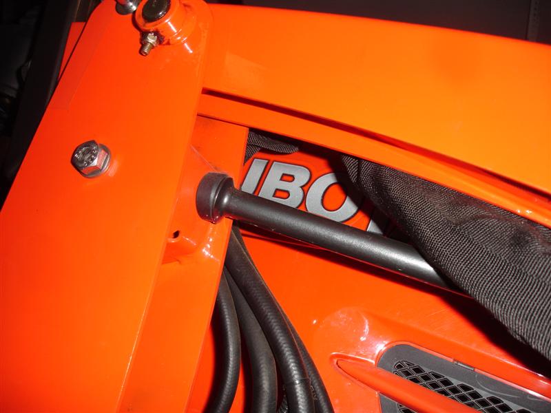

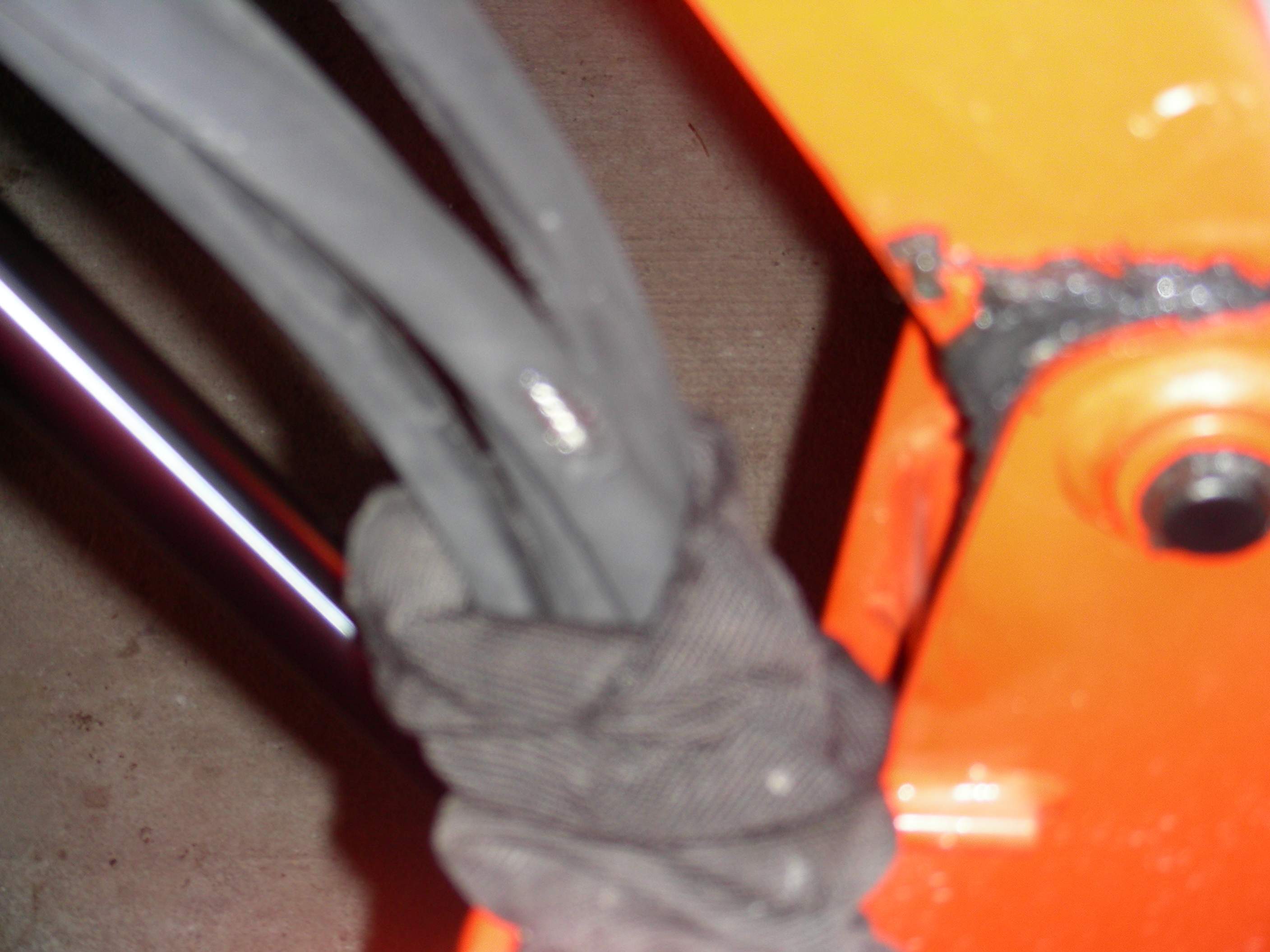

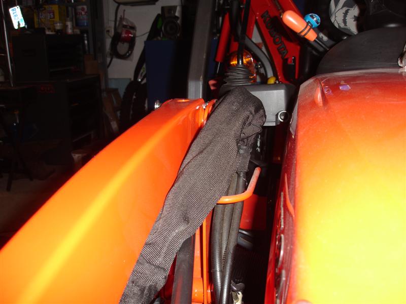

/ FEL Hoses wearing spot ?
Picture one is when bucket is down and how BX2660 hoses are squeezed into an S against the underside arm of FEL.
Picture 2 shows nylon sleeve pulled back and hole wearing in Blue tagged hose .
Picture 3 shows when FEL fully extended and so Hoses at their full stretch. But here I have done my best to tape up hose temporarily and pull nylon bag full up so a new section of nylon protect bag is taking the wear while I get a price on a new hose.
So what do you think is this poor design ? , , I can't see how hoses can be much shorter, its almost like the steel rod bracket that helps hold the S shape of hoses is in wrong place.
your thoughts , and is hose sure to fail ?

/ FEL Hoses wearing spot ? #9
In the first picture, the hoses are under the loader boom as you mentioned. They should be inside, toward the tractor, not under the boom. It might be as simple as twisting a few hose fittings to get them in the correct position. Check the steel tubes to see if they can be pulled over to point the hoses toward the inside. Everything else appears OK.
Never heard of this problem before. Has it always been that way?
Yes it will fail!!!!!!!!!!!!!!!!!!!!
And if they tell you it will not, tell them a mechanic that worked only on hydraulics for 22 years told you so!!!!!!!!!!!!!!!!! and you want loom clamps to secure the properly measured length hoses installed (with the proper extra hose length) to replace the snake cluster they made and installed on the cheap as well as installing and having the four individual hose protectors.
Well the Cheap %#$%^&*()*&^%$#$%^&*() used one hose protector
instead of four individual hose protectors as well as not using the proper
hose routing and loom clamps to secure the needed longer hoses on the boom
I will prove this with no hesitation!

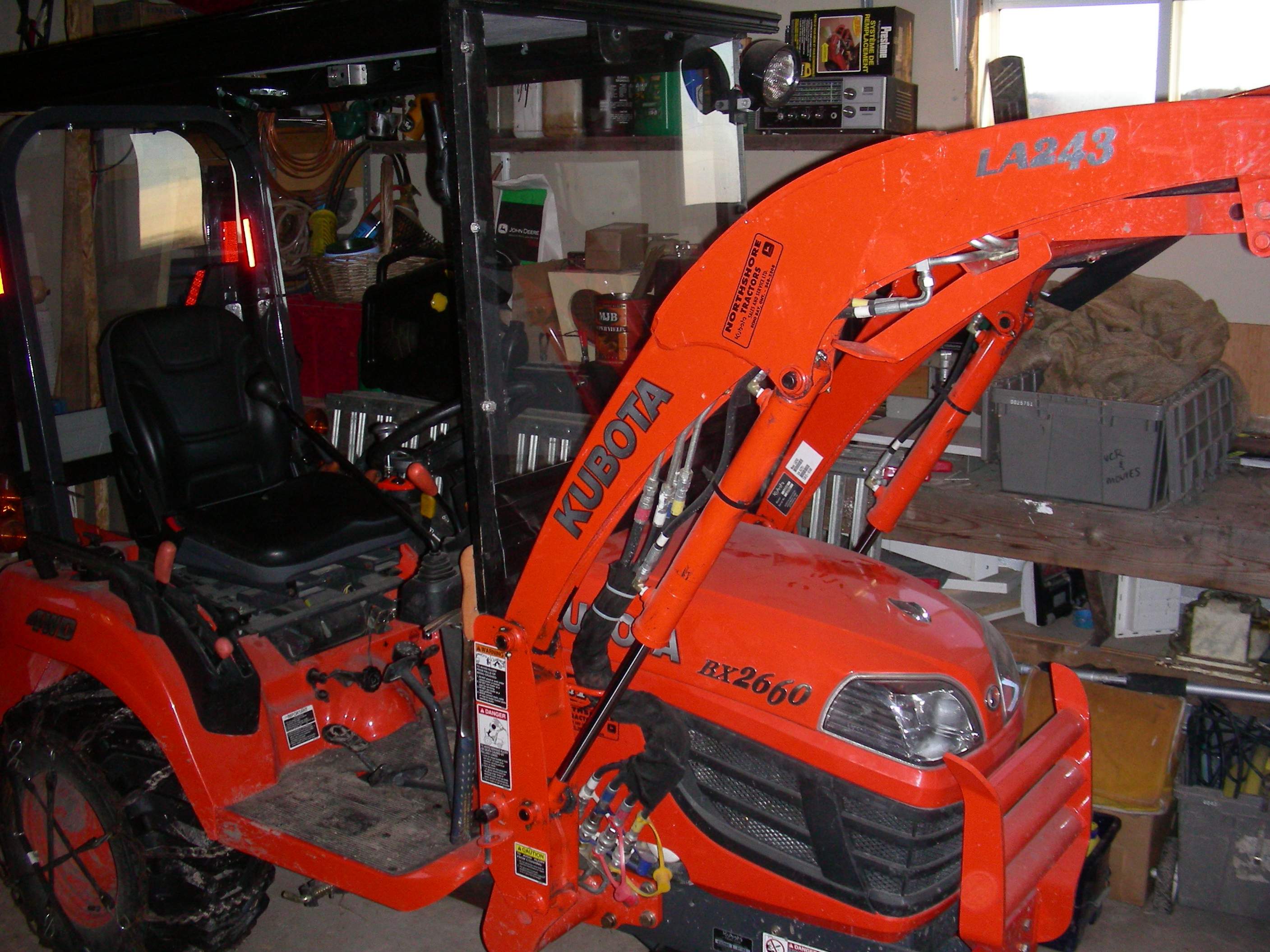

/ FEL Hoses wearing spot ? #12
It is how they installed the loader.
My BX2660 has over 250 hours on it and not even a scratch on the hoses.
Here are pictures of my BX2660 showing how the hoses should be routed.
And NO, that is not hydro fluid on the floor. It is snow melt.
Click on photo to enlarge.

OMG! your hoses are a wee bit too short and needs to be angled towards the hood more. Mine looks just like usta. I have NO wear whatsoever . Yours shows very excessive wear due to hoes being "pinched" under the top arm of the FEL. STOP USING the FEL. Call up your dealer and see if this can be covered by defect warranty due to hoes being too short. It needs to be longer so it can be forced up in a loop and be outside of the arms. If the hoses are correct length, then the bracket that holds the connections on the tractor on railing could be bent.
#18
Thanks everyone , especcially LeonZ for reinforcing the unsafe condition of this and others for their advice and pictures.
I have printed some pictures off showing what it should look like versus what my hose routing looks like and I will bring it to the dealer and see what options I have after their input.

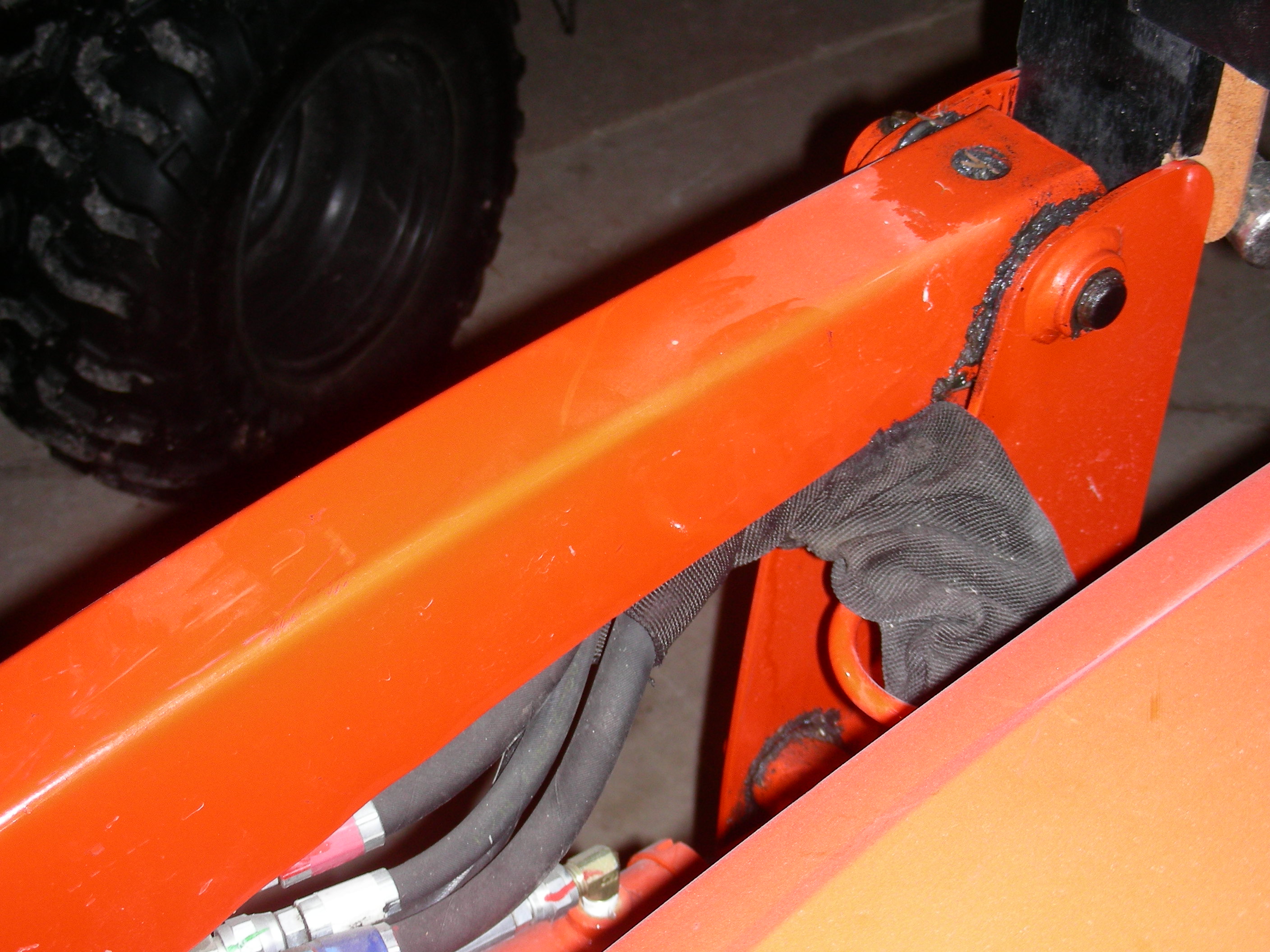

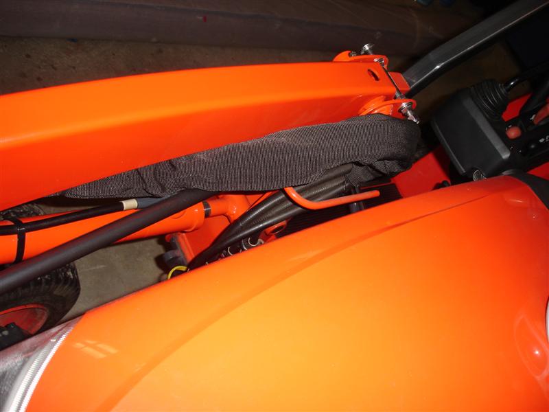

/ FEL Hoses wearing spot ? #20
LEONZ, remember to take your medication before you post next time, either that or time to switch to decalf . . .
Here is the routing for a BX24 which should be similar to the 26. Your hose should not be tucked up under the arm in that fashion, it should lay against the side of it.
